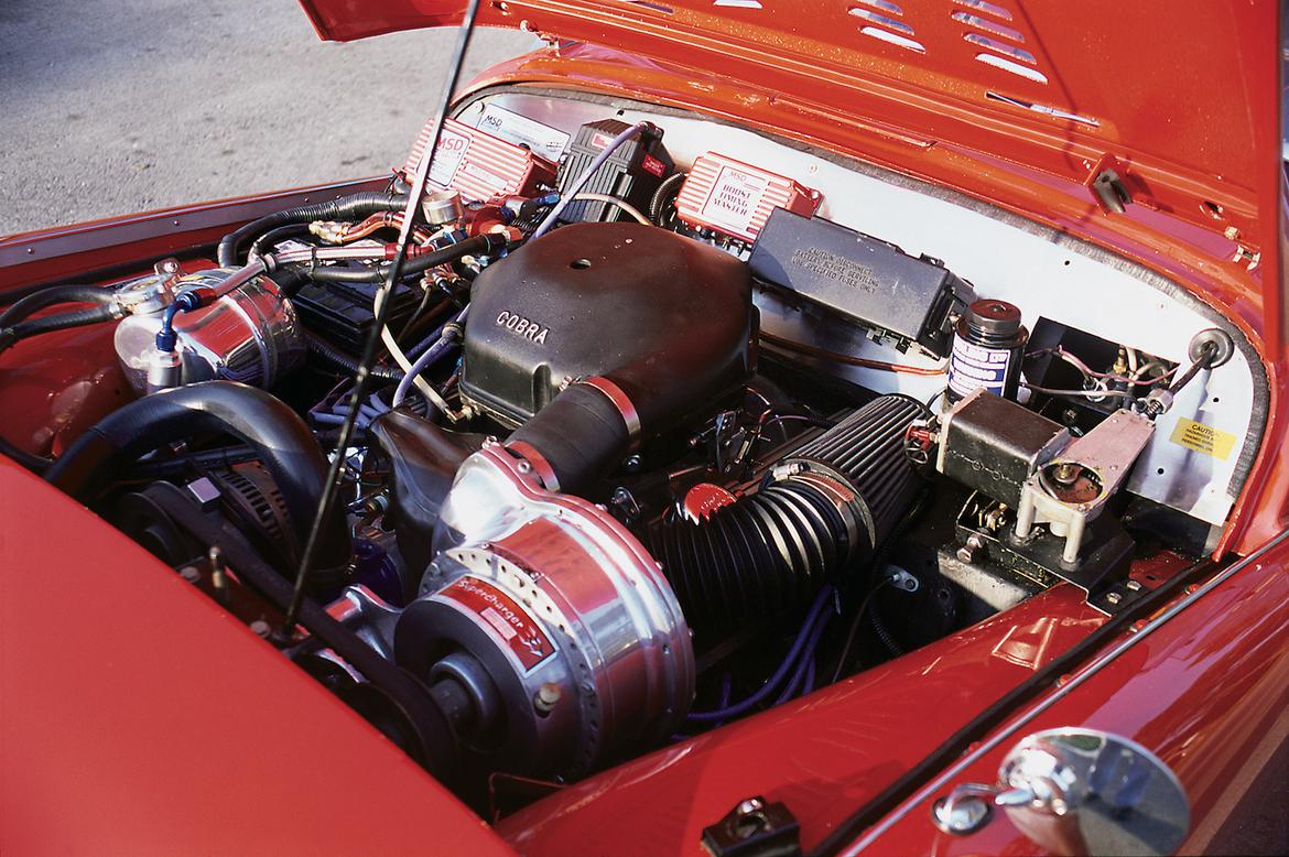

While working in a rented bay, Bill completely disassembled the car and started tinkering, keeping in mind that it was going to be powered by Ford. “There were about six of us Triumph guys who had bays side by side, and we worked every Saturday,” he recalls. “I had a lot of technical support from the Central Florida Triumph Register folks, and I talked to my dad a lot on the phone.”
The hardworking team started by reinforcing the frame in key places and fortifying the front suspension with competition shocks, springs and bushings, and a TR7 rack and pinion for quicker steering. The rear springs received an extra leaf and reworked shocks.
Fitting the Ford V8 involved weeks of engineering, head scratching and trial-and-error fittings. To mount the front of the engine, Bill and his cohorts took the plates that mounted the Triumph’s original rubber motor mounts, cut off the top halves, and fabricated stainless-steel torsion bars that they welded to the plates’ bottoms. These longitudinal torsion bars, which now mount parallel to the block on either side, allow the engine to be dropped 7 inches and moved back 13 inches. This location prompted modifications to the firewall, transmission tunnel and footwells. The inner fenders remained intact, however.
Modified, cast-iron exhaust manifolds from a Ford Galaxie 500--space was so tight one of the outlets had to be reversed and re-welded--were squeezed between the frame rails. Up front, a large Ford radiator and oil cooler provided appropriate fluid cooling. The exhaust system features 2.5-inch pipes (with a crossover tube) routed through the reinforced frame.
A modified transmission mount also helps keep all the power traveling in the right direction. This mount--bolted to the frame’s center section--was crafted by machining a split aluminum billet to closely fit over the transmission’s tail shaft assembly, which is isolated from the mount by a thin rubber donut. This arrangement works with the torsion bar engine mounts to control torque loads under hard acceleration, and Bill says the car has virtually no wheel hop.
Bill explains the engine installation this way: “The driveline is on the exact same longitudinal center as the stock setup, but the center of gravity is much lower and moved to the rear. This is helpful in helping to hook up all the horsepower. And since the engine weighs about the same, it didn’t really change the front-end geometry. My dad gets all the credit for engineering this mounting system.”
Bill’s original transplant engine was a 302 that his dad had built from race-prepared parts. It featured a highly modified 289 crank and warmed-up Hi-Po heads with larger valves. The head modifications and combustion chamber configuration boosted the compression ratio to a hefty 13:1.
The transmission was a four-speed Ford top-loader. Surprisingly, Bill retained the Triumph rear end, but with mixed results. “For nearly 20 years,” he says, “I ran a TR3 rear end. It would take all the horsepower you wanted going up through the gears, but if you tried to downshift under a lot of power, it would rip the bolts off the pinion gear.”

The itch to keep adding power never really went away. In 1990, Bill added a Paxton supercharger. A few years later, he upgraded the four-speed transmission to a World-Class Ford SVO five-speed, a move that dramatically improved drivability and reduced cruising rpm.
He says the car has always been fun, fast, and required only the occasional tweak to keep it on the road. Of course, having a couple of spare TR3 donor cars on hand always helps.
A couple of years ago, however, the loss of octane in pump gas—not to mention some 40,000 miles of hard driving--combined to take its toll on the high-compression engine. Eventually, spark detonation led to a piston meltdown.
Undeterred, Bill built and installed another engine, this one a lower-compression 302. This powerplant did not live up to his expectations and produced what Bill called “disappointing” results. “After having something that was just a rocket, this one just didn’t do it for me,” he says.
He called in an expert for the next engine, contacting Allen Foyt at the Ford Shop in Maitland, Florida. Allen had a reputation for building small-block Fords that run well and last.
Bill and Allen put their heads together and came up with a scheme. This plan started with a 1991-vintage 5.0-liter Ford block, stroked from the stock 302 cubic inches up to 347.
Then Bill went one step beyond insane, installing a 100-horsepower nitrous oxide kit. A dashboard switch arms the solenoids, and linkage on the modified 725 cfm Holley carb actuates a microswitch, opening the solenoids when the throttle hits the floor. An MSD box handles the ignition chores, and another MSD box retards timing under boost to reduce detonation. A firewall-mounted fuse box from a Dodge Neon provides reliable circuit protection (compared to Lucas, that is). The car’s wiring has been upgraded throughout with aircraft connectors.

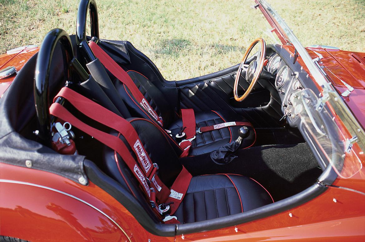

While the car was down for the engine build, Bill took advantage of the opportunity to upgrade several areas, including the roll bar. The new equipment is a six-point affair that significantly stiffens the entire car.
Bill knew from experience that the Triumph differential could not reliably handle the output of the “normal” 302--let alone the increased power and torque of the stroker--so he installed a narrowed, 8.75-inch Mopar Sure-Grip differential from an AAR ’Cuda. Wider rear drums were used, and the racing axles were redrilled to accept the four-bolt Triumph wheel pattern. The final drive ratio is 3.25:1. It’s a fast ship.
