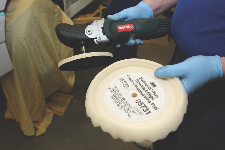

Now it’s time to fire up the power tools. Tim starts the process with a Metabo PE 12-175 rotary buffer fitted with a 3M Perfect-It Plus 05731 compounding pad. His compounding product of choice is Meguiar’s Ultra Cut Compound, and he lightly sprays the pad with some Prima Glide to keep the dust down. Use a microfiber towel to compound the hard-to-reach areas.
