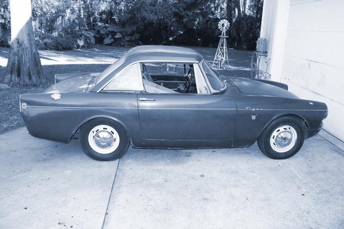

A little while back we stumbled upon a 1965 Sunbeam Tiger that seemed like a good deal. While the seller was willing to part with it, he hadn’t done any preparation for that sale. The car didn’t run, was full of junk, and sat crammed into the corner of a garage. In other words, it was a total mess.
We had found a great deal for ourselves, but there’s something here for all of us: This was a great opportunity to show how much proper preparation matters when selling a car. So we snapped up this Tiger with the express purpose of documenting the process of purchasing, prepping, and selling a car–hopefully for a profit.

The first item on the agenda our new purchase was a wash. We wanted to figure out what we'd actually purchased; under the grime and debris, we discovered a pretty good purchase.
Buyers fear the unknown, so learn the answers about any car you're selling. We asked Tiger expert Joe Chiappetta to help evaluate our Sunbeam; he noted that our floors looked nearly perfect and the exhaust was original.
