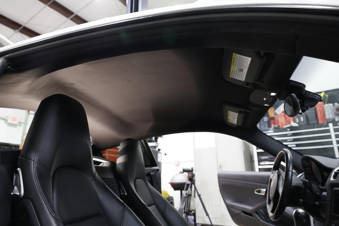

The problem with modern headliners is that after 10 or 20 years, the constant heat and wind–curse you, open windows on a spring day–causes the foam to disintegrate and delaminate itself from the cloth headliner.
The thin cloth loses its support and falls down on your head. Could a little squirt of contact cement reattach the fabric? Without the foam backing, that’s not likely to work. It’s time to rebuild the headliner–but don’t worry, this won’t cost much.

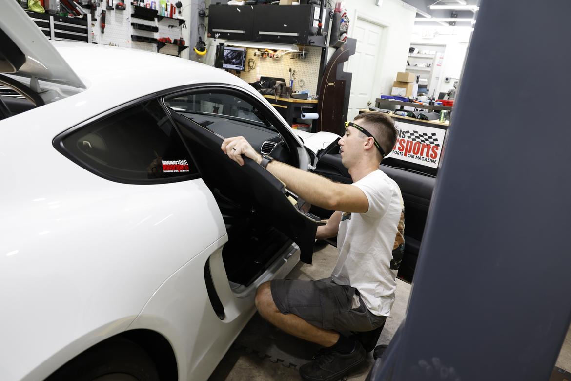

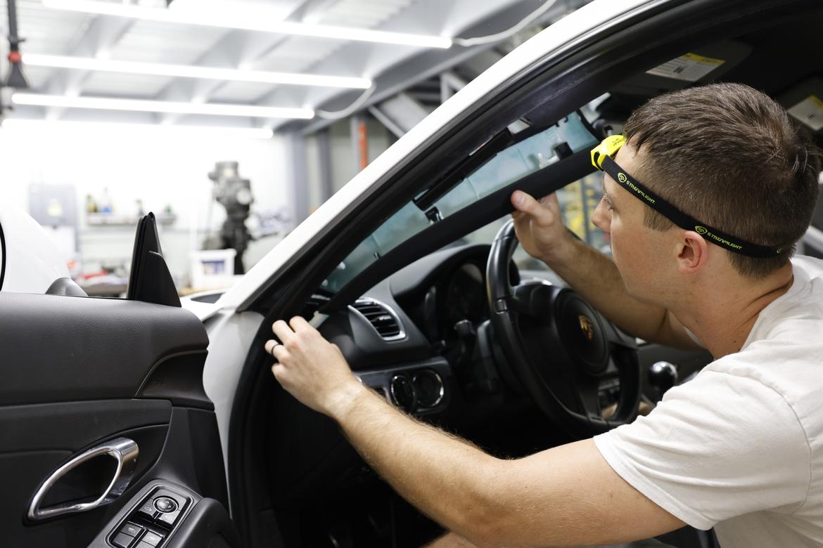

The hardest part of headliner repair is removing the headliner assembly from the car itself. There’s no magic trick here, and the difficulty depends on both the car and your physical dexterity. To put it bluntly, headliner removal kind of sucks.

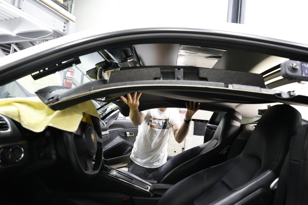

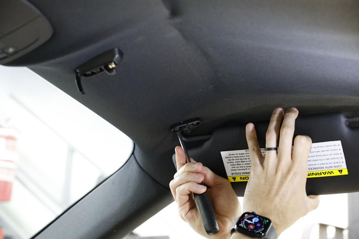

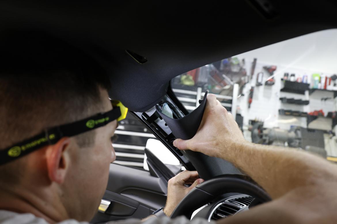

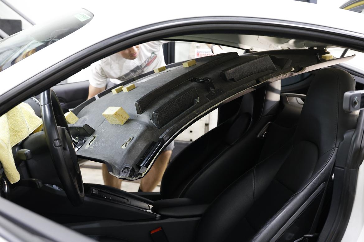

First remove any dome lights, sun visors, sunroof moldings and other obstructions. Carefully unscrew any hardware and then gently pull the assembly off its clips. Rotate the assembly so that you don’t bend or break it, and carefully feed it through an open door.
Cleaning It Off

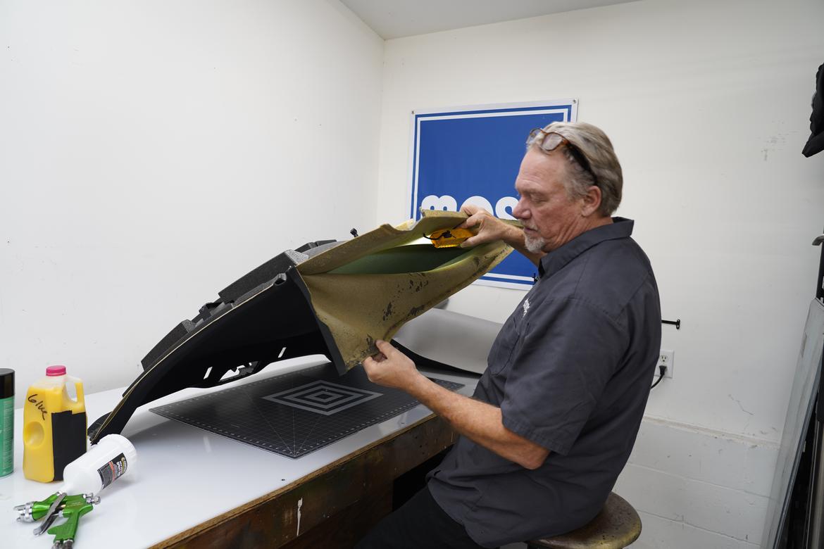

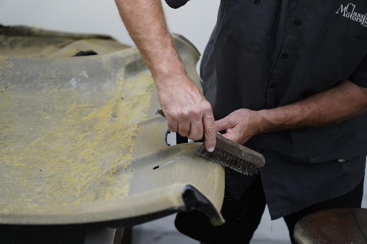

Once off the car and on your workbench or, preferably, a large table, you can carefully remove the headliner cloth from the fiberboard backing. Now you’ll see the actual problem: old, dried foam dust. And yes, it wants to go everywhere.
We find that a large wire brush does a great job of removal. Gently vacuum and brush up the remaining foam dust from the fiberboard backing.

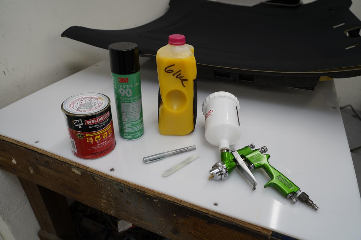

Headliner material is nothing exotic. Every sizable city has a trimming or upholstery supply store. Take your old headliner–the cloth part, not the fiberboard–to that store and buy a yard or two in the closest color you can find. While there, consider grabbing a good pair of sewing shears, some razor blades and some chalk to mark your centers.
You’ll need cement, too. The best and strongest solution is a cheap spray gun (Harbor Freight has them starting at less than $20) and glue bought in bulk. Again, any supply store will sell you the glue by the half gallon–and you’ll need that much to do a headliner for the typical sedan. This commercial contact cement is considered the strongest type of glue you can use.
You can also paint on contact cement with a brush or use spray bottles. Make sure you opt for high-heat versions of any cement you use. Also, use a respirator when spraying anything but water.

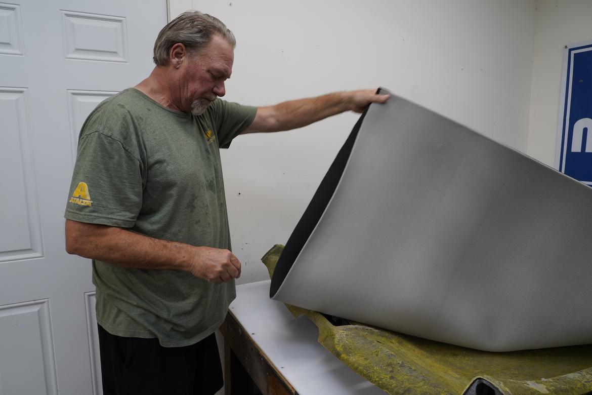

When cutting out a new headliner, use the fiberboard as your template; we generally leave the material about 6 inches larger than it needs to be. We only make cutouts for sun visors, rearview mirrors and the like once the new headliner is back on the fiberboard.
Why? The larger cloth area gives you some runoff area for your spray glue without getting it all over your table and shop. And if you cut every detail ahead of time and then miss your mark when gluing down the cloth, you’ll be sorry when you have holes where you don’t want them.

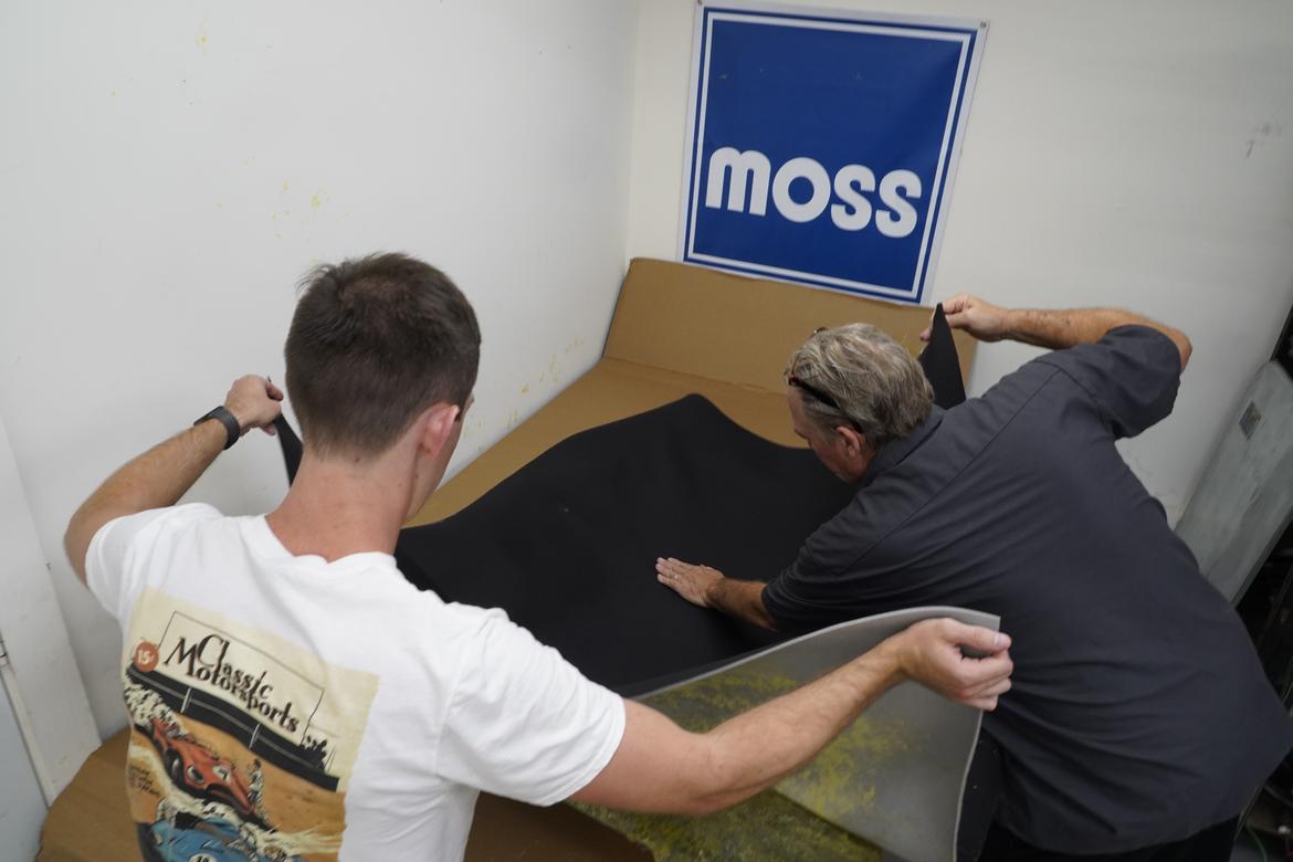

When gluing down the new material, work from the center and press your new headliner material into place. Having a second or even a third person around to hold the headliner material above the board until you are ready to stick it down will help a lot.
Once the cement dries, it’s very difficult to pull the material back up should you have a wrinkle or other issue that needs to be fixed. Fortunately, headline material only costs about $15 per yard, and you’ll need less than 2 yards. So if you ruin some and have to start over, it’s not a financial disaster. Ask us how we know this.

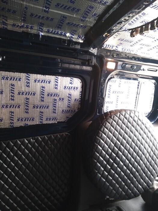

Our project required a bit more time and money than just 50.00. Diamond tucked carbon fiber aint cheap and procrastination has hindered us from atually getting this done. We've just about completed the interrior shell of the cargo area of the van and wrapped up the diamond tucked carbon fiber accesents. Now oneward to the dark grey alcantara fabirc wrap which will be placed over the siless sound dampening and barebone cargo shell. We still have some larger holes thta need to be covered before the fabirc is put in place. We haven't had a cool place to do this or the stamina to hold our arms up that long to put everything in place.
