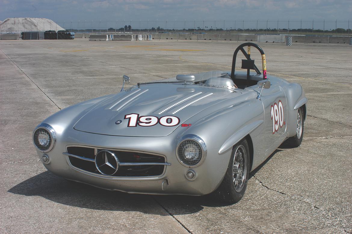

This was not an easy rebuild. Those who build production-class racers from the likes of MG, Triumph and Porsche have volumes of instructions to guide them, along with other racers’ experience. Doug found no manuals or support groups for building a Mercedes 190SL. So he drew from his own experience, an SVRA rule book, and every racer’s helper—trial and error. “I pretty much winged that part of it,” he recalls. “I was thinking, ‘Hopefully it’s got enough power and speed.’”
Doug started by stripping the derelict to its bones. Then he replaced bent and rusty sheet metal, renewed and strengthened mechanical parts, and reduced weight. Once he got the sheet metal in shape, he turned to safety upgrades, which included a stout cage featuring a vintage-style hoop topside and a network of braces inside. “It’s plenty stiff,” he says. Next, he added a 12-gallon fuel cell, a Holley electric fuel pump and a 5-pound fire system, along with a long list of other upgrades.
In the engine compartment, he wanted an understressed, long-lasting powerplant. “I’ve never liked to work on cars at the track,” he says. So he rebuilt and balanced the engine using stock, lightened connecting rods and Arias pistons, which raised the compression ratio to around 10:1. He ported the head, performed a competition valve job, and installed a stock Mercedes cam that drives the factory valvetrain.
A pair of Weber 45 DCOE carburetors handles the fuel delivery, and to help the engine breathe, Doug replaced the restrictive factory exhaust manifold with a handcrafted, free-flowing exhaust header. An oversized aluminum radiator paired with a Fluidyne oil cooler keeps fluid temperatures in check.
To help get the power to the wheels, he lightened the flywheel and mounted a racing clutch. From the clutch rearward, the drivetrain remained stock, including the four-speed transmission, driveshaft and open rear end.
Doug completely rewired the car and installed an impressive array of gauges. For a hotter spark, he installed a modified VW distributor and MSD ignition system.
As you would expect, the bodywork, paint and graphics look like they were done by a guy who owns a body shop. The small curved windscreen and half-tonneau cover add to the vintage look. From the custom tow hooks on either end to the braided hoses and fabricated catch tanks under the aluminum hood, the work is both functional and tidy.
Sorting the Benz: Using Whatever Works
After the seemingly endless rebuild, Doug finally got the 190SL on the track, where his education really started. As soon as he started to build up speed, he discovered that the car’s drum brakes were woefully inadequate. “They would get hot, and they just wouldn’t stop,” he recalls.
The brake upgrade proved to be a major job. Using spindles from a later 280SL roadster allowed him to install larger hubs and rotors. He then fabricated brackets and adapted later calipers for more braking power and better pad selection. To provide for front/rear bias adjustment, he installed an adjustable valve near the driver’s seat. The brakes are operated by a Tilton pedal assembly with dual-circuit reservoirs.
Getting the 190SL to handle required much experimentation, trying different anti-roll bars, shock settings, camber adjustments and springs. In the front, Doug ended up using cut-down springs from a Mustang; the rear set came from a circle track shop. This combination lowers the car about an inch and a half. The shocks are adjustable Carreras that closely resemble the originals.

Despite its hard use, the 190SL has needed little work. Over the years, Doug has refreshed the engine three times—averaging about 57 track hours between rebuilds. Each time, he has fitted new pistons, rings, bearings and valve springs and performed a valve job.
During the Wisconsin winters, he goes over the car from stem to stern, making sure it’s ready for another season. He still marvels at the robust German engineering: “The underside of this car has grease fittings on nearly every moving part.”
The transmission has proved to be the weakest link. “Second gear is too low to use on the track,” Doug says, “and there’s a big gap between third and fourth.”
When he first started racing, he shifted a lot between third and fourth, and the synchros failed quickly. So he started experimenting with running most tracks in fourth gear—and actually improved his lap times by driving a better line to avoid scrubbing off speed. “It’s predictable and well balanced,” he says. “I can slide it through the corners, and that makes it fun to drive.”
Since the 190SL doesn’t have a lot of top-end pull, it’s not as competitive on tracks with long straights, like Road America. “Watkins Glen is my favorite track,” Doug says. “The car is competitive there because the sweeping corners allow me to run fourth gear pretty easily. The 356 guys are shifting two or three times in some corners, and I’m leaving it in fourth. I know it sounds weird, but it works for me.”
In SVRA competition, the 190SL competes in Group 1, Vintage F Production Class, where it runs against the other small-bore racers. In its current state of tune, Doug estimates engine output at 145 horsepower, and at 2180 pounds, the Merc outweighs most of its competitors. So Doug doesn’t often find himself in the front row.
