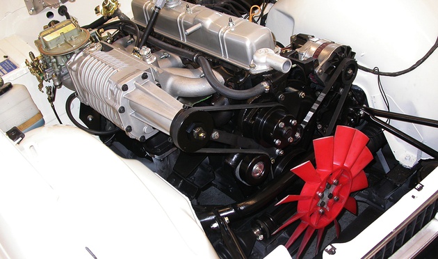

Despite the imposing 46-page instruction manual and the number of parts included in the box, the installation is quite simple. First, the radiator, front chassis crossmember and pulley system need to be removed. The intake manifold and carbs are then pulled from the engine.
Now it’s time to start installing parts. The water pump and new pulleys are fitted, while the Eaton blower and its manifold simply replaces the stock setup. The chassis crossmember and radiator can go back in following some simple hose routing.
Then the mechanical fuel pump is removed from the engine block and its mounting hole is blocked off. The electric pump is installed, plumbed and wired. The bonnet is reinstalled, and the installation is finished.
While we think Moss has done a great job with the kit, we did take some liberty with a few of the installation details. First, we didn’t follow their lead with regards to the installation of the electric fuel pump. The book says to fit the pump to a chassis member behind the left-rear tire. While we didn’t feel like rerouting the wiring and fuel lines to accomplish that task, the real deal-breaker was the fact that the new setup would allow the fuel pump to be pelted with road spray.
We decided to mount the new pump under the hood, near its stock location. We attached the pump to the left-front inner fenderwell—out of harm’s way and about 8 inches from its original location on the engine block. This move allowed us to keep almost all of the original fuel lines in use and considerably shortened our wiring.
We also strayed from Moss’s recommendations when wiring the fuel pump. We didn’t use their included fuse as the stock wiring provided two fuses for us already, and we routed things a little more neatly. We used the purple circuit for a fused, main power source and the green circuit for a fused, switched source that turns the relay and pump on and off.
For our final act of rebellion, we improved upon the crankcase breathing offered in the kit. Like many aftermarket carb setups, the kit didn’t have a provision for positive crankcase ventilation. Instead, there was a provision to hook the crankcase breather on the valve cover to the air filter. While this does allow the crankcase to vent, it’s also traditionally a quick path to fumes and oily air filters. We remedied the situation by installing an inline PCV valve (NAPA Part No. 2-9209) and hooking it to a manifold vacuum port on the carb.
