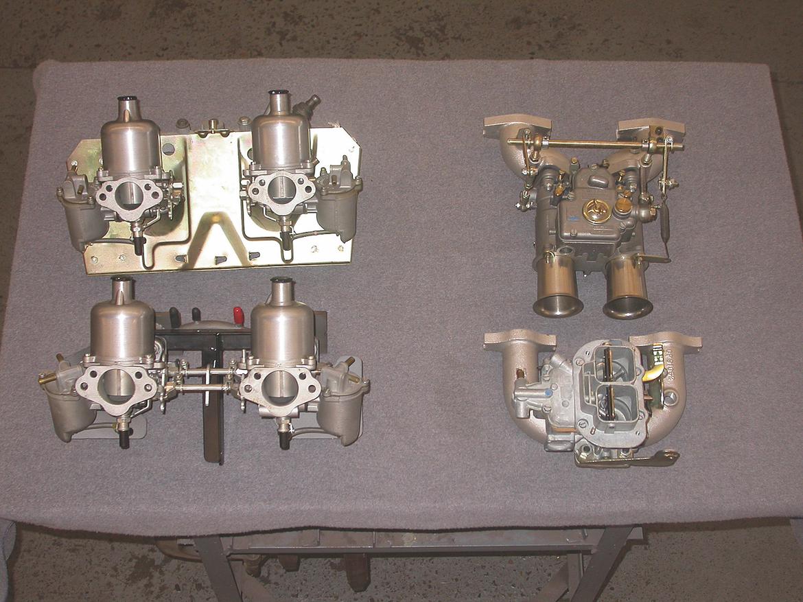

Clockwise, from left: We tested four setups on our MGB engine: 11/2-inch SU HS4 carbs on a factory MGB intake manifold, a Weber 45 DCOE carb on a Pierce intake manifold, a Weber 32/36 DGV on a Pierce intake manifold, and 13/4-inch SU HS6 carbs on a Maniflow intake manifold.

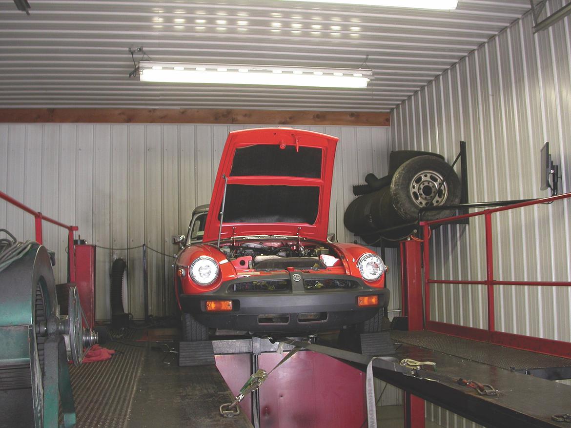

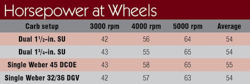

For our first set of tests, we used a 1978 MGB fitted with a bone-stock 1.8-liter B-series BMC engine. We compared dual 11/2-inch SUs, dual 13/4-inch SUs, a single side-draft Weber DCOE, and a single down-draft Weber 32/36 DGV. The venturis in each test were sized to logically suit the volumetric efficiency and displacement of the engine/carb setup being tested. We dynoed all of the combinations on a chassis dyno and came up with the following horsepower numbers at the rear wheels:

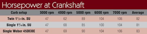

For our second set of tests, we turned to our Modern Midget’s more radical 1380cc A-series BMC engine. This engine features a well-ported cylinder head, higher compression, more cam, and many other performance tricks. It makes good power throughout a big rpm range.
We tested three setups on this engine: the dual 11/2-inch SUs, a single 13/4-inch SU, and a Weber DCOE. Each one was tested on an engine dyno, so our numbers represent the horsepower at the engine’s crankshaft. (The chassis dyno figures always include driveline loss, hence the lower figures for the MGB.)
As the numbers show, each carb setup shines slightly at a specific rpm point, but on average they’re all nearly identical. Nitpickers may say that the Weber DCOE is the best, but in our book it’s only by a hair—a one- or two-horsepower advantage doesn’t make a clear winner in our book. Context is king when choosing a carb setup.
It Depends: Like We Said, Context Is King
The MGB testing was done on Baker Engineering's Dynojet 248 chassis dyno.
So, the numbers show the Weber DCOE winning by a hair, but each setup produced nearly the same numbers. Which do you choose: One or two SUs, a side-draft Weber DCOE, or a downdraft Weber DGV? Here’s how we decide.

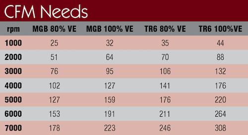

Carbs are “sized” by the amount of air they can flow, and this sizing should closely match the engine’s needs. The engine’s capacity is one factor of this sizing, but its maximum rpm and volumetric efficiency are also important. For example, a large engine running at low engine speeds may need less carburetor than a smaller engine running at higher speeds.
The bottom line is that an engine’s CFM needs are determined by this formula:
If we assume 80 percent volumetric efficiency for a stock engine, we’ll see that a stock MGB (roughly 1800cc or 110 cubic inches) needs 153 CFM at 6000 rpm. A stock Triumph TR6 (approximately 2500cc or 152 cubic inches) needs 211 CFM at 6000 rpm.
If we add performance modifications to either engine, we’ll see the VE increase—along with the CFM needs. Likewise, if we raise or lower our maximum rpm, the CFM needs will also be affected. This chart shows several of these scenarios:
Note that a normally aspirated engine will rarely achieve 100 percent volumetric efficiency. However, with forced induction, 100 percent or greater is more easily obtained.

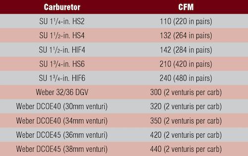

Now that we’ve figured out the math regarding our engine needs, we turn to our carburetor choices. This chart shows the flow potential for our common carburetor choices:
Note and disclaimer: This data was taken from multiple sources, some averaged. Flow numbers may vary slightly due to testing conditions and methods or tools used. Nonetheless, this information should be useful in carb sizing decisions.
Now it’s time to put this all together. Once we know the CFM needs for our engine, we can pick a carburetor size and setup to match it. It’s better to go a bit oversized than undersized, but don’t go too far. Installing too much carburetor will reduce power at lower engine speeds and allow the fuel to fall out of the air/fuel mixture.
