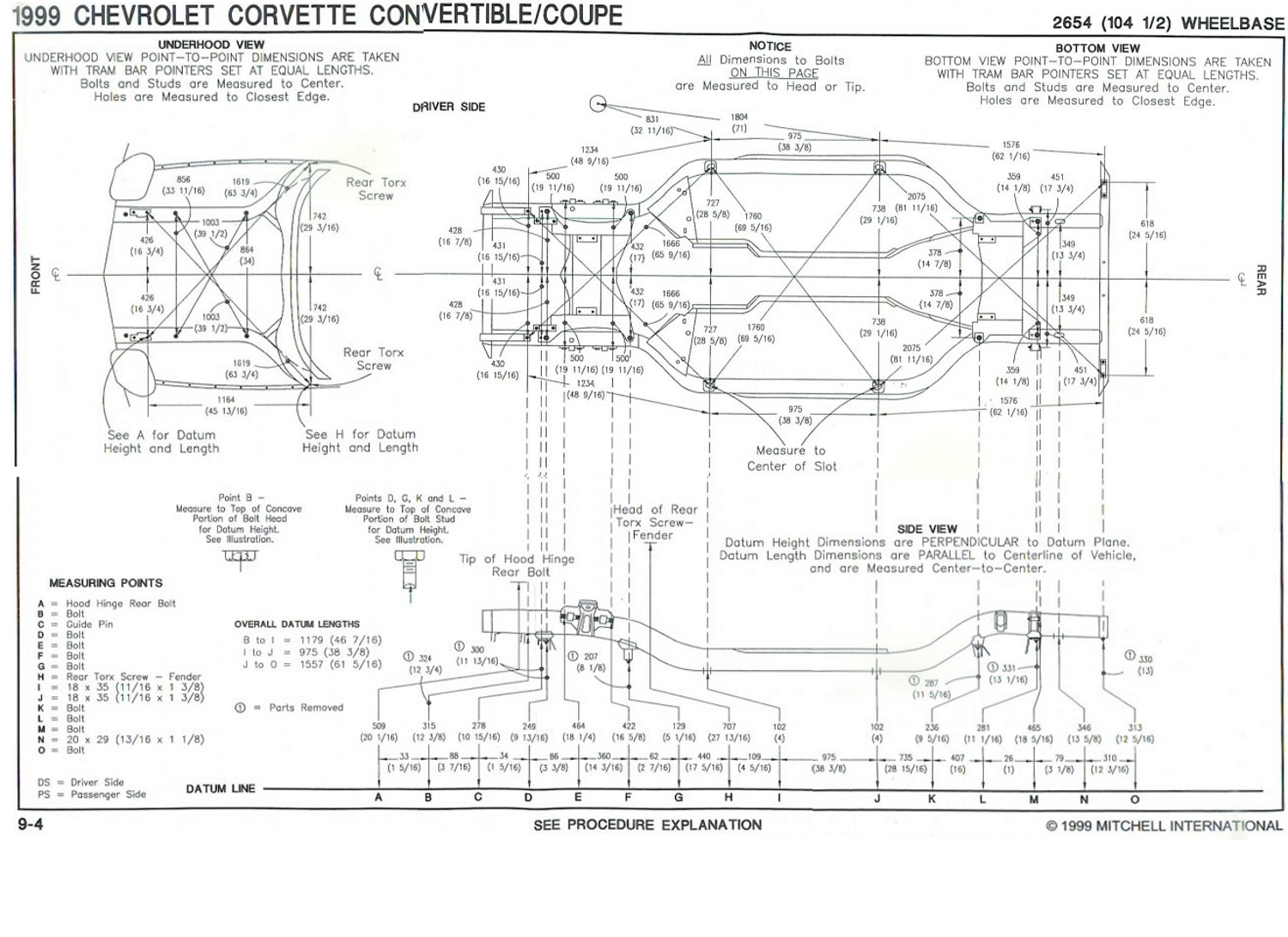

I need to know the side to side distance between the rear subframe mounting bolts on a C5.  I know the front pair is not the same as the rear pair.  Should have measured that before chopping it in half.  :-(

DeadSkunk (Warren) said:
http://www.supermotors.net/getfile/1015374/original/c5-framedimstitched1.jpg
Perfect!!!  That drawing shows exactly what I needed!!! Thank you!!!

Looking at the side view....it appears that the mount points aren't the same distance above the road. The sub-frame tips forward.
You are correct.  I did know that already.
