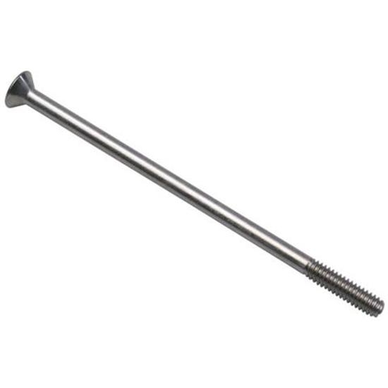

Speedway says they are 1/4 - 20. Just buy longer bolts with an attractive head.
http://www.speedwaymotors.com/Bolts-for-Tall-Centerbolt-Chevy-Valve-Covers,33066.html?utm_medium=CSE&utm_source=CSEGoogle&utm_campaign=CSEGOOGLE&CAWELAID=1271968222&catargetid=530009170000006315&cadevice=c&cagpspn=pla&gclid=CKzot5G5vLsCFaTm7Aod4R0AAw
