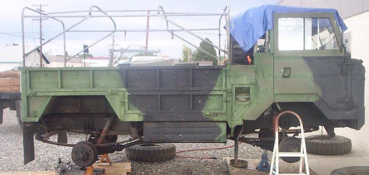

Best way to bleed a Series Rover is a gravity bleed.
9/19/19 5:06 p.m.
I'm not sure it is all that much different than a Series Rover. They were designed near the end of the Series IIa and produced at the same time as the Series III. They apparently share a high degree of brake line convolution.
cdowd
cdowd Dork
9/19/19 5:27 p.m.
Pilotbraden showed me the way of hooking up a vacuum line to the bleeder and reving the engine. We used his rx7 to bleed my flat fender Willy’s when nothing else was working.

Is the release fork bent? Probably can't get it out without dropping the gearbox, but check it carefully, especially if the pressure plate looks normal.

Air can suck in from the slave or the master. I would replace both given the age of the truck.Or try o rebuild if the bores are honeable still.

Or you got a bad new part. As someone else on this board (curtis?) mentioned, a new part has never worked, and I have seen far too many bad new parts to trust anything.

Post a picture of the reservoir top. It may be familiar to me. Also I have found almost every bleeder screw will leak a little at the threads when loosened. I now go to the trouble to make a pressure fitting for everything I do. I use a Motive brand (garden sprayer) and never put fluid in the tool itself, I only use it to pressurize the car's reservoir. Yes it is a little annoying to keep filling, but putting fluid in a pressure vessel that you use as seldom as I do is begging for moisture contamination. Only takes 5 psi and I have used it on everything from a Gemini F. Jr.  to  my DD Volvo. Little integrated Girling master cylinders are the worst for small capacity.

That sure looks like an aluminium replacement for the large Girling remote reservoir. Plastic Girling cap is sometimes available and cheap when it is. Might be the same thread too. Are you sure that is a metric pitch? The brits never discard a machine tool!

I think relays are the secret to making Lucas components survive. That ignition switch, for example, may be carrying the complete electrical load of the vehicle. It does in some of the other Rovers of the period. Throw in a couple of relays to make sure the headlight and ignition loads are carried elsewhere and you're in a better place.
tuna55
tuna55 MegaDork
12/5/19 1:43 p.m.
100% agree based on what I have seen. The most egregious example I saw (not firsthand) is some Lotus where the 12v went through the chrome plating on the plastic turn signal stalk.
