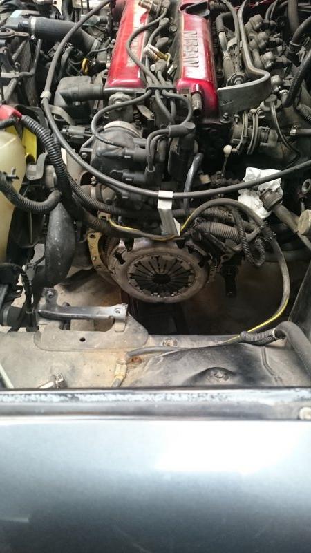

The first thing to sort when we got the car home, was of course the running problems. No use turning it into a race car if it doesn't run...
Well, it idled nicely but would stumble and misfire badly as soon as it was given some revs. We googled for a fault code solution but could not find anything. Some Internet wisdom pointed at a leaking valve cover gasket, filling the spark plug holes with oil. But they were dry.
So, basics firs, compression (OK), new plugs. Now it would rev, but the test drive was disappointing - it started misfiring again.
The fuel rail has a rubber hose, making it easy to do the "redneck fuel pressure test" - pinch the hose with your finger. My calibrated fingers said we did not have 3 bar, rather like...almost no pressure. Disconnected the hose, pointed it into a bucket and hard wired the fuel pump. Not much flow there. Bypassed the filter, same story.
So we attacked the fuel pump. Nissan has been kind enough to fit an access panel under the rear seat so the pump was soon out. Not looking very nice though!
The filter is completely covered in black goo. Looking into the tank gave an answer...
The tank was full of sand! Also note the stack of food that some unidentified rodent (?) had left behind. We wondered, could someone have messed with the previous owner, and put sand in the tank? Seemed unlikely with her being a mature 60+ lady, but you never know.
Anyhow, we dropped the tank, flushed it, and fitted a Walbro copy pump. Doing that, it was pretty obvious that the filler pipe had been repaired before - it runs right through the rear wheel well - probably was rusted through and then road grime was free to enter the tank.
With a new pump the engine ran great. Success!

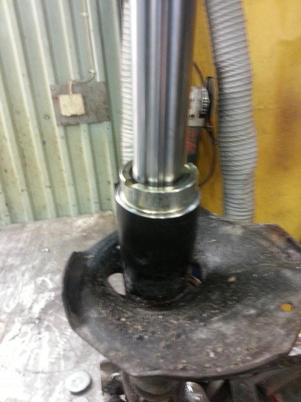

Now we turned our attention to the suspension. The left rear strut top was screaming for replacement.
Now, these strut tops are pretty expensive and most parts shop listed them as out of stock. The local parts storese were even more expensive and just as much out of stock. I almost went back to the scrapper before I tried another online store - mister-auto.se. They had them. At half price! Score.

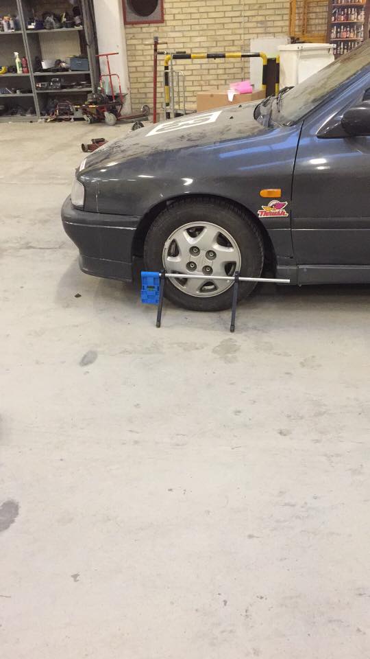

The other issue was the camber. We used some advice from US G20 racers. The rears were easy, camber bolts sorted that.
Somewhere around 3 degrees negative is what we got.
The front suspension is tougher, the Primera has a nice sort of wishbone suspension, but it's not adjustable... There are shorter top links available, and expensive camber bolts for the top links. We did it the redneck way, shortened our top links (approximately 10 mm) and that gave us a little bit better settings up front. Toe was adjusted to around 20 minutes out.

We swapped in new bushings in the front lower control arms, and new ball joints. Some alignment after that...
We didn't get exactly what we hoped for - I would have liked to try more toe out but we opted for not changing too much.

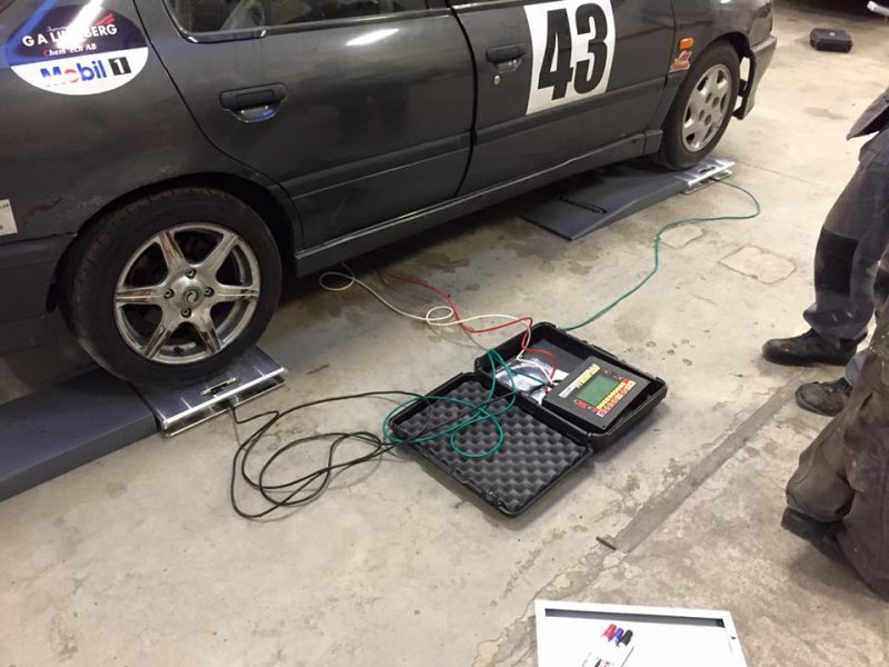

Then we put the car on the scales.
I don't recall the figures but of course it is front and left biased (standard battery, left front...). Some work on that is called for in the future.

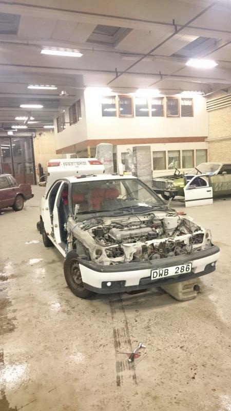

When the season ended, we didn't do much with the car for a good while. In November we went out to the scrapyard, to get some body parts from the white P10 we got the wiper stalks from. The indicent in the last race dented the right front fender badly, and we also felt that some extra doors would be nice. We also took a set of front calipers for spares.
Then one of our drivers remembered that a friend had a P10 standing, waiting to be scrapped. So we snitched that one!
It's a bog standard 2.0 115 bhp but the gearbox should fit, and the engine bottom end is supposed to be the same (both engines are SR20 derivatives). It should also offer front and rear suspensions as spares.
One night of stripping got us a bit forwards...

We really don't like working on fwd cars, but we got the old 'box down. The clutch did not look too happy.
Well, we had prepared for that, with a new set. We had no real clutch alignment tool and with no pilot bearing it is a bit hard. But we got close.
SR20 ready to accept another gearbox:
But first, some engine mounts. Three out of four was easy to find new, the remaining was either out of stock or stupid expensive. So we got three new ones, and had to keep one of the old - but all were prepped with some polyurethane.
Time to put the gearbox in. Only it didn't go in...not the last bit. After too much sweat we found the reason.
A dowel in both the engine block and gearbox trying to occupy the same space. With that removed, we tried again...and after more sweat, it was finally in.

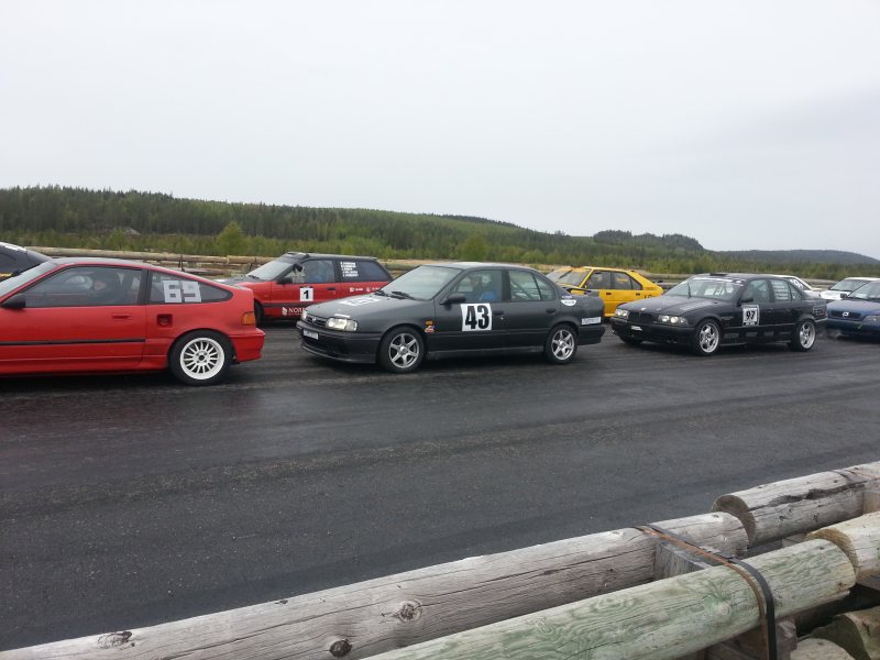

The lottery gave us starting position 11, second-to-last. So we had a long way up...
After a couple of stints we were hovering around place 5-6, on the same lap as the leaders. It was tight but we also felt that we really needed to drive at 10/10 to keep up. We managed some good (or decent at least) driver changes that actually at one time earned us a spot.
A bit later in the race some fast cars had given in and our 5th spot felt pretty safe. Same lap as the leaders still and 2 laps to spot number 6.
As the race was ending the tactics started. When do we have to make our last swap? We calculated that it would have to be done with only a few minutes left (rules say maximum 10 laps per stint). But we also decided to do as the car in front of us, who swapped drivers on the same lap as we did last time. That way, we would be even, under all circumstances.
One team felt they had swapped later so drove on, and took the checkered flag. But then the timing crew found that they had driven a 14 lap stint in the middle of the race, accidently. So they were penalized and that moved us up to 4th. Great result but not all our doing.
The car feels good but the others have found some speed in theirs too!
