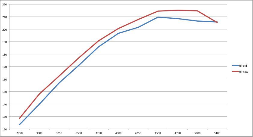

I had time to do some more dyno(app) runs today and compare with last year.
Differences for today's runs were: New BBK shorty headers (old ones were JBA), no more header leak, no more restrictive exhaust gasket, BAMA chip (however the same total timing as last year), 89 octane instead of 91.  Today was 5 degrees cooler than last year's runs.
I think the exhaust gasket and chip are where most of the gains came from, although that is just a gut feeling.
To make the graph, I did several runs, then threw the outliers out, and averaged the best 3 of what remained.  It is an ipad app, but its some where to start.  I had to transfer the info to excel manually though.
It is strange that at the top end it really falls on its face harder than the old runs.

Valvesprings...  My guess is you have valve float at 5000 rpm.  With 179k on the clock this is not to be unexpected.

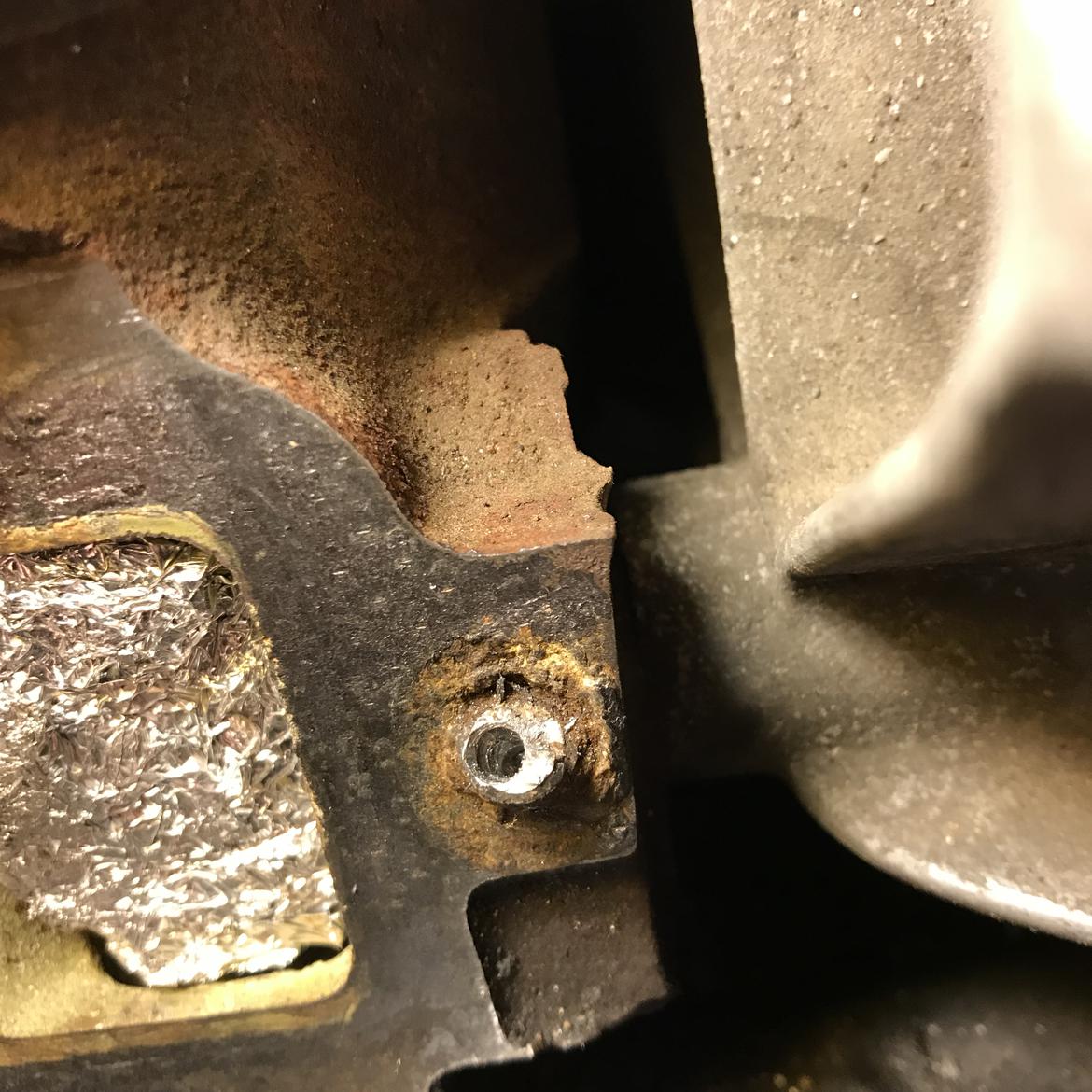

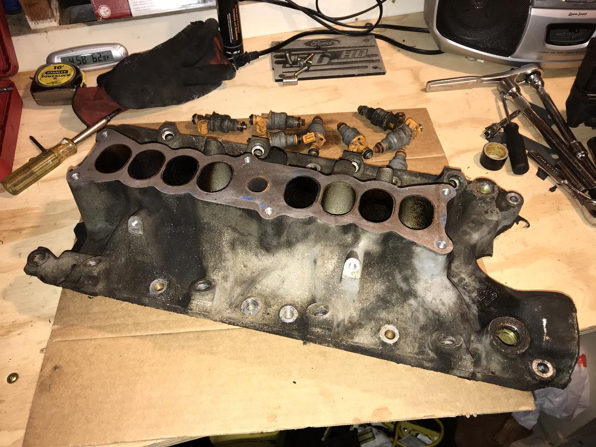

I got the intake off today. I ran into two problems. One of the lower intake bolts snapped off. I hope it won’t be too hard to drill out.
Next, one of the plastic pieces on the bottom of one injector broke as I was removing it. Does anyone have a 19# injector they want to get rid of?

jj I can probably send you a 19 lb injector or two myself.  Send me a PM with address.  If you have a picture of the intake bolt you lost, I probably have a coupe of them too.

Picture of that bolt.

I started working on this bolt that broke off. So far it’s a no go. The easy out is spinning in place. So I may drill it more and use a bigger size, but the hole is off center so I don’t know how far I can go. Admittedly I don’t have much experience with this.
Other option which I really don’t want is to take the head off and take it in to a shop.
Any suggestions?

yes get a few different screw extractors to try.  If you break one off in there you are hosed.
Machinist drill bits also come in very fine increments.
If you can split it with a chisel you will win too.  Sometimes you can tighten it to break it free too.  If you drill it out big, you can always repair it with a helicoil.
If you do have to pull the head, pull both, and redo the springs and seals and think about a valve job.  If you are going to spend more than that go aftermarket.

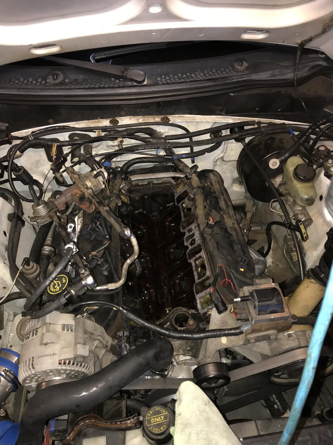

I have decided to remove the heads. I still have to find a machine shop to remove the bolt though. The seals aren’t leaking and I am cheap right now, so they will probably stay. Springs, definitely. I will be checking those places recommended by Anthony.
What I am excited about is that I am going to port these heads myself. Nothing major, but just grabbing the lowest hanging fruit. A while back I bought a David Vizard book on porting, and I have been following a thread he started on porting the E7s specifically. So I have been studying that as well as some basic tutorials.
So I think this my plan. I seem to change my mind often.

That’s why this is a hobby!  Have fun I think Vizard is a decent source.  Remember polish the exhaust side all you want but the wet side needs roughness and turbulence to prevent fuel puddling.
