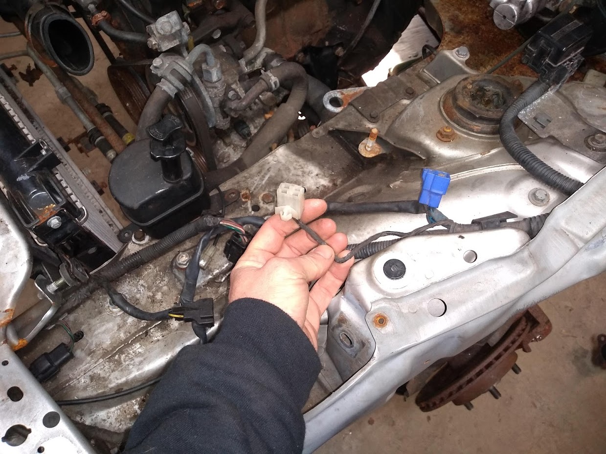

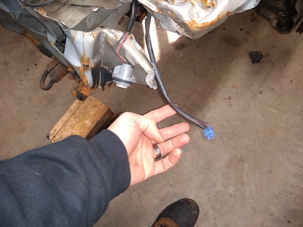

Also, anyone want to tell me what the 'extra' plugs go to?
Driver side:
And passenger side:
And I assume these are fog lights?
