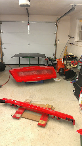

At this point we had about 48 hours to paint the Jeep and load it on the trailer for the Challenge. It felt like we were on some crappy TV restoration show.
We stripped off all the panels we could and and turned Jeff's shed into a paint booth. With all the plastic it looked Iike a kill room from the show from Dexter. After day one we had almost everything in primer and a few things painted red.
Since we were running out of time we built a paint booth inside a paint booth inside a pop up tent so we could spray 2 colors at the same time.
622069_422808194445461_1132182417_o
With less 12 hours left everything was painted but we still had to put everything together. At this point we called it a night and decided to assemble it as we loaded it on the trailer.
Ok, so we left an hour or 2 late but about 90% of it was done.
