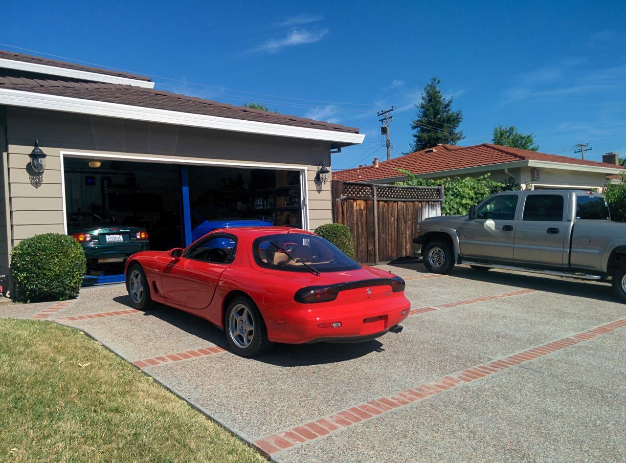

So earlier this year I picked up an FD. I wanted something low-miles and very close to stock, which is fairly difficult to find at this point, so I spent about six months looking for it. When I found one it was on the east coast, I'm in California, so I posted a thread about whether to ship it or go pick it up (here). I wound up having it shipped, it arrived in June. I've posted stuff about it a few other threads on a couple forums, but decided it really wants a build thread of its own. Since I don't have one on GRM yet, I'll put it here.
It's a one-owner car (well, two now), had 58K miles on it and was completely stock when I got it. It still had the original shocks, original brakes, original radiator, etc. I intend to keep it that mostly stock -- replace broken things, improve reliability, but fundamentally it's going to be a fun street car. I have a nutso track car already in the form of the Miata.
The day it arrived:
My first peek!
Out in the California sunshine!
With the rest of the fleet (minus wife's Odyssey). There are six turbos in this shot!
Tucked away in the garage:

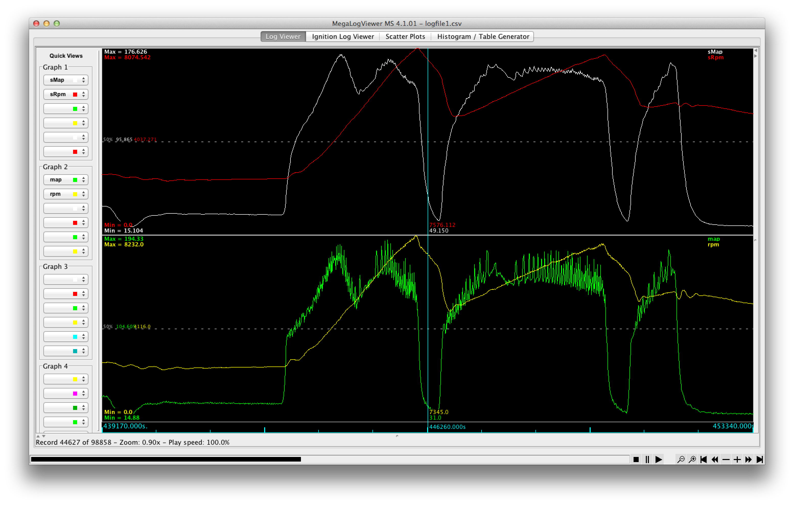

Next up was to check out the motor and see how it was doing. I'd had a pre-purchase inspection done at a Mazda dealer in NC, they did a compression test and reported that it was good (don't have the actual numbers sitting around any more). From what I can tell from reading about them, the real question is whether the boost numbers line up properly. You're supposed to hook up a boost gauge, run it to redline, and watch the gauge and the tach at the same time while not hitting anything. Ideally, it should go up to 10 psi, drop to 8 psi as the second turbo spools up, then climb back to 10 and hold that. Well, I'm a software guy and have been playing with Arduinos on my Miata a bunch lately, so we decided to datalog it instead.
So, tee off a vacuum line, hook it to a MAP sensor, plug that into the arduino. Tap another line into the IGN output in the diagnostic connector and I've got an RPM signal. A couple pages of C later I took it out for a drive, logging the values to a csv file. Then feed it to MegaLogViewer (intended for Megasquirts, but it turns out it'll basically graph any csv file you throw at it), and I've got:
In the top chart white is map, red is RPM, both are smoothed. The raw signals are in the lower chart, as you can see there's a lot of noise in the data. The curve looks pretty good, that's basically exactly what it's supposed to be. I guess the rats' nest of vacuum lines seem to working as intended!

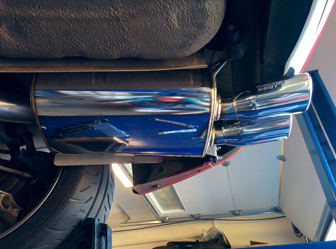

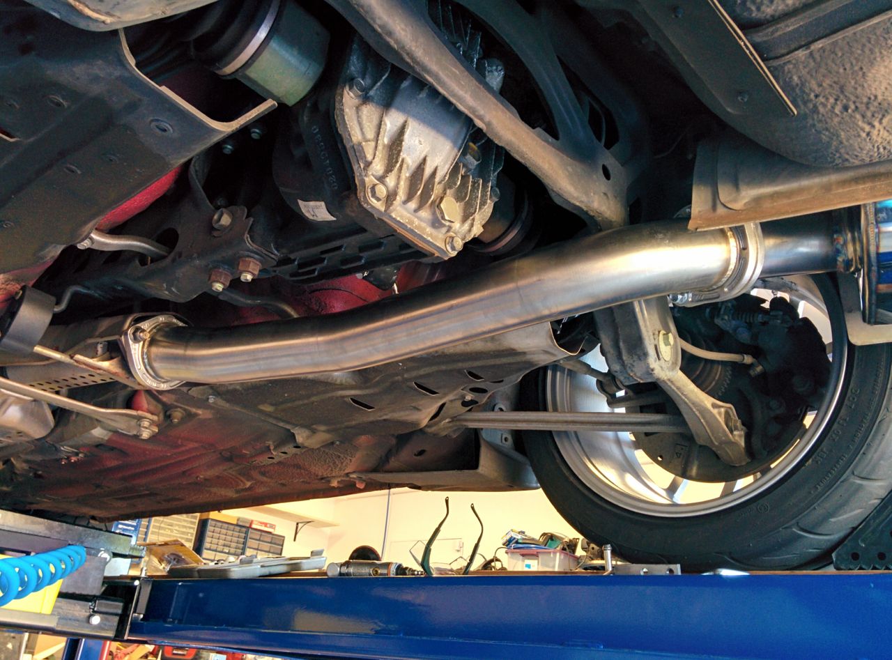

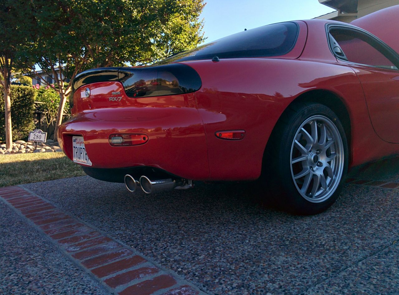

Next up was to do something about the muffler. The car had clearly not been driven a lot, and the muffler had rusted through on the bottom, presumably from condensation building up in it. There's very little rust on the bottom of the car -- more than I'm used to living in California, but "rust-free" by east coast standards. So I called up Goodwin Racing (one of my favorite Miata vendors, but it turns out they sell RX-7 parts too!) and ordered a Racing Beat muffler for it. Installation was pretty simple.
Shiny!
Obviously upgraded, but not the giant ugly tip a lot of aftermarket FD exhaust have.

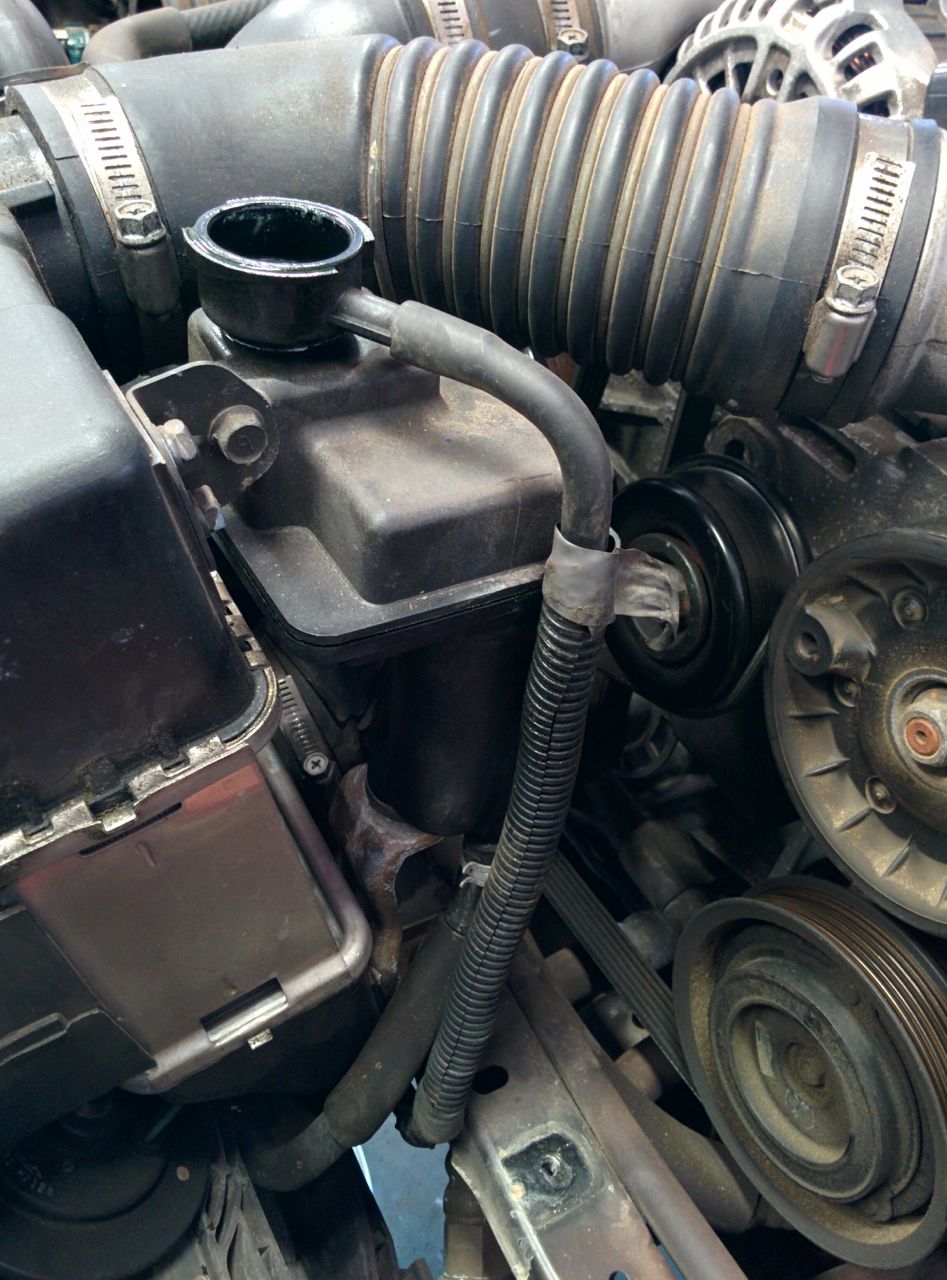

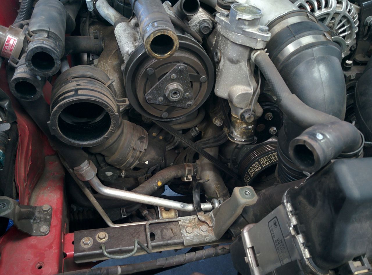

The week after the Laguna event, I was driving the FD to work and started smelling coolant. Oops, guess it's time to put those parts in. So in we go:
Airbox comes off. Wow, that's a lot of air box hoses.
Battery & tray come out.

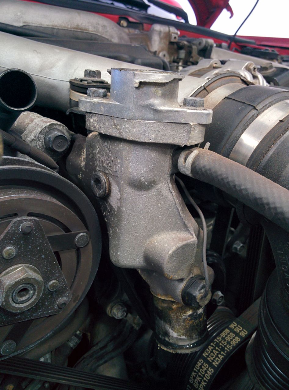

Here's the AST:

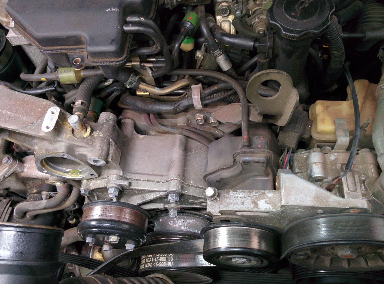

Here's the thermostat housing. The smog pump to the left has to come out to get this off:

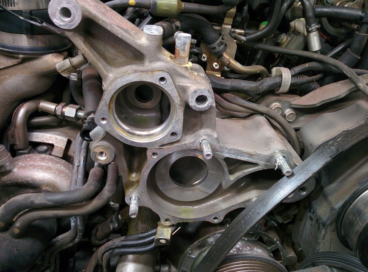

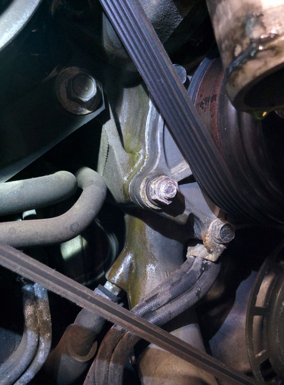

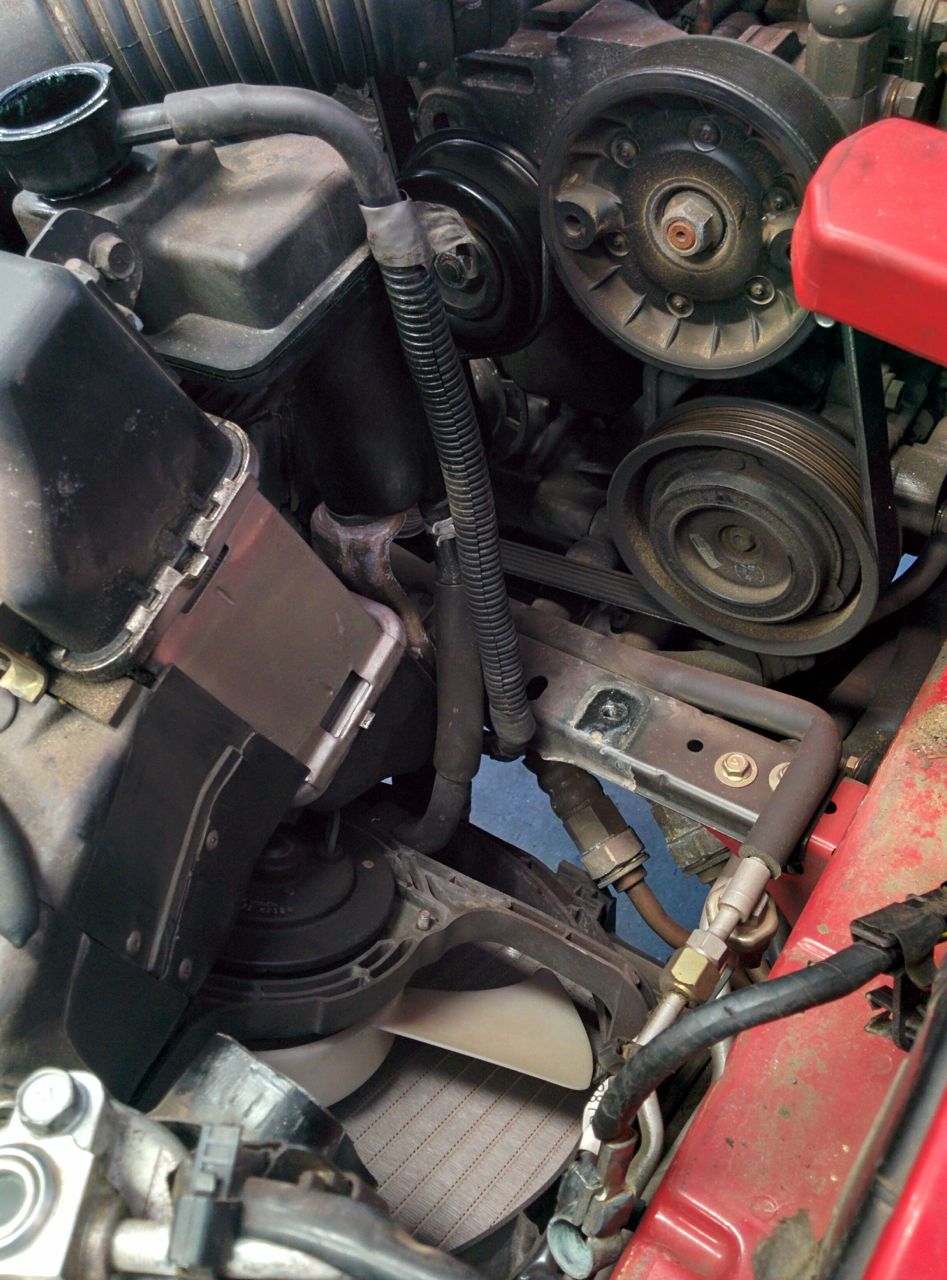

After getting the smog pump off I looked underneath and, uh oh. What's this?
After pinging a few rotary friends I concluded that this job had just gotten bigger, need to do the water pump too. I live about a mile from a Mazda dealer, so I hopped in the Miata and went round, but alas the parts department had closed 10 minutes earlier. Calling around to the local FLAPS got me a water pump & gasket available Sunday morning. So I can't finish the project, but there's more to take apart.

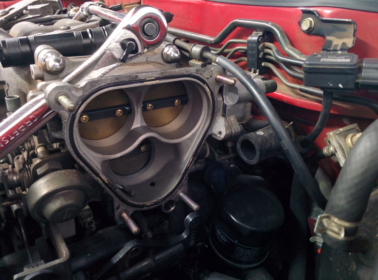

The rest of the intake plumbing comes out, showing the fancy multi-plate throttle body:
Alternator comes out:

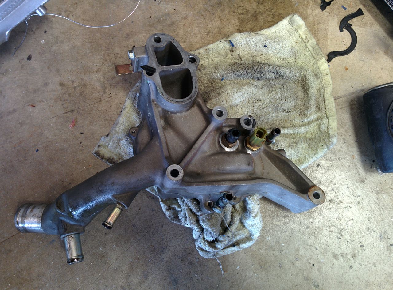

Water pump comes out, leaving this housing:
codrus
codrus SuperDork
11/15/16 1:30 a.m.

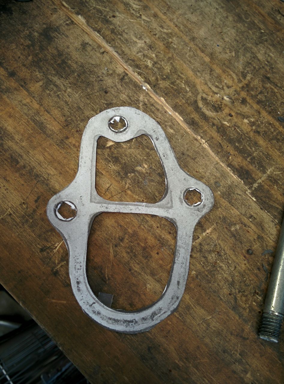

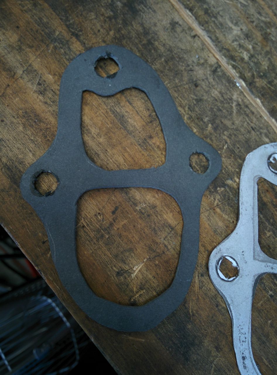

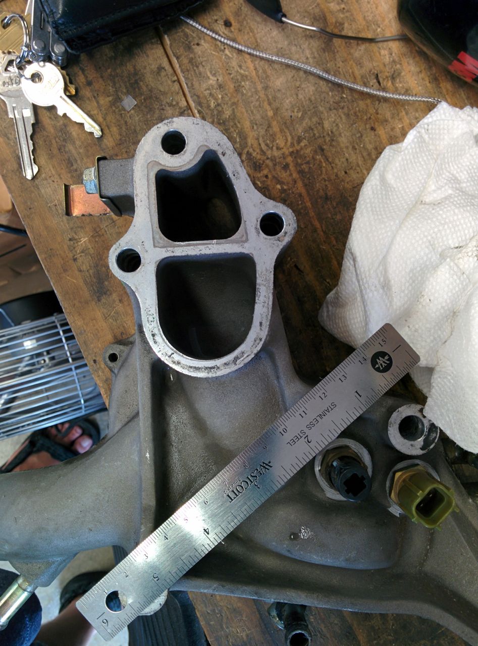

The water pump housing sits on the front housing of the motor. Unfortunately, it's not bolted down, instead it's sandwiched between the water pump and the front housing using studs. This means that when you pull the water pump off, the gasket between the WP housing and the front housing usually tears, and mine was no exception. The FLAPS didn't have that gasket, it didn't even show up in their computer, and Mazda was closed. So, technology to the rescue -- take a photo of the flange with a ruler in it for scale:
(yes, one could copy those keys from the photo, but it turns out that they're both obsolete ones going to locks that don't exist any more -- I really should get around to taking them off my key ring!).
Load the photo into photoshop, rescale so that the ruler is correct, then edit out everything but the flange. Print it and cut it out:

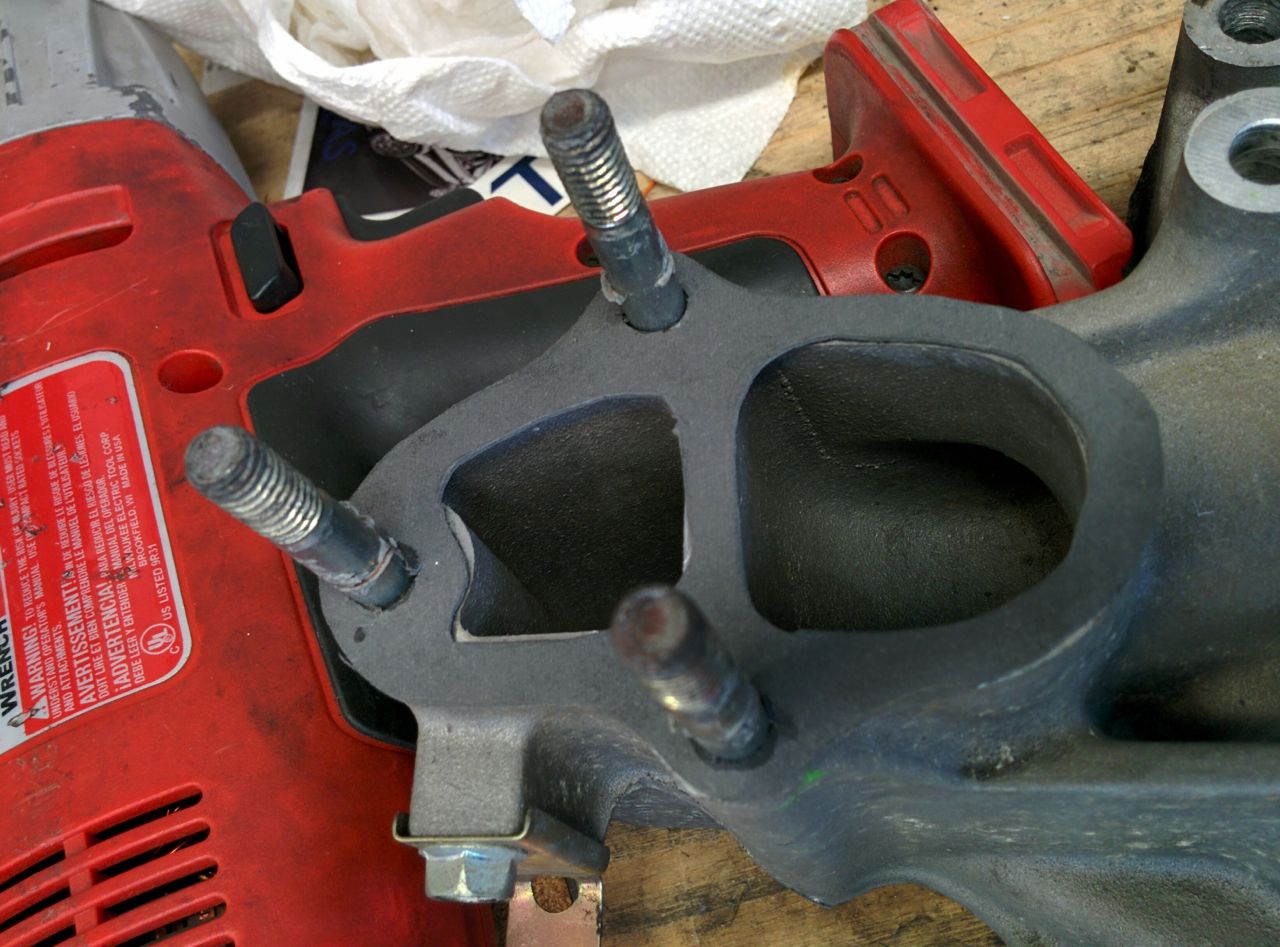

Inkjet paper is kind of a lousy gasket though, so trace it onto some proper gasket material and cut it out again.
Wow, that worked really well. I've never made a gasket that fit that well before.

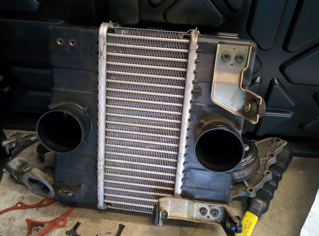

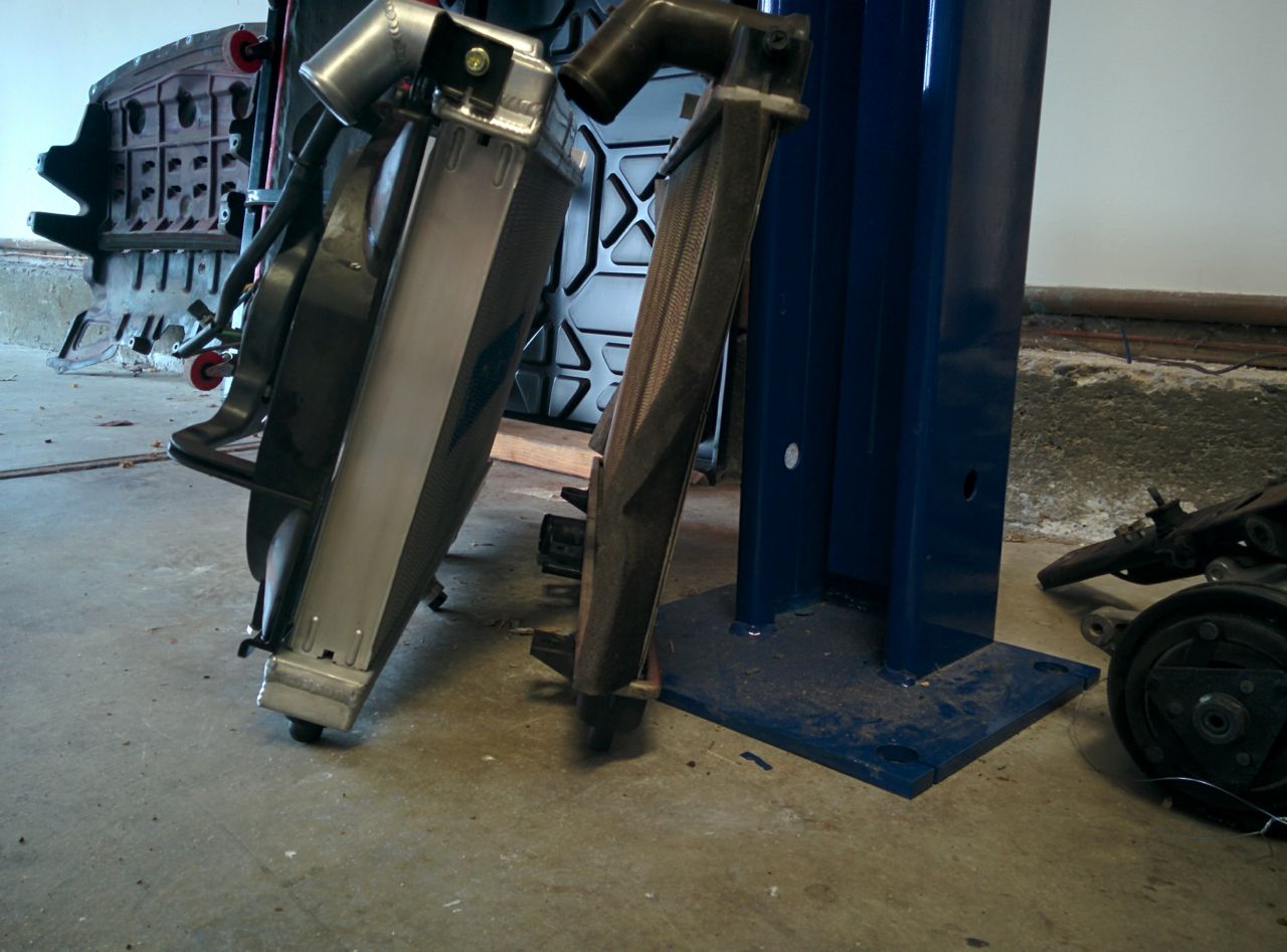

How cute! It's just like an intercooler, only smaller! :-)
The Koyo is noticeably bigger than the stock radiator. Early versions of this rad had a reputation for not fitting very well, but this is a newer version and it went in fine without needing to cut anything. The intercooler bolts were moderately a PITA though.

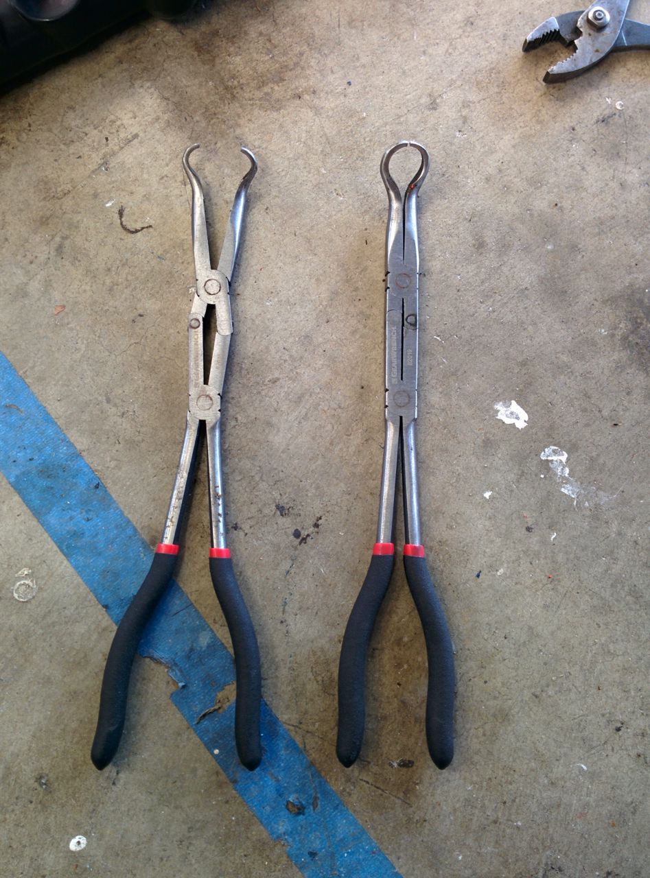

BTW, these hose clamp pliers are a godsend when doing something like this. I picked them up on a friends' recommendation a few months ago, hadn't used them until this job. Highly recommended, I think I got them at Amazon.

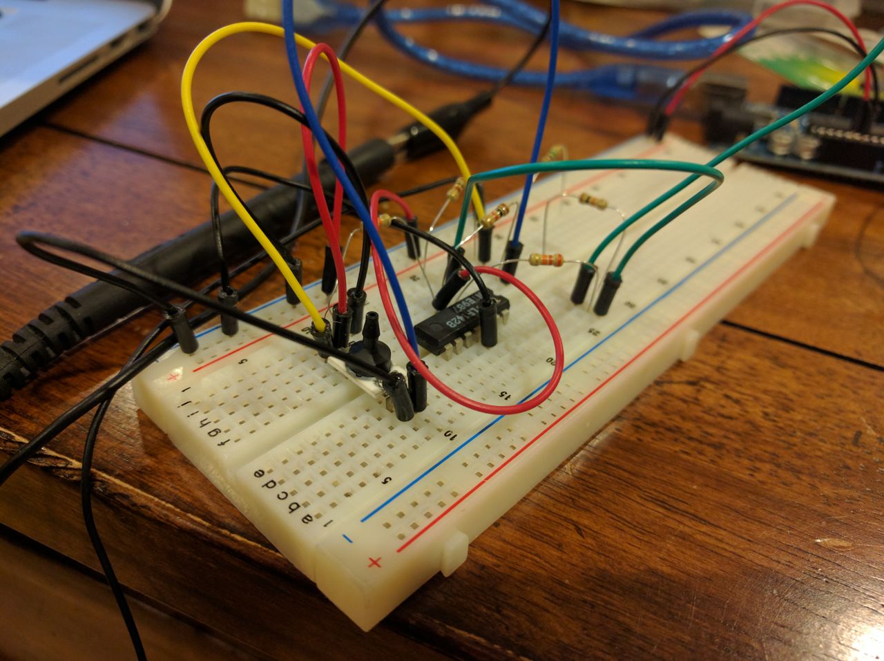

So as I mentioned earlier, I want to get my own compression test numbers for the car but, as you probably know, compression tests with rotaries aren't as straightforward as with other cars because of the 3 combustion chambers sharing a single spark plug. There are techniques for using a standard tester that involve watching the pulses on the needle and trying to judge the differences between them, but that seems kind of unreliable for me. There's a really expensive electronic factory Mazda tool, and there's a $400 electronic aftermarket tool, but blech.
It seems to me that an Arduino and a pressure sensor should be all you need, maybe $30 in parts! So I ordered a pressure sensor, specifically a Honeywell NBPDANN150PAUNV. This is where my inexperience with electronics shows up, because it turns out that unlike the MAP sensors I've used for data logging stuff in the Miata before, this is an uncalibrated and unamplified pressure sensor, so the output is measured in millivolts, too low to accurately read with the arduino. It's also a differential output, apparently centered on 2.5 volts. Ah well, in my defense there don't seem to be many pressure sensors at mouser that are rated to 150 psi!
So it needs amplification in order to be readable, and from what I can tell an lm234/nte987 op-amp sounds like the right answer. So I picked one up at Fry's (along with a few others just in case) and decided to give it a try.
Well, apparently I'm doing it wrong, because it doesn't work. At ambient the sensor puts out around 16.5 mV between the two differential pins, and engaging the organic lung-powered mity-vac I can get it down to about 10mV (can't find the actual mity-vac, but this will do for now). I hooked up the op-amp to give around a 20x gain (so as to put it into the range the arduino can read with good resolution), and tested it with a 4.5mV input signal -- got a 26x gain. Larger than I expected, but OK. Unfortunately, when I feed it the inputs from the sensor, the 16.5mV ambient signal becomes a -17mV ambient signal, the lung power brings it down to about -23mV, but the op amp output is stuck at 578mV, which doesn't make any sense at all.
Still trying to figure out why it doesn't work, argh! :)

A video camera / smart phone and traditional compression tester work well.
JtspellS
JtspellS SuperDork
11/20/16 12:03 a.m.
http://rotarycompressiontester.com
Seem like good guys, and worst case you sell it off to someone else and get most your money back?
Look forward to the build on your FD and still have it in my mind to own one some day.
codrus
codrus SuperDork
11/20/16 12:54 a.m.
JtspellS wrote: http://rotarycompressiontester.com Seem like good guys, and worst case you sell it off to someone else and get most your money back? Look forward to the build on your FD and still have it in my mind to own one some day.
Yeah, that's the $400 one I mentioned -- OK, I guess it's $340. Still, if I can build one for $30 in parts, I'd rather do that. :)

I spent some more time playing with the pressure sensor today and decided that I really need to buy one that's amplified & calibrated, rather than trying to DIY that with this one. So it'll have to be a compression tester with $60 worth of parts, instead of one with $30 worth of parts. :)

also if you can build an arduino rotary engine compression tester I will give you money for one right now haha

I bought the proper amplified pressure sensor, need to get back to that project. Now that the holidays are over, hopefully I'll have some more spare time. :)
