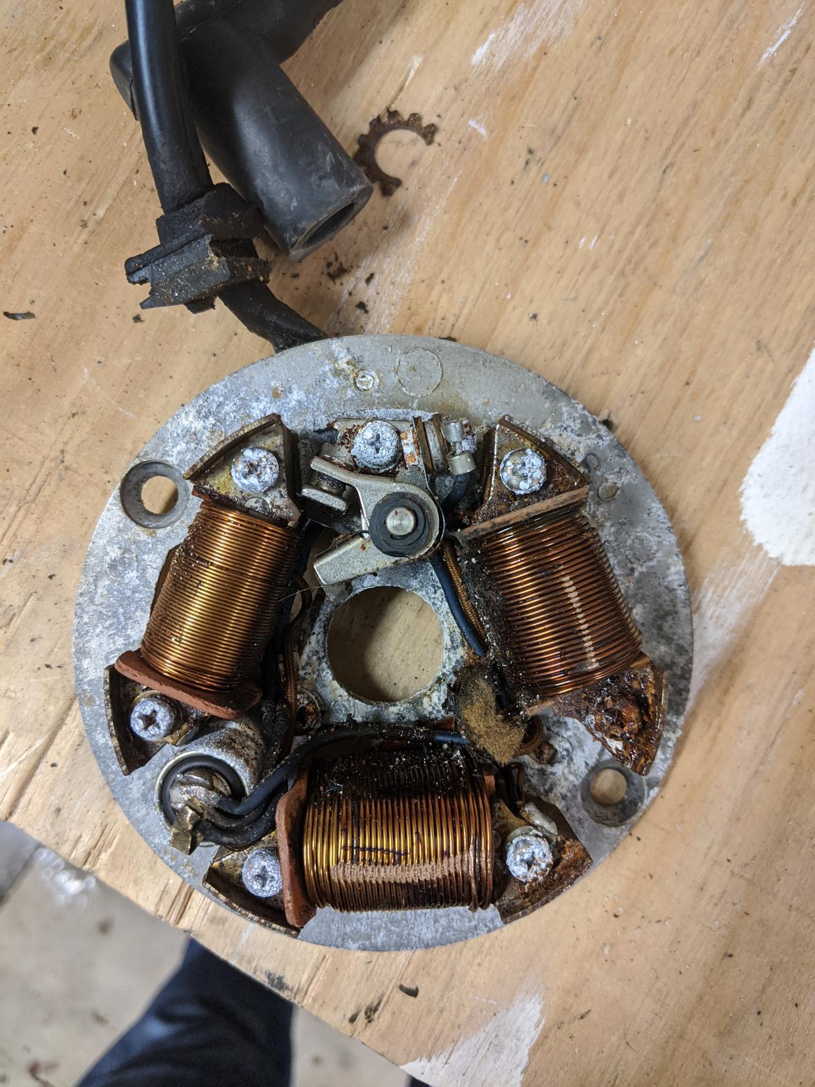

Since I've been home for the last 3 weeks and will be for the foreseeable future, I've been sneaking out the garage and poking at these as I have time. The green road toad had no spark and the compression seemed suspiciously low even for a 1970s vintage 2 stroke, so I did a little exploration and found that the ignition system looked like this
That's just not going to work, so I stole some parts from the plethora of spares in the shed. However, I then pulled the airbox cover to find a disconcerting amount of sand in the intake...which led me to abandon that one for now and roll the yellow bike into the garage.

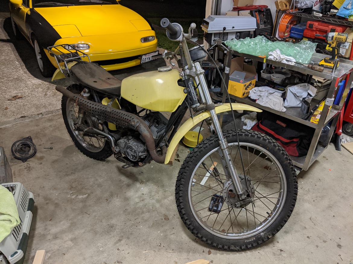

While it's uglier, the mechanical lookout is a lot rosier for this one. I ended up drilling out some rivets to liberate a flywheel center section from an outer, which helped me set the timing, since I have 0 experience with points. Once that happened, we got here
So yeah. Felt good about that, despite the lack of killswitch and throttle stuck wide open, combined with me closing the petcock leading to a few more revs than was probably wise. I really wasn't expecting it to actually fire.
