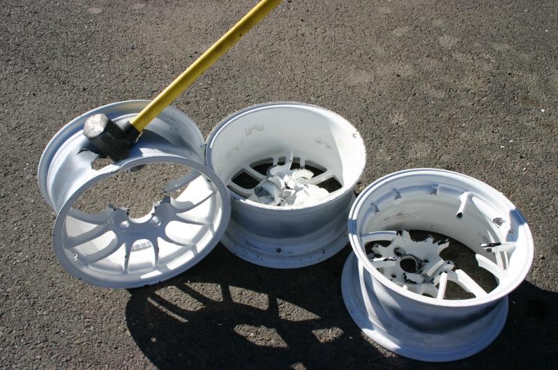

3/24/22 1:12 p.m.
Powdercoaters always claim lots of success with aluminum wheels. Meanwhile, some wheel manufacturers will void the warranty if their wheels are powdercoated.  Why?
It's the temperature range. Powdercoating ovens are in the temperature range used to age aluminum, so if you powdercoat a 6061-T6 wheel you can find yourself over-aging the alloy and thus set yourself up for a wheel failure. I once destroyed a set of new race wheels after having them coated because I was not aware of this, and I was not willing to take the chance of a wheel failure which would potentially result in a major accident. When you're doing 125 mph down a rally stage with a rough surface and forests on each side, it's an easy decision.
This is likely only a problem on wheels that are not running a lot of margin, like lightweight race wheels that will be highly stressed. An OE wheel being used on something like a T-bird where weight was not a factor, less likely to be an issue. That's the sort of material powdercoaters deal with all the time, completely over-specified hardware. But the correct solution is always to paint, not powder because there is absolutely no benefit to powder and there are legitimate downsides. The side benefit of paint is that it's easy to match colors.
I don't think any OE wheels are powdercoated, they're all painted.
