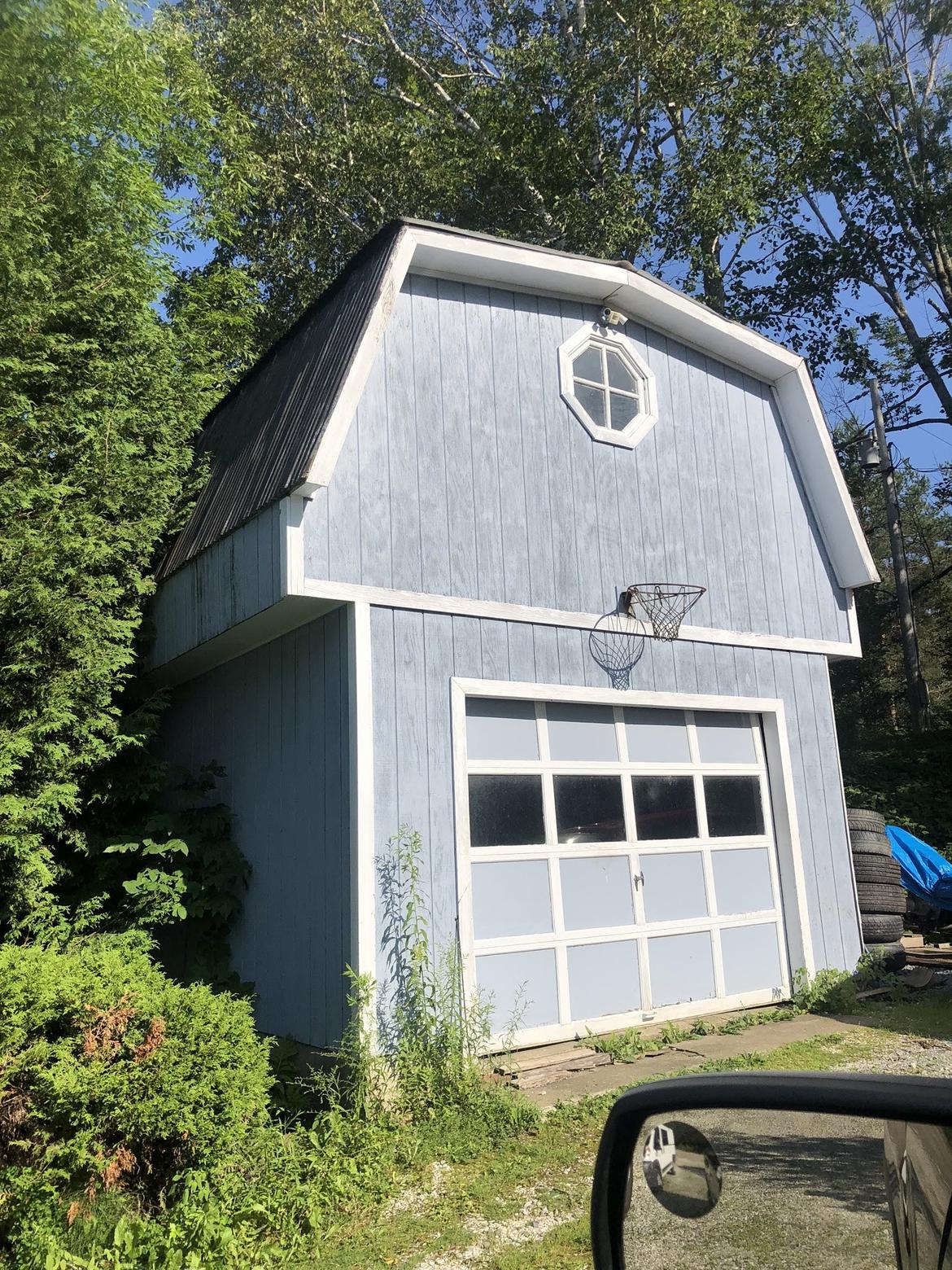

Anyway onto the pics and build. The single car garage I have was starting to get bad. The roof had been infiltrated by varmints. There was rot and bad wood. And I needed more covered space. I can't even see my Vette any more. (I broke the cardinal rule of not making the car a shelf)
This is panoramic of the upstairs. That window didn't close anymore and the roof was full of critter nastiness. Walls were heavily stained from weather and other fluids. Respirator was my best friend here.

The best and only before shot. The offending parts are on the other side to the right.

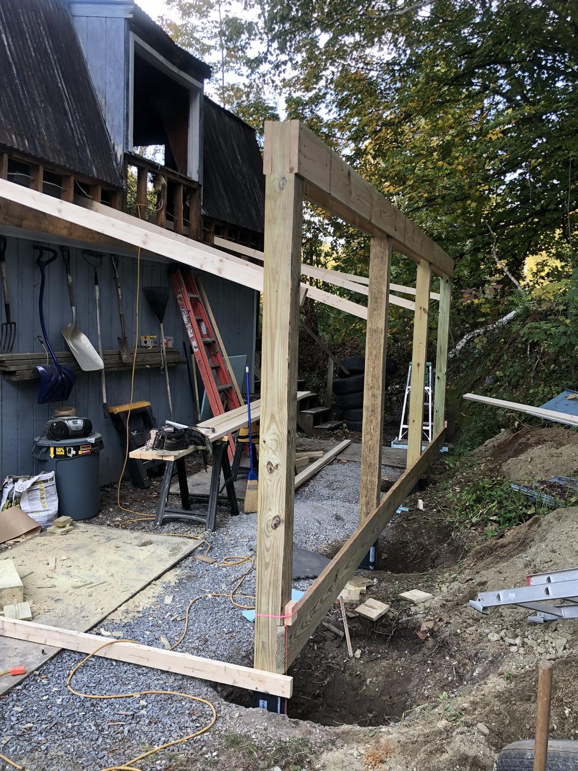

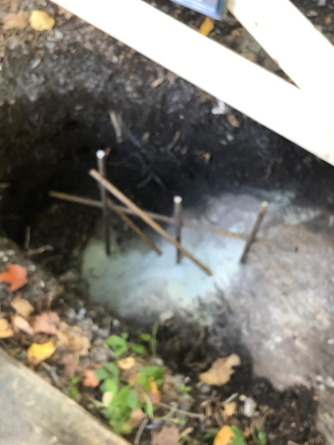

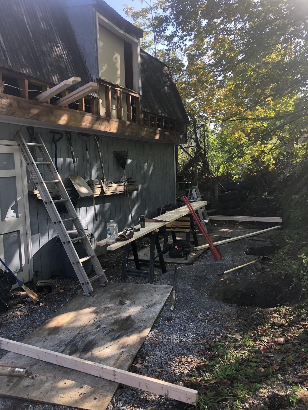

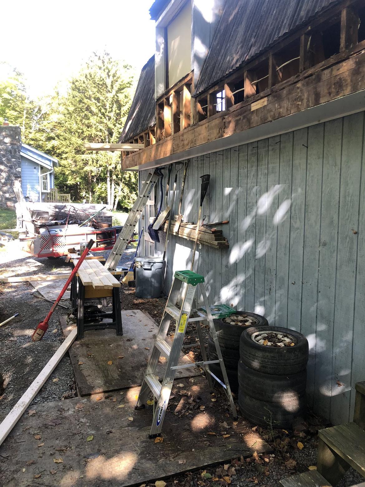

Original plan was to remove everything above the first floor on the window side and create a new roof from the peak to a point 10 feet from the garage side for the car port. After some staring and thinking decided to leave most of the roof and create a knee wall one foot inside on the second floor and span the space from there. I'll post pics but having trouble with my tablet.

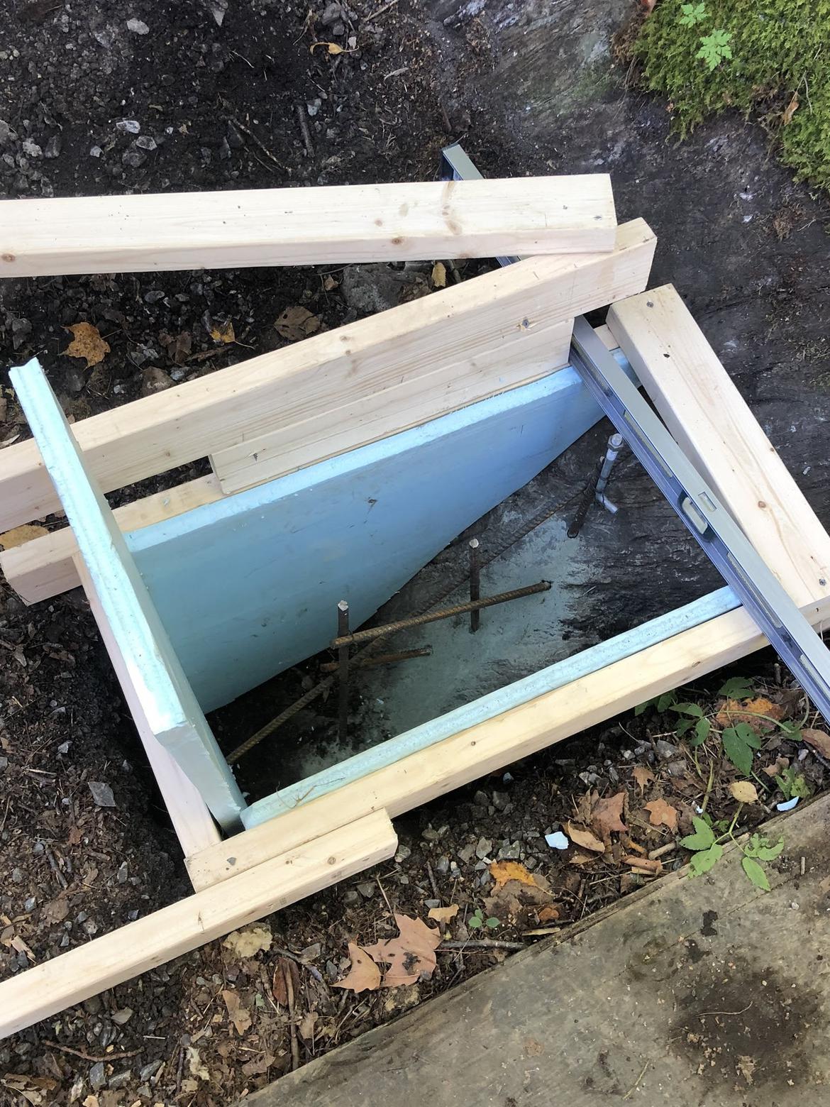

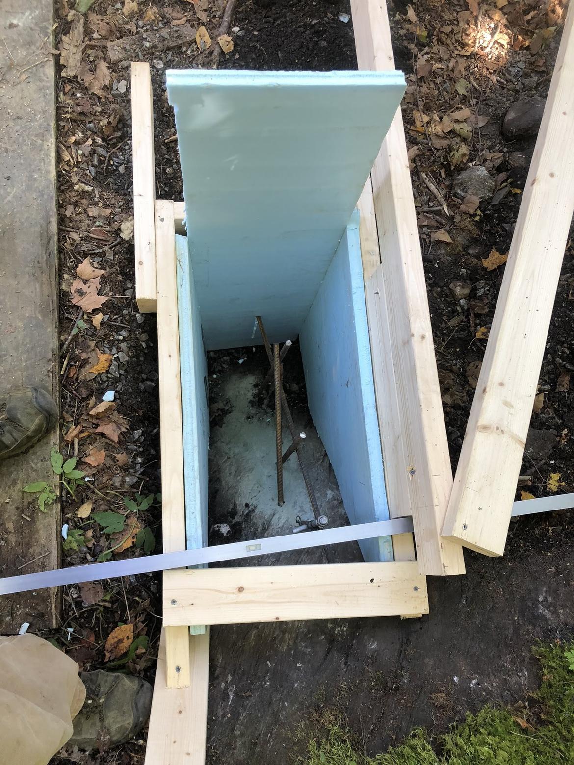

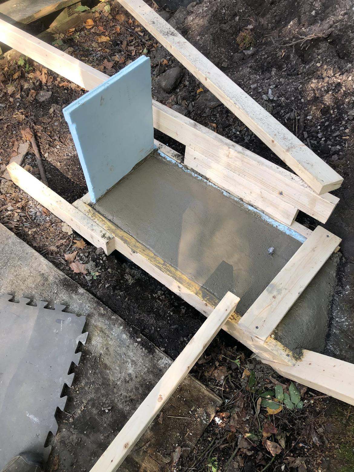

So me, my wife, and a couple of friends tore apart the upstairs while my builder got to digging some holes for the posts that would become the wall of the carport. The last post would prove a challenge as there's ledge all over my property and it intruded on the space the post needed to go. I think Dan came up with a great solution. Create a form and anchor a concrete base to it.

11/8/19 7:47 p.m.
Cool things happening.
Dan's a spry 60 year old. Dug those holes by himself after deciding the room for a mini backhoe wasn't there and the cost would be too much.

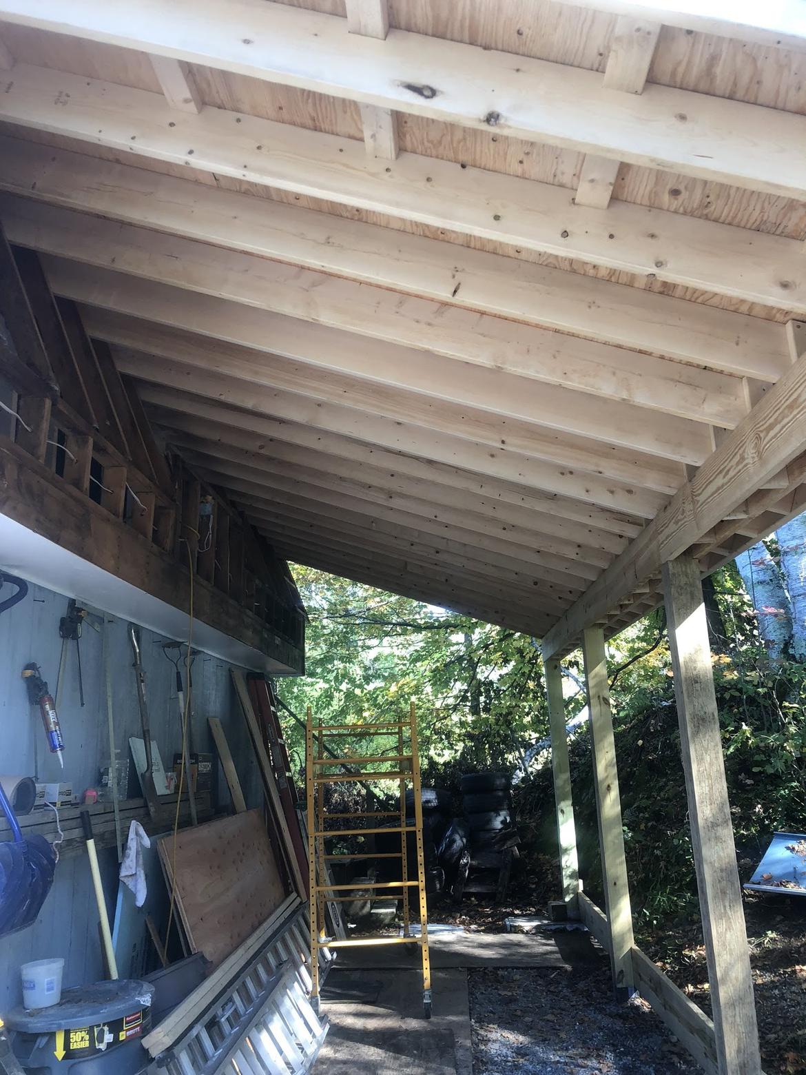

Roof of the car port. Unfinished outer wall.

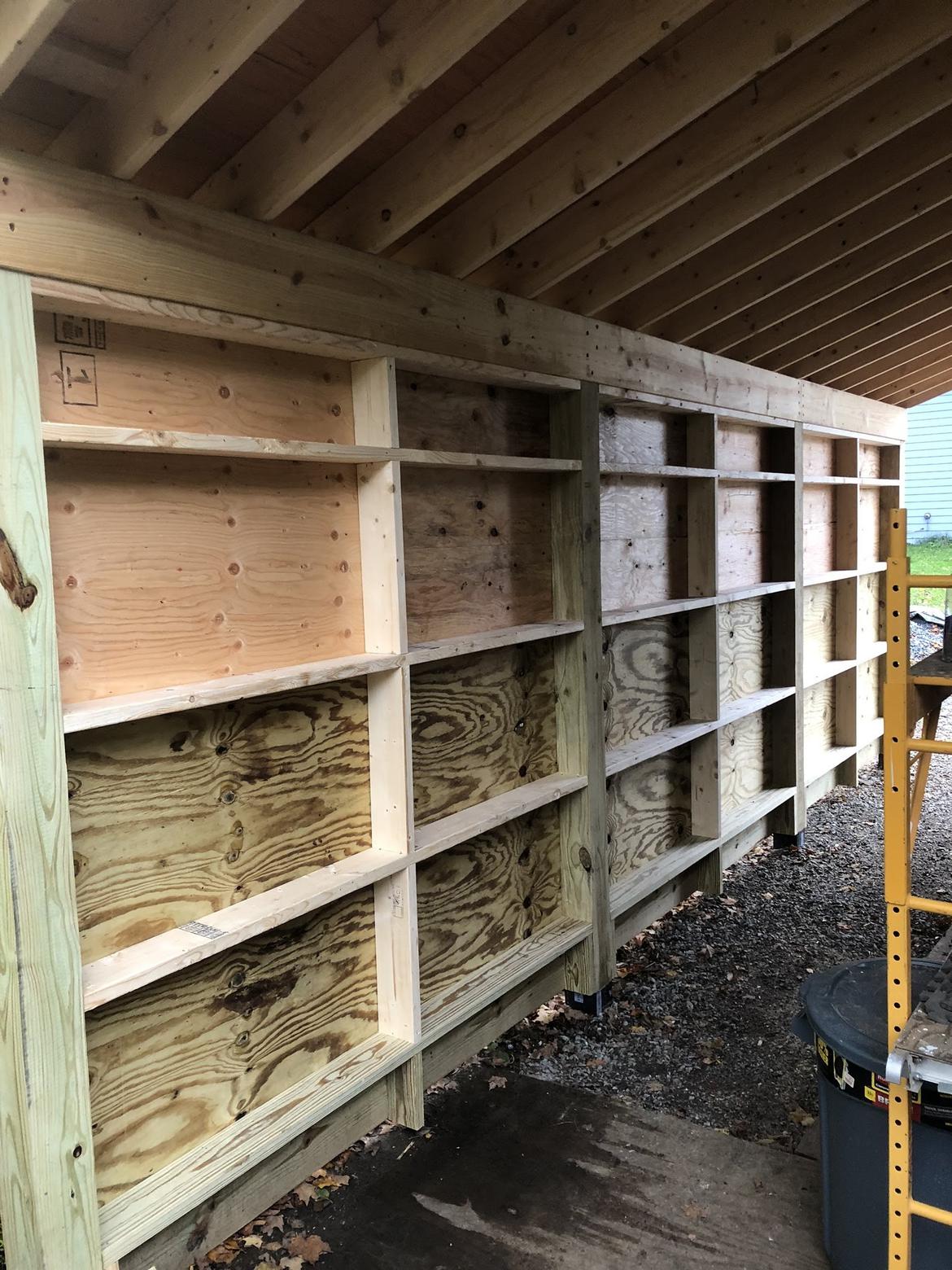

Finished carport wall. Lots of storage on them "shelves."
