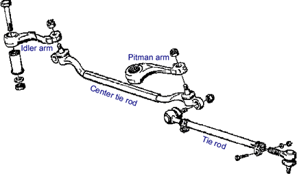

In reply to MTechnically :
While I was under there, it appears as though I need an Idler Arm, so I'm going to get that one coming.  Also, the rear is looking a bit squatty, so it could probably use rear struts, but I'm going to procrastinate on that for now.
