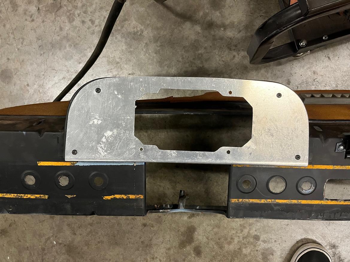

I've been hem hawing about how I want to mount the Powertune dash. I've made a template in preparation with some idea of what it will look like.
Well here's v1 made out of some aluminum I had laying around. I think I'll do the next one in steel and move it down a 1/4 or more. For now though I think this will work as I have bigger fish to sauté. What you see here needs to be drilled for mounting holes and move some on the dash structure since the stock upper holes share the same space as the dash screen.
You can see the dash pad lip on the left side is a little droopy. I imagine in the car it won't look so terrible so the next step will be to mock it all up with a driver's seat and see if it is ready for the big time or needs tweaked.
I wish it was sunk in more. Maybe a 3d printer could do the trick so it doesn't look like a screen stuck to a flat piece of metal? I'm not familiar with software requirements to design one but maybe someone out there in the GRM world is?

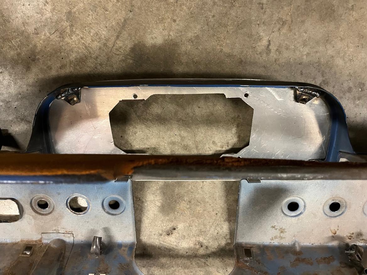

I couldn't end the evening without getting the panel to mount to the dash. Since two of the inboard tabs share the same space as the Powertune I cut them off with plans to move them further out.
A little choppy.
I burned them in place after getting all the holes planned out and drilled.
With the dash cap back on and the Powertune loosely fitted.
V1 turned out pretty decent. I'll do something to texturize the metal with a satin or matte black. Maybe glue some ABS sheet to the front?

I agree. If you cant sink the screen into the surface, do something to bring the surface up to the screen. Piece of wood with surface coating of your choice would be the ea$iest path.
captainawesome
captainawesome SuperDork
4/16/25 11:41 a.m.
In reply to NOHOME :
Agreed. That may be the path forward with v1 until I make a v2 out of steel. Another option to sink it flush would be to rivet a bracket on the back side to hold it in place. With a trim piece over the face it would cover my rivet sins completely. Hmmmm.
Edit: I just spoke with an employee that has a 3d printer but is also capable of design work. I'm bringing what I have up to the office tomorrow to have him sort out a cover for me. Based on our discussion I think he can get something that fulfills my needs in the short term. If his design is up to snuff, the part he prints won't hold up to heat well and may have to be in two pieces. In the end I should end up with a file that can be printed with better filament and in one piece if the design works out.
