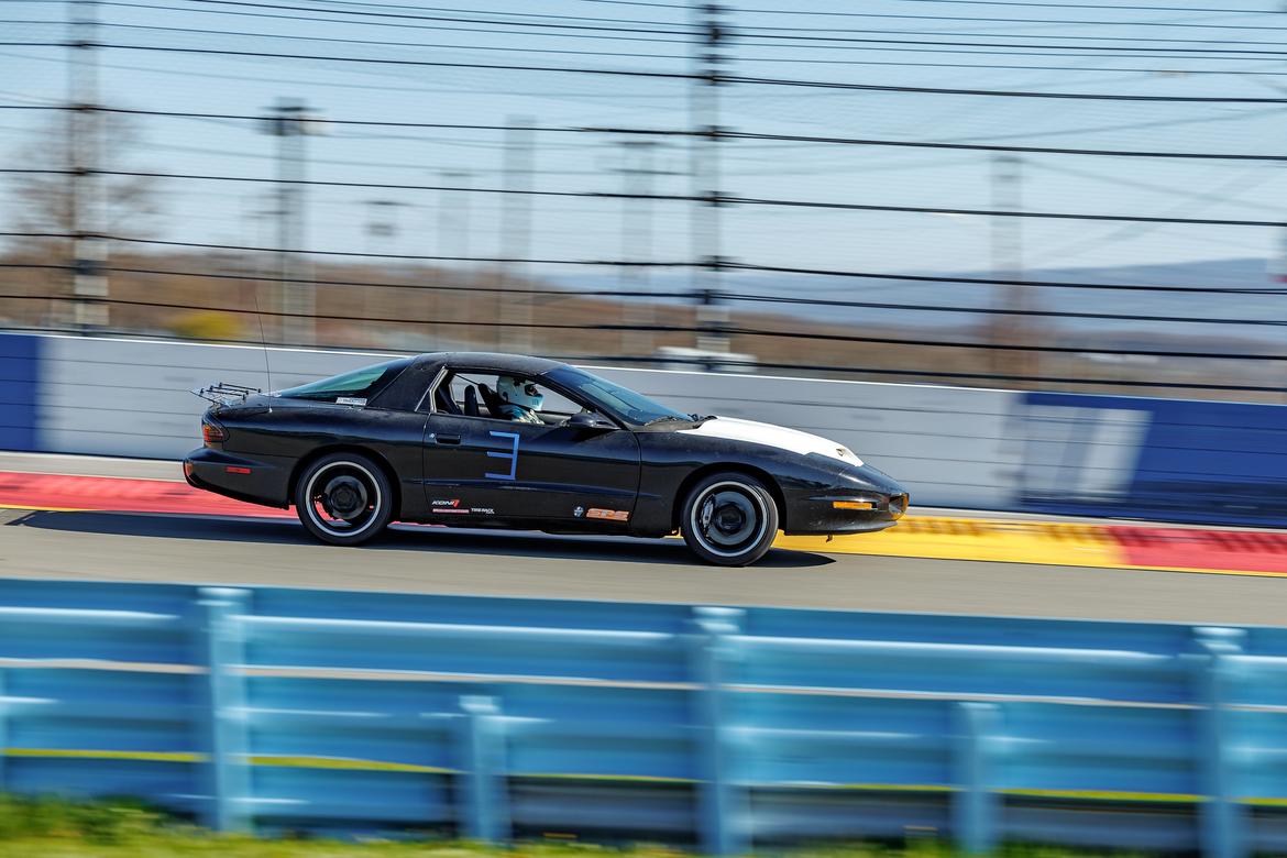

Got the car back together just in time. The T56 went back in OK, I swapped in a new Summit driveshaft that's apparently made by Sonnax, oil pan went in after some clearancing for the steering rack/knock sensor, and the Belmetric tube nuts ended up being perfect. I also went to swap out my rotors since the heat checking was getting pretty bad, but I noticed that a corner on one of my Raybestos ST-43s was missing. The pads only had about 6mm left, so I decided to retire them and get replacements only to find that ST-43s are backordered and/or likely discontinued. I decided to try out EBC's SR-11 pad which is supposed to be similar... or so I read.
I had the car at NJMP Lightning for a TNIA last Wednesday to brush the rust off. Things were going OK, but I noticed I kept having issues getting into 3rd. It ended up being the Tremec shift boot I stretched over my Pro 5.0 shifter getting caught between the stick and shifter stops. I ripped it off in the paddock and everything was great after that! I managed to run 0.04s off last year's PB with a 1:16.18 so I considered myself fully warmed up.
I threw myself right into the fire by driving up to Watkins Glen for an event 2 days later. This was a totally new track to me and I was pretty terrified overall. Car did alright aside from some pretty gnarly brake fade 15mins into each 30min session, so I guess my next project will be brake cooling. I'm unsure if this is the fault of the SR-11s or not since I think the ST-43s would've faded just as quickly. I managed to run a 2:15.9 despite this and almost got a low 15 if not for the Miata lol. Lots of room for improvement so I'll have to come back later in the year.

The Glen is notoriously hard on brakes, some cooling will definitely do you some good.
What group did you run with there?
What did you think of the entry to the bus stop? It's different this year.

Yeah, I don't wanna blame the pads since I'm guessing some form of cooling becomes a necessity at my power/weight/grip level. Part of me wants to shotgun DTC-60s onto the car, but another part knows that reducing temps overall will be better for my hubs, rotors, and calipers in the long run. I was going to rig up a deflector style setup like the OEs use nowadays since it's unbelievably cramped in front of the lower A-arm.
The event was a MassTuning HPDE. Really love the group!
I'm guessing the new bus stop is slower than before? I was getting pretty close to the pyramids and hopping the 2nd curbing, but it seems like the angle of attack is much greater than before where you could basically make a straight line through curbs 1 and 2. I never drove on the old setup so I can't really say.

Here are some more pics from The Glen. Out here doin' it for Dale!
I forgot to adjust the spoiler angle for the 1st session so that's why the angle is different in some of the photos. I was wondering why the car felt so loose through the esses lol.
