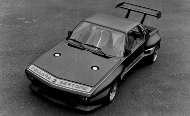

I'm kind of polluting this thread with stuff that's not actually building. I apologize, but I'm dropping inspiration and details for the build, also, just neat stuff like the concept car:
and pictures I simply like:
History of the X1/9
Pictures to help with suspension design (Thanks, Robbie, et al):
Stuff that's just plain cool:
