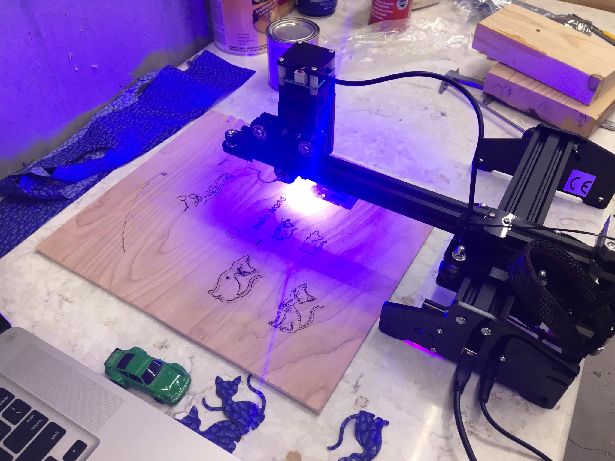

The engraver in question is an Ortur Laser Master 15W, which has a 4500 mW laser and is perpetually on sale from Gearbest. It took forever to ship out, possibly due to the Chinese new year. When it did ship, you could almost hear the sonic boom as it went from Hong Kong to a little Colorado town in about 72 hours.
I don't have a Windows laptop at home, so first step was to make it work with a Mac. Had to fiddle around a little bit to do a firmware upgrade to the engraver, but after a bit of time I got it fired up and recognized by Lightburn, the software I was planning to use. A little more fiddling to learn the software and it was burnin' time.
I had designed a little sugar skull cat for my wife's embroidery machine, so I used that for testing. Here it is at just under 2.5" high. I'm still playing with the speed and laser power - you can scale it from 0-100% and the speed can go as high as 9000 mm/minute.

Overall, build quality seems quite solid. It even came with zipties and brackets for wire management. There's no wobble or slop in the mechanism, and running a second pass shows that it's very consistent.
A set of laser goggles came with it, but I also purchased a good set before the engraver got here just in case.
I'm thinking of making a base for it so I can bolt it down. When it's running in full boogie mode, I can see how it might jump a bit and screw up the alignment. I'd also mark the origin on the base. You can tell the laser to go to a particular place on the layout and then turn it on a low intensity so you can confirm alignment, which is useful. I'm using 1%.
