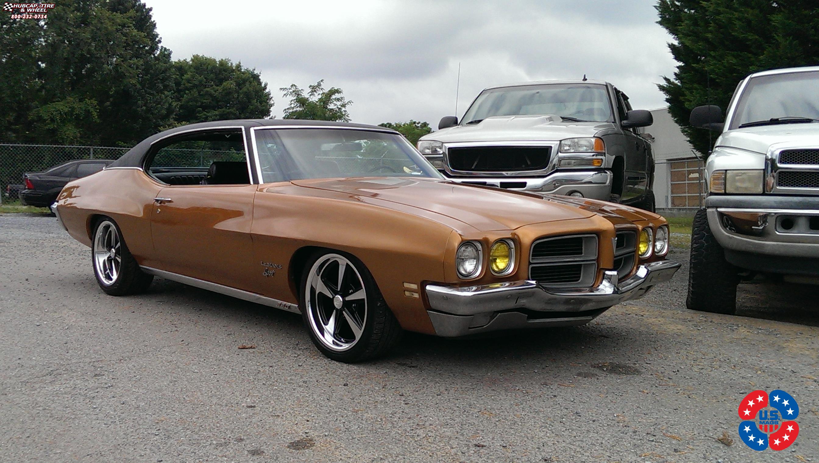

Beautiful car.. thou personally not a fan of the wheels. To me it takes away from the overall "look"..
Do you plan to keep it stock-ish or go more restomod?

I also dont love the wheels, but SWMBO does, and so, there we are. Personally, Id like something more akin to Torque Thrust or Cragars. Ive also seen some US Mag wheels that look pretty sweet and appear to be modernized versions of throwback styles - I like the Bandit
