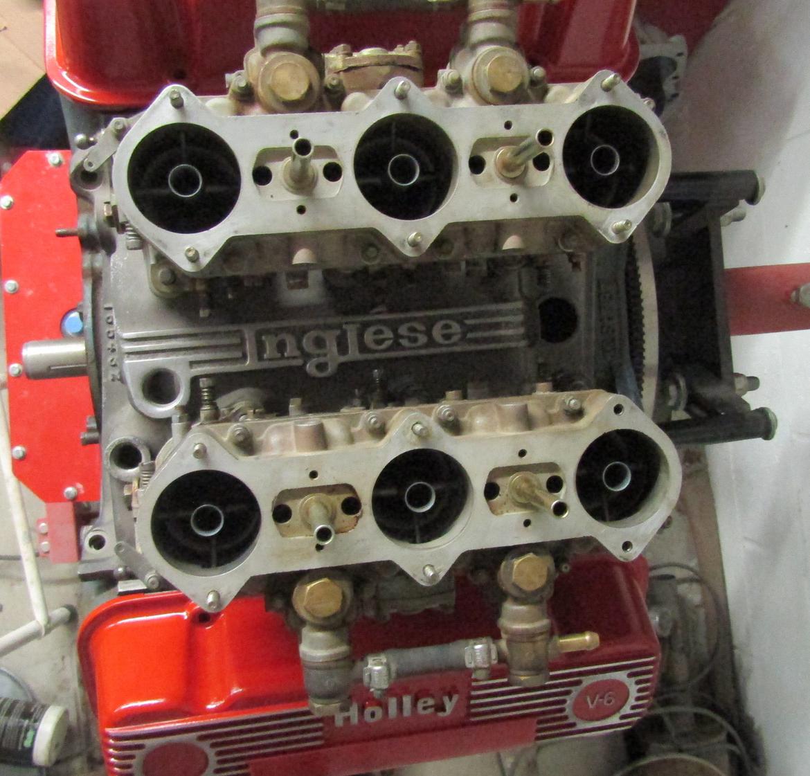

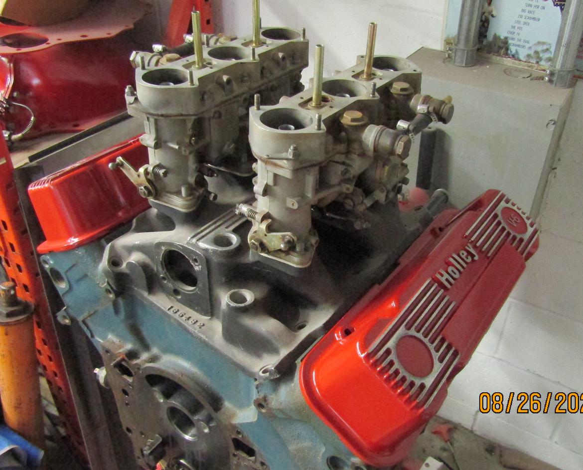

I'm guessing you've abandoned all hope of keeping the stock GT6 hoodline?  ;)
Ian F (Forum Supporter)
8/26/20 10:27 p.m.
In reply to clshore :
For that intake, I'd cut off the GT6 hood bump and replace it with a Ferrari-esque clear plastic bubble.

If you still have the original 6, you can probably take some comparison measurements - the bonnet bump is there for a reason and is only as tall/wide as it needs to be to clear the front of the OE engine. But assuming the shorter engine will be farther back in the chassis, you may be ok.  Hell - you might even be able to use a Spitfire bonnet.  That would really confuse people.  Or if you do have to go with the "bubble option" starting with a Spitfire bonnet would probably make for cleaner lines. Showing off those carbs would be cool.

Sure! You could aim baby spotlights from the top of each windshield pillar, or place LED lights under the hood!
Fit some clear pyrex valve covers, and synch strobe lights to the crank so that the valve train could be 'frozen',
maybe have a 'phase' knob to make the parts appear to slowly move.
Would look great with anodized roller rockers.
The Bedardatron lives!!!
OK, OK, I'm not a hater, just having a little fun. I'd want to show off that setup too.
I actually love where this build is going, I have followed it from the start, glad to see it's still alive and kicking.
