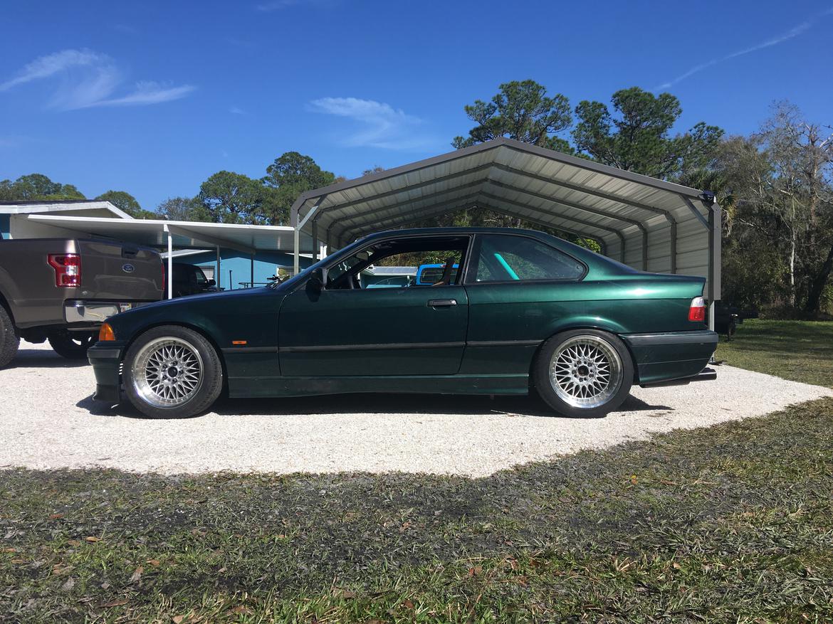

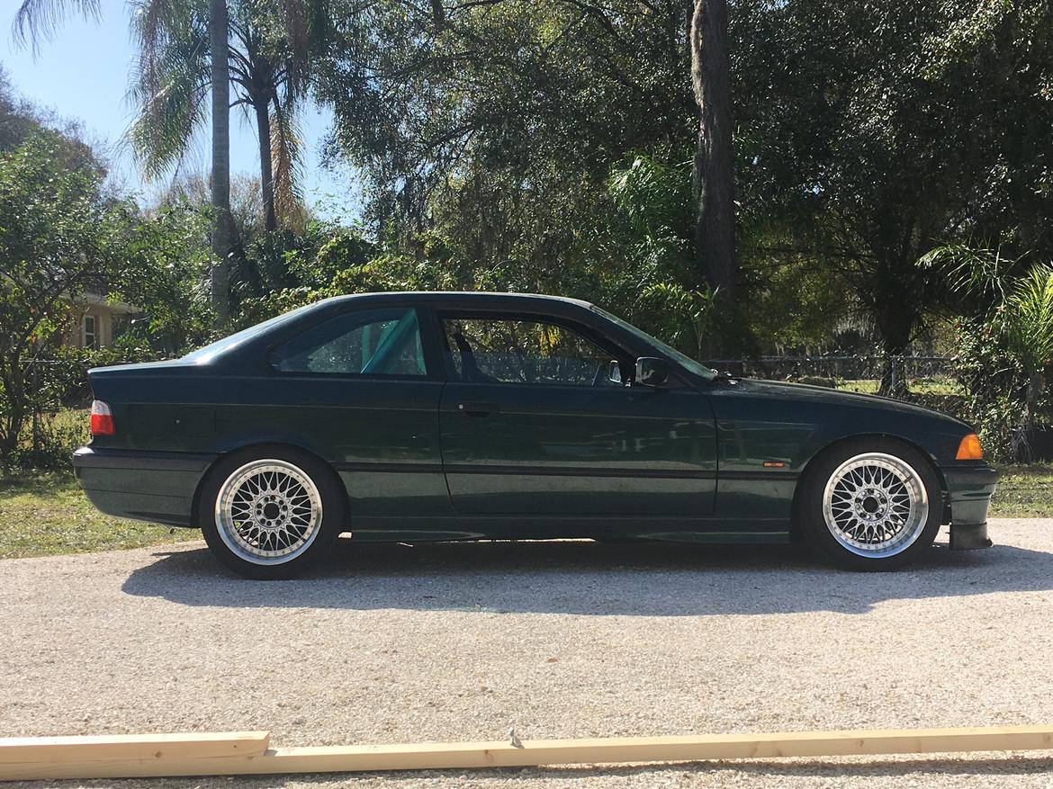

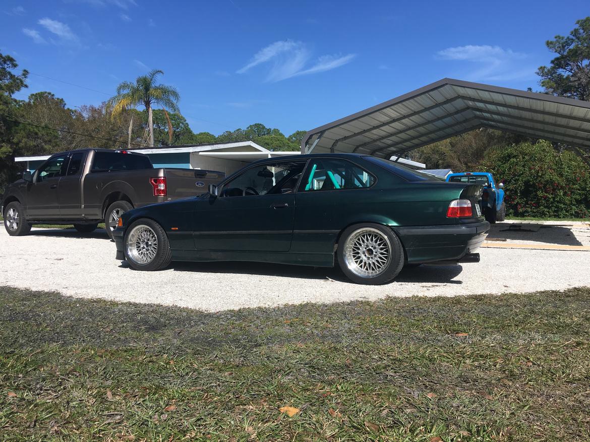

Ground controls are on in the rear now too!  I also dialed the brake bias more frontward and I’m getting happier with the boosterless system. Hopefully some EBC yellow pads all around get it feeling perfect.
Next step is an alignment. Then I can start tearing into the m3 subframe and diff laying in the garage and get it ready to go in.
