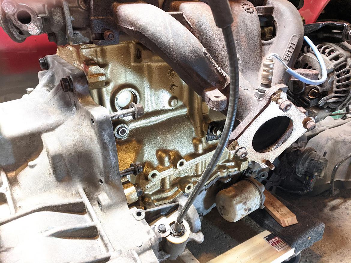

I fit the trans to the engine today.  Rampage starter interferes with the exhaust manifold, maybe the block too.  There's a smaller starter available (Nippondenso versus Bosch I believe) so need to figure that out next.

Three out of four bolts trans mounting bolts line up, and here's where the starter needs to fit.  I ordered one of the smaller ones and should have it this week.  The oil pressure sensor is in the way on the back of the block, so I put a plug in there and plan to move the sensor to an oil port in the back of the head.  I did have all the heat shields on the manifold, and I'm hoping I can still fit those back on.
And here's the one that doesn't line up.  The Rampage front engine mount uses the two trans bolt holes here plus two on the engine, so I will rework that bracket to use the two engine holes I have available and make it wedge up against that ear sticking off the block.
