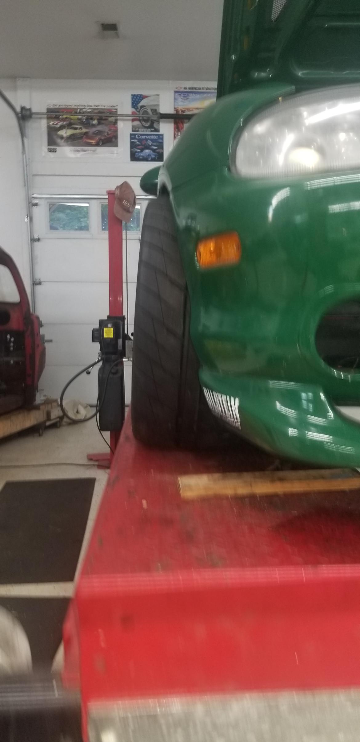

Dusterbd13-michael
Dusterbd13-michael MegaDork
9/9/21 6:19 p.m.
Stampie
Stampie MegaDork
9/9/21 6:23 p.m.
Box flares?

Am I weird for thinking that wheel/tire/car package looks cool from here?  I don't know if I'd mess with flairs yet when the combination isn't 100% settled on anyway unless it's a track requirement.
Dusterbd13-michael
9/10/21 9:00 a.m.
In reply to pres589 (djronnebaum) :
Nope. I really dig it too. If it doesn't rub, im going to run it just the way it is!
Dusterbd13-michael
9/10/21 6:54 p.m.
It rubs multiple places at rest while cycling the steering. No way it will clear and be functional. Dammit.
