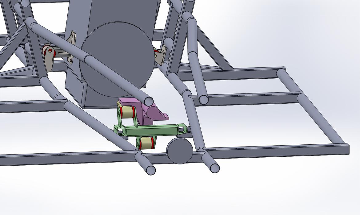

I've been excruciating for way too long on a transmission mount.  The connection to the NC 6 spd is a little weird, and I want to make sure assembly is reasonable.  Here's what I came up with:
A little hard to get a good screen shot with the frame in the way.  I'm using the same Energy Suspension universal mounts as on the engine.
Another view from below:
Fab starts in the new few days as I have time.
