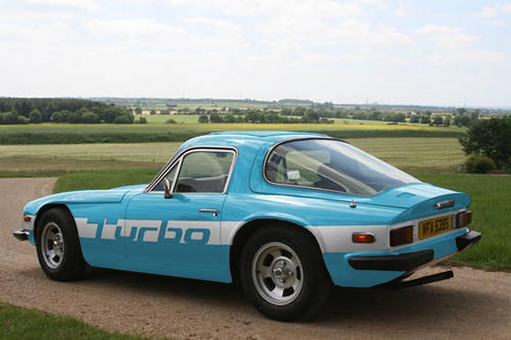

I would be inclined to pick a more vintage color rather than modern, maybe :

In reply to coexist :
I've debated that too.  The car is an interesting age - not old enough to really do justice to a vintage color.  These came in some pretty loud colors right from the factory.  Also some sedate ones.  Evidently my car came originally in Burgundy - probably similar to the one you show there.  I've been reading the Resto-Mod thread, and paint colors, new and old, would certainly be a topic there.
And since it was the 70's you get some browns and tans too:
