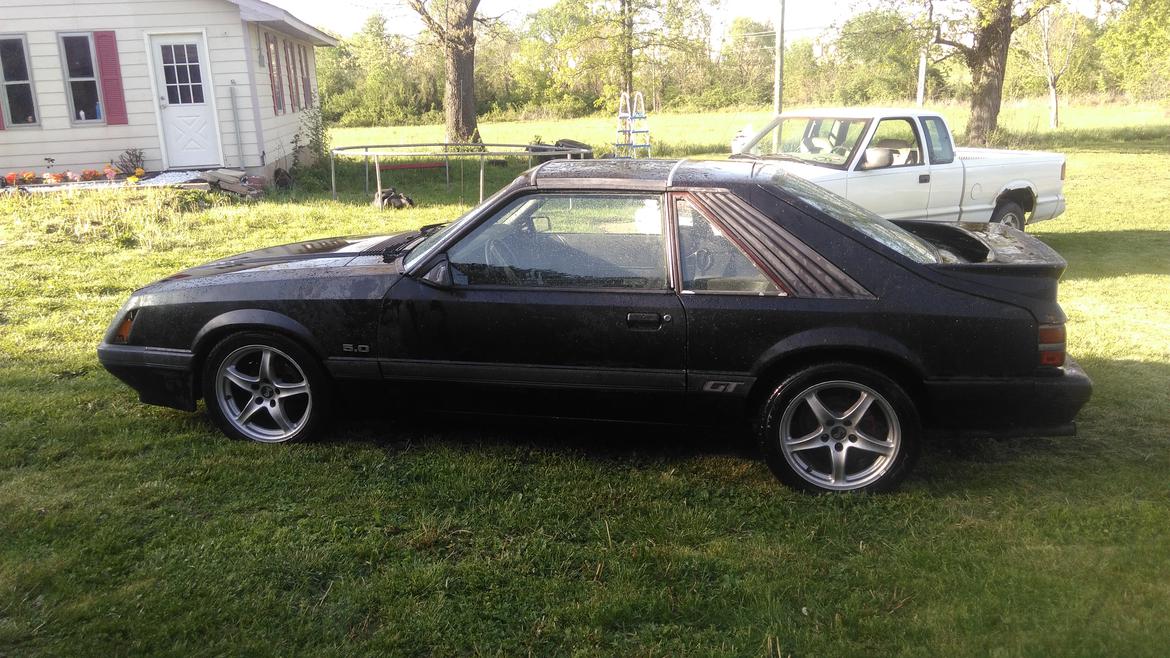

Here is my 89 with SN95 booster and M/C. Im running 99-04 PBR GT front calipers and, SN95 rear brakes
and my rear wheel fit with SN95 axles and 275/45r17 on all four corners lowered 2"

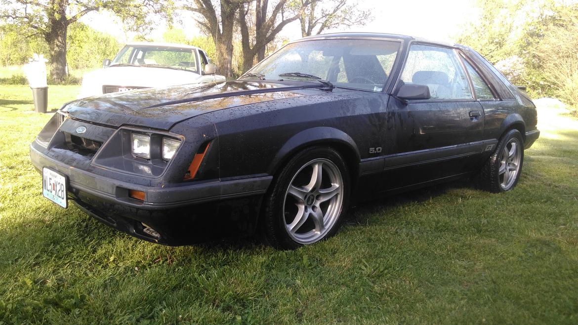

Need to toss in the springs and put on the shocks.... Oh, and the sway bar!

So  was going to paint everything the same color, but my bro n law says the different color provide good contrast... I think he might be right. What should I do? Thoughts?
ClemSparks
ClemSparks PowerDork
4/21/18 10:27 p.m.
Are you talking about a paint job for the body?  Or are you talking about the suspension components like silver control arms and orange shocks and blue springs?
I think it's your car and you should do what you want ;).
On my car I am glad, however that my new rear lower control arms are black and my springs came in black.  I still have red shocks and struts.  I thought about painting them black...but I didn't

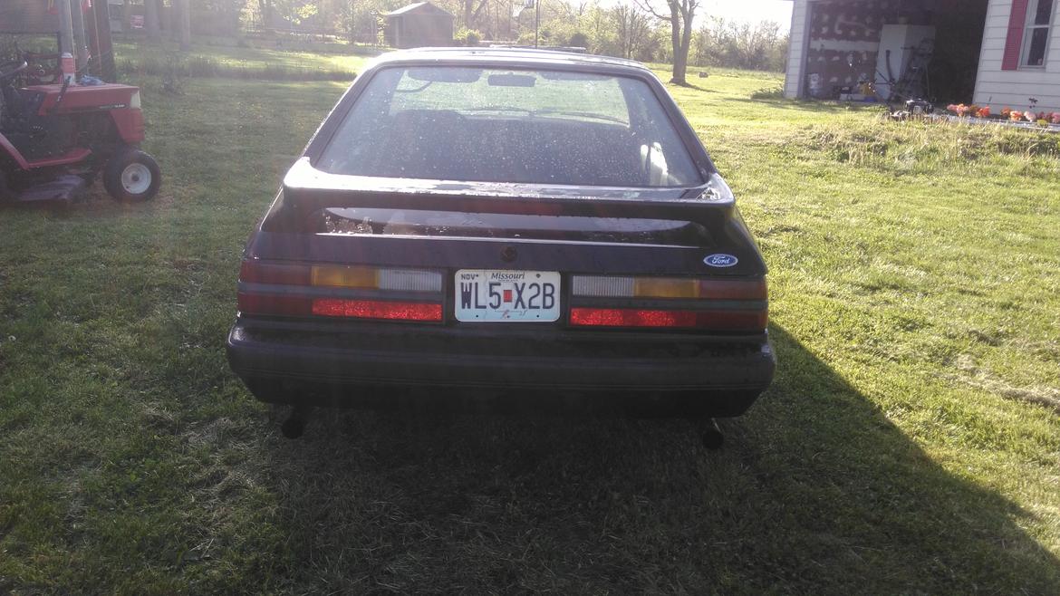

Just a word of warning about the SN95 rear end and its added width.  I mentioned that I haven't had any problems with mine.  That was the case with motorsport c springs and stock rear suspension components.
Well today I got it out for the first time this year after putting on the MM adjustable rear lower control arms.  With the rear setting low the tires will rub on the fender lip.  I'm either going to have to raise it back up and/or roll my fenders.  I sure wish I had a fox width rear right now ;)

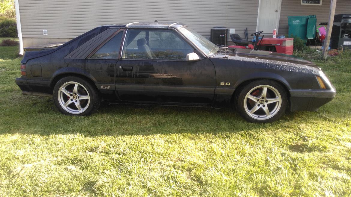

The new spring isolators I got from lmr fit really loose and I couldn't get the bottom of the spring to sit in the perch while jacking it up. Spent over an hour trying to get it to work. Finally got mad and took the isolators off and the springs went right in. 30 bucks wasted. Now it's going to have a slight rake, so I might pull the rear isolators off to.
Got one side done, I guess I lost one of the strut spacers that came with the caster chamber plates so I got mad and stopped for tonight. Should only take 30 mins to button it up.
I'm so over working on this thing for a while. I'm going to finish up the suspension and toss the seats and carpet in and run up and get it inspected... Then I'm just going to drive it for a few weeks.
I totally forget about the broken wheel stud until after I bolted the spindle into place. Err.
Set the tires on, they're not bolted down. The suspension not load bearing in front, but is load bearing in the rear. I think the front while sit perfect. Probably going to remove the isos in the rear for more low.

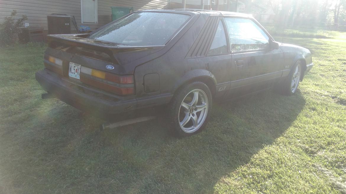

Drove the car for the first time in months. Got it done, but nobody was there to help me bleed the brakes, so they aren't functional just yet. I live just a few house down from my sister's (where the garage is), so i went ahead and drove it home anyways. Now I just need to bleed the brakes and get the front end aligned... And change the mid pipe.

Those are my favorite variant of Cobra wheels, and they look great on your car!
ClemSparks
5/6/18 8:43 a.m.
Yeah...it's looking really good.  I like those wheels, too.  And that '85-'86 front bumper cover is about my favorite, I think.  The car is sitting well.  If you ever make it up here to Columbia, we'll drive up some twisty roads together and confuse people.
