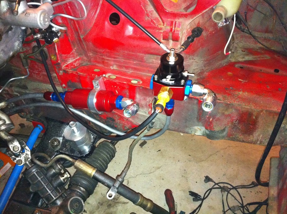

Fuel upgrades:

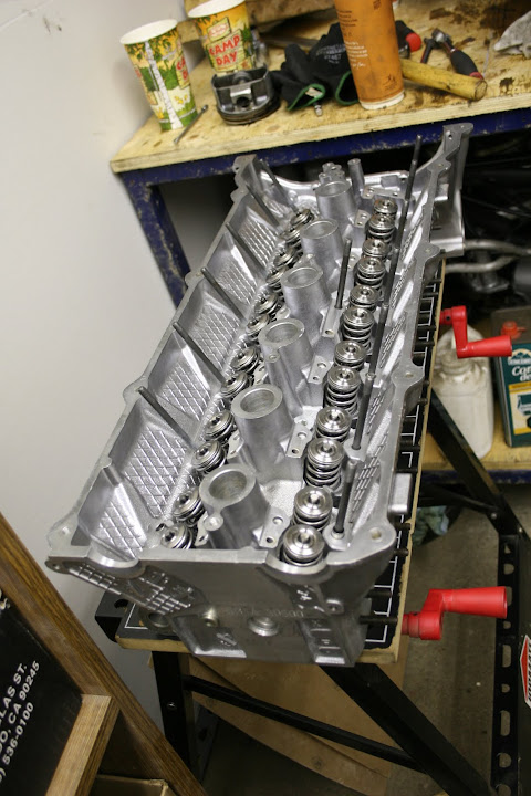

Head built, supertech valves with oversize intake and inconel exhaust:

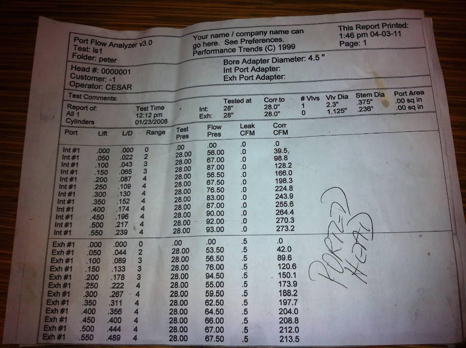

Head porting paid off handsomely. Before:
After:

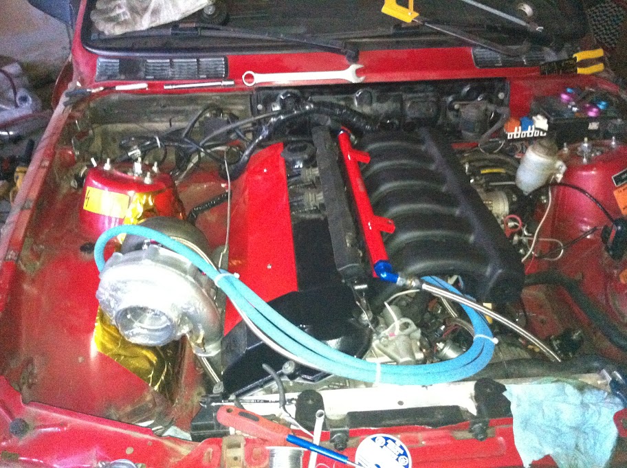

Getting there... almost ready for exhaust work:
Ready for tuning...
