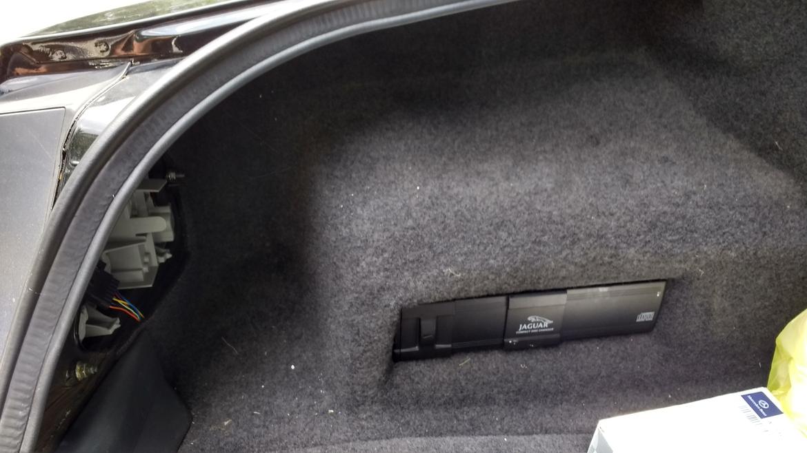

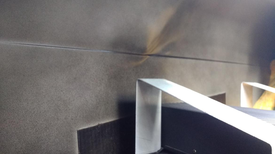

I got the cat up in the air tonight for some inspection.  Transmission pan is all wet. Probably the pan gasket (I hope).
And while I was under there, I grabbed a few pics of the cut outs:

the cutouts are awesome

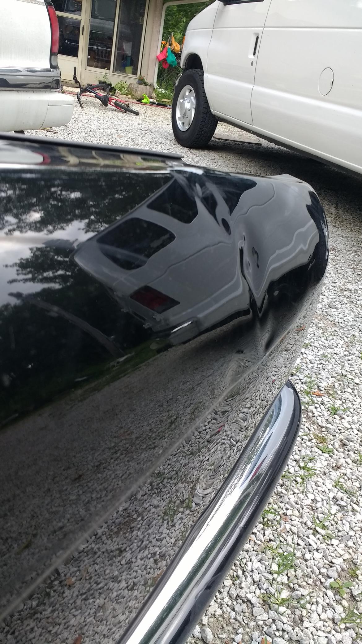

I got it all buttoned up and filled with fluid. I went with Valvoline MaxLife because Amazon sucks and didn't deliver the Shell ATF 134 I ordered in time. (it was supposed to be delivered next day, and three days later, it STILL didn't arrive) because this is my driver, I needed it to go to Patrick's build party 4+ hours away. Seems ad though I've fixed the leak.yes (note to self for records, Odometer reading of 82,307)
It's hot here in Indiana today, so I parked the car for maximum sun exposure to the dented rear quarter.

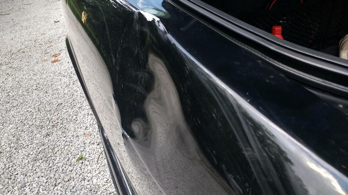

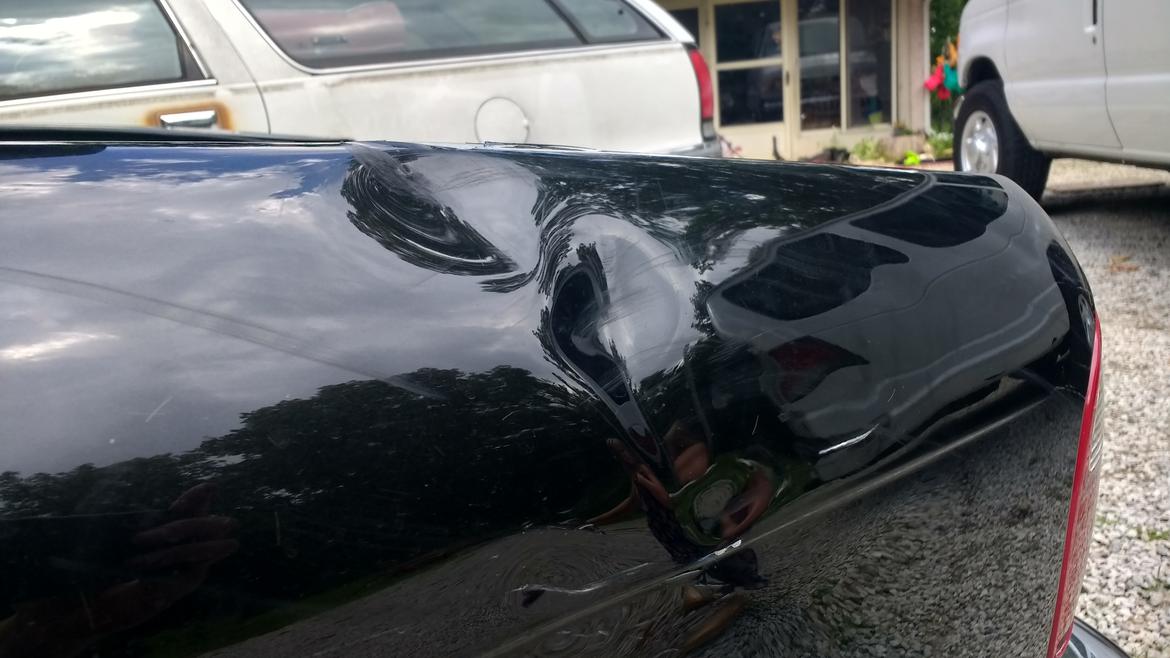

Let it heat up as much as possible, pulled the interior carpet and proceed to attempt to push it out. (Metal is single layer in this area)
Shrug.
It's not pushed in as much, so I guess it's better, but I wish I had the budget room to have a professional Paintless Dent Repair guy do it right. Stickers will hide this area for the challenge.

Remove that stereo equipment and keep tapping at it with a hammer.
