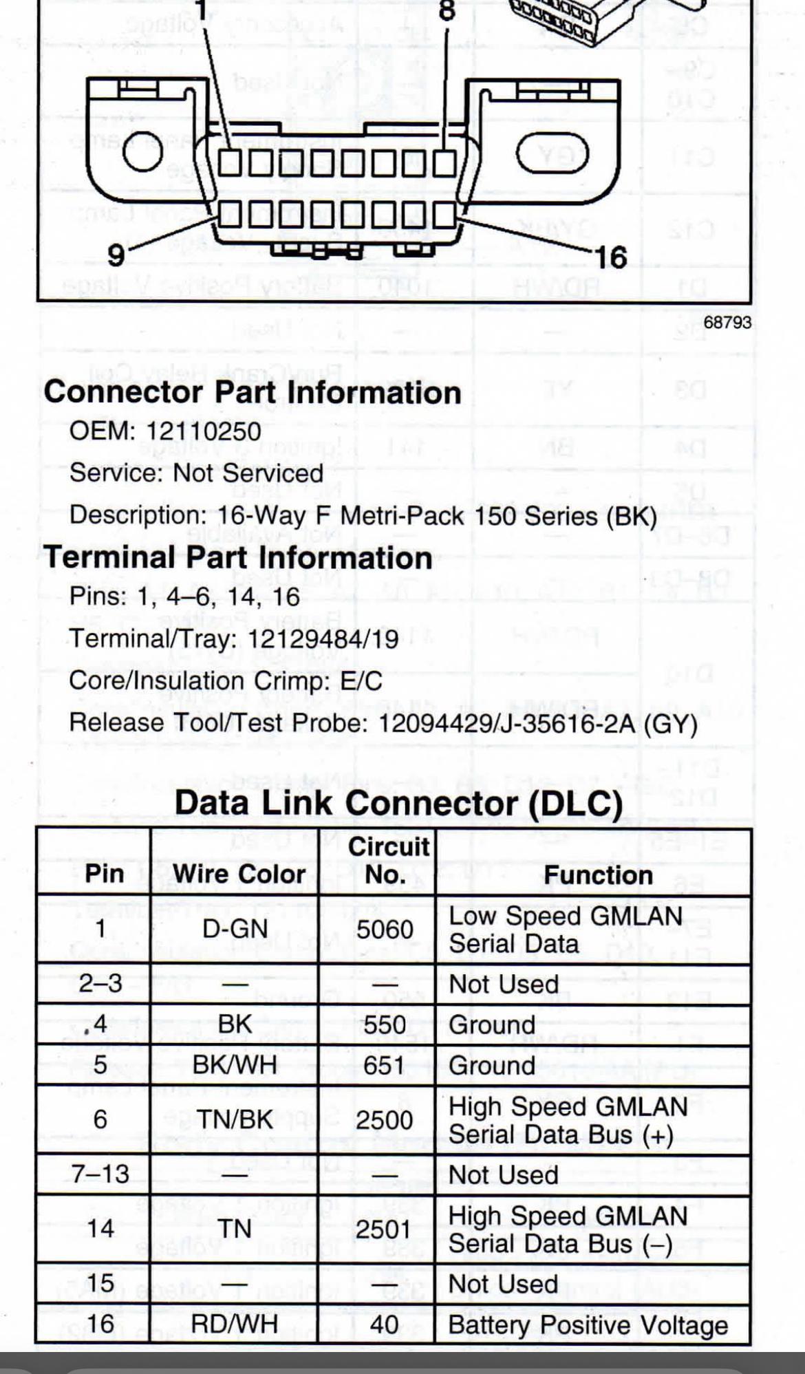

Next connections are the serial data wires. Tan and tan with black stripe. They go from the ecu connector to the bcm j2 connector. I hope this will let the bcm tell the ecu to turn on the starter.
Next step is to figure out the clutch safety switch and where it gets wired to. I think this is it.
After that I need to figure out where the accelator pedal wires in then I think I will be able to see if I can get it to crank.

I am guessing I have my tan and tan with black stripe data GMLAN wires messed up somewhere.
I found someone building a df goblin with the cobalt SS lnf (their notes copied and pasted below) for the GMLAN can you skip sensor's along the way as long as the start and finish are correct?
Also is there a way to look up a vin off of a ecu to see if the donor ecu thinks it is a manual or auto? I have an ecu but I don't know what the vin of the vehicle it came from is.
After some help from a nice guy (Tim) on a solstice Facebook group I think I should finally have my GMlan Data wires correctly wired up. I am just missing a 120ohm resistor in the wiring at the obd2 connector.
I still have no connection from the ecm to the obd2 plug so hp tuners can read it.
I am trying to reduce it down to the simplest form to figure it out.
I have the data wires hooked up (minus one resistor for now.
I have 12v to the ecu, bcm, and odb2 connector.
I have the bcm, and the obd2 grounded.
My next steps are to try to see how the ecu should be grounded and wire in the 120ohm resistor.
