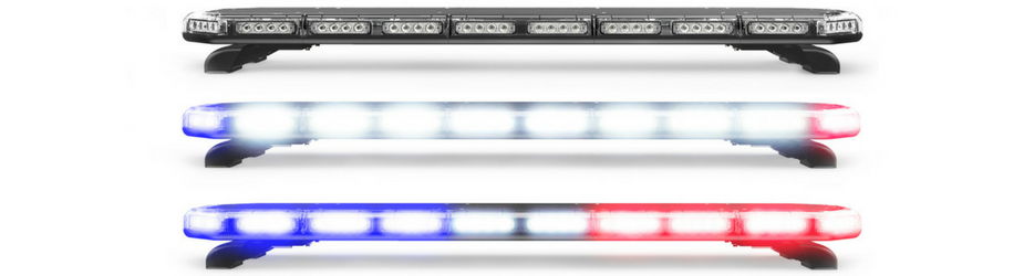

GTXVette
GTXVette SuperDork
10/31/18 2:26 p.m.
APD Found a bunch of the overhead lights in the Dumpster at their maint. facility,  Heads rolled  not legal to have here.
