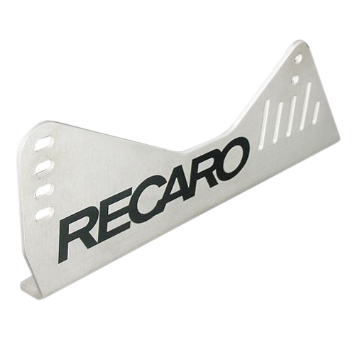

Just get Recaro stuff and be done with it.  Recaro sliders and side brackets will bolt right into the floor of your car as well as the seat.  That's what I used on my old Recaro SPG XL's and it worked perfectly.

I've got some Recaro side-mounts, but I was advised that they'd position the seat high in comparison to the BBI mount.
Of course, if the BBI mount never arrives, it's moot.
Did you get the Recaro double-locking sliders?

However, what I'm struggling with is what this gives me over mounting the Recaro side-mounts on the OEM sliders.
The BBI side mounts do have more mounting holes:
Than the Recaro:
Which as long as the seat doesn't hit the base suggests that ultimate mounting could be lower, but I have to count the thickness of the base plate in the total stack height.

Yes, the Recaro double locking sliders.  While the Recaro side plates have less holes,I didn't have an issue.  I'm also all torso, so tend to sit really high in seats, I was able to get very comfortable with the Recaro side plates.  Plenty of space in the car, even with my helmet on.
