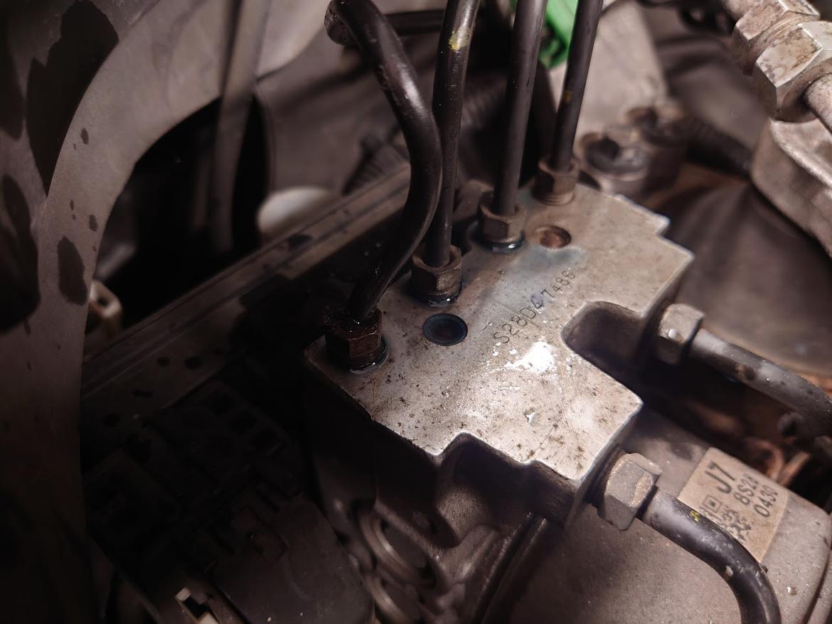

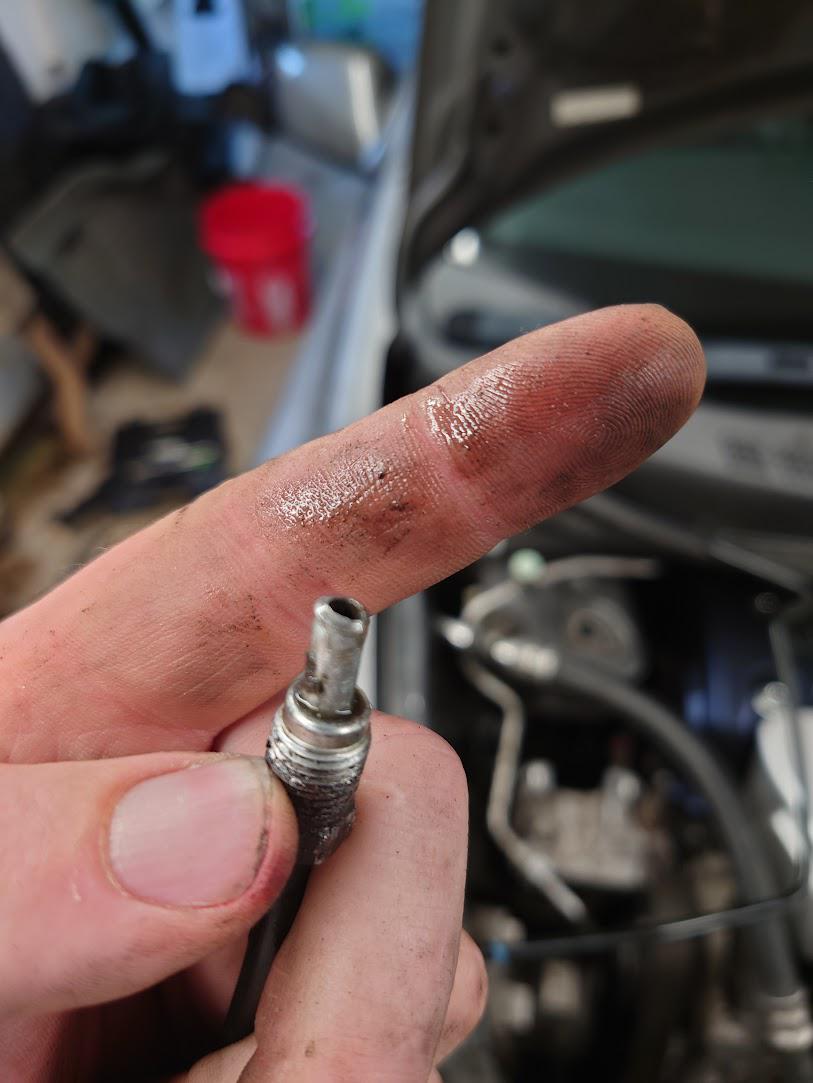

did dig into a bunch of upkeep though. I started by moving the stainless brake lines over from the blue civic, which went about as well as you'd imagine. I ended up ordering new lines, and had to fabricate a new pax front line from the ABS to the wheel because at some point someone did a repair that was just... well look at the pics.

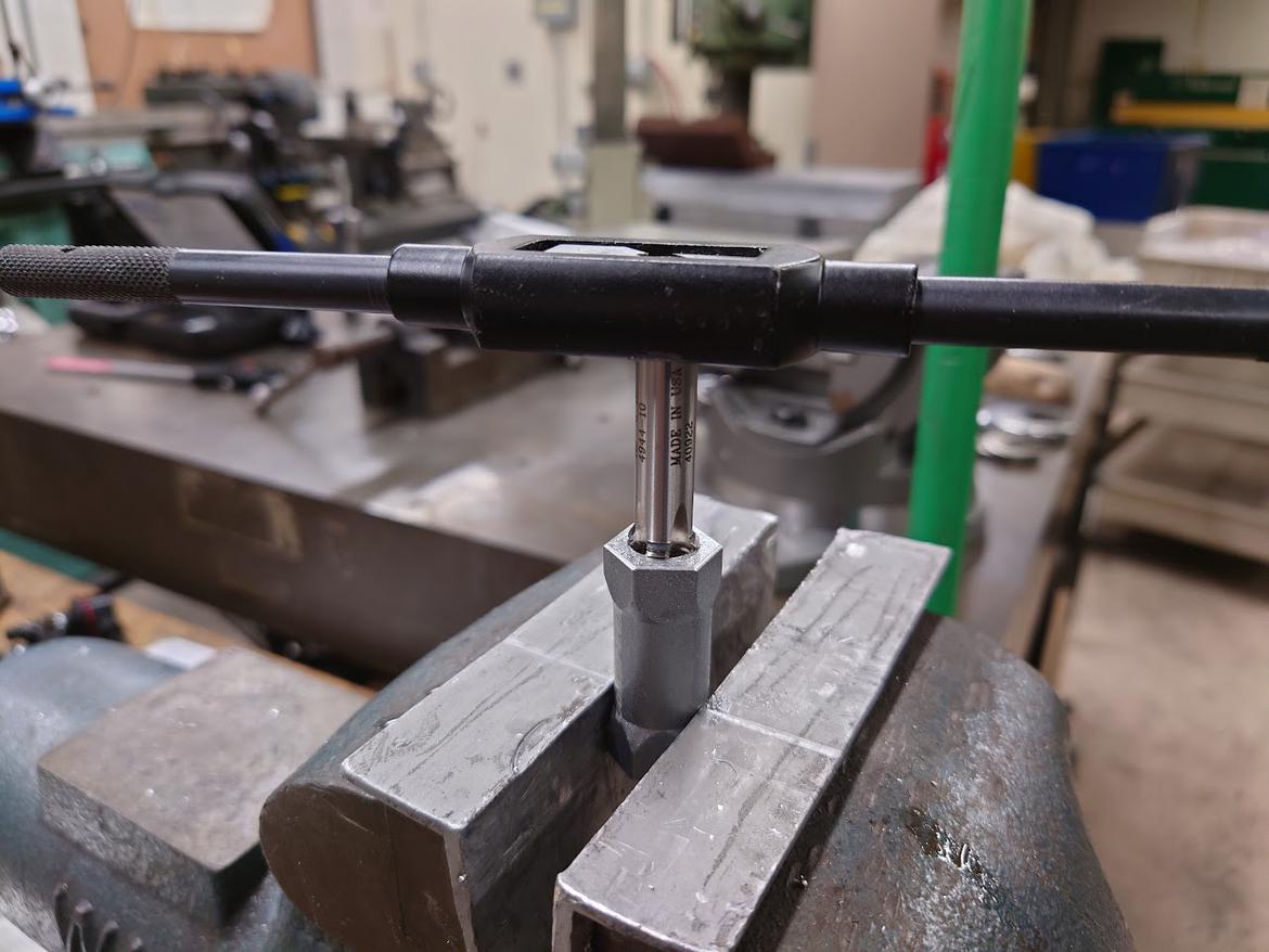

Godspeed, however, makes generic endlinks out of cheese grade aluminum and off the shelf ball joints. so I bought their smallest set and then shortened them 3/4 inches and installed stainless helicoil inserts to help with strength.
