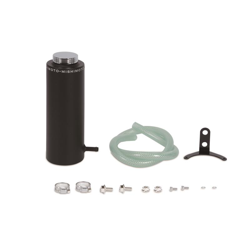

Now for the not so good news. The factory fan shroud is also the overflow tank for the coolant, as well as the windshield washer reservoir. I have a solution for the washer setup and I'll install that later. The coolant overflow is what's giving me a headache at the moment. I purchased a nice Mishimoto overflow tank that looks like this:
I ran into a lack of space problem in the OEM location, so I tried a temporary mounting solution that I think might be the culprit for my current issue. It appears to be oozing coolant out from the top of the new reservoir tank. It's vented at the top, near the lid, and I can see coolant has been forced out through those vent holes and is dripping down into the engine bay. This is what it looks like in the current position:
Here's my (potentially stupid) question: is it leaking because of the fact that it's not straight up and down, or is the reservoir too small? It's at roughly a 45-degree angle right now, because that's all I could make work in that spot. Either that angle is causing the overflow to hit the vents on top too soon, or the tank is too small and can't handle the overflow volume. I'm not sure what's more likely. Maybe it's a combination of both. I just know that it's making a mess under the hood and preventing me from driving the truck anywhere at the moment, which is quite frustrating. There are guys who shove that overflow hose into an empty Snapple bottle without issue, so why the hell is my Mishimoto overflow tank spewing coolant?
I have a whole lot more room on the other side of the radiator, so I could technically buy a longer hose and run it over to that side, with the tank placed at a proper, vertical angle. The extra hose would also expand the fluid capacity, which might help with the overflow issue if the tank is actually too small. Should I try that, maybe? If I keep it on the driver's side, I'm going to need to either cut away a big chunk of the battery tray or or make a big, weird bracket that moves the tank out from the radiator a bit. I'm not entirely sure how to fix this issue at the moment, so input from anyone who's struggled with a similar dilemma would be super helpful!

Today I addressed the overflow issue by moving the new tank to the other side of the radiator. I bought four feet of coolant line and ran it along the top of the radiator, and down to the bottom of the new tank. I installed the tank properly this time (no zip ties!) to the core support, on the passenger side. I have to say it all looks a whole lot better this way.
While everything fell into place pretty easily with the relocation, I took the truck for a drive and discovered that it's still losing a little coolant out the vent holes on top of the new tank. I actually saw it happen this time, though. When I got back home from my test drive, I let it sit and idle in front of the house for a bit while I monitored the temps on my app. I watched a little bit of coolant push itself out of the top of the tank, right as the temp hit about 220, but the fan quickly brought it back down to the low 200s and it never leaked again after that while I was watching. I honestly think that maybe I overfilled the system a little bit when I installed the new tank and it's just burping out the excess and it keeps happening because I'm topping it off before each time I drive it. It gets hot, fluid expands, and it overflows until it cools off. I'm not planning to add any more coolant before I drive it again and I'll watch to see if it still purges. I suspect it might be finished with that process. After driving around for a while and sitting at a few traffic lights, it never got very hot. The electric fan kicked on and brought it back down to the low 200s every time, so it's definitely not overheating.
