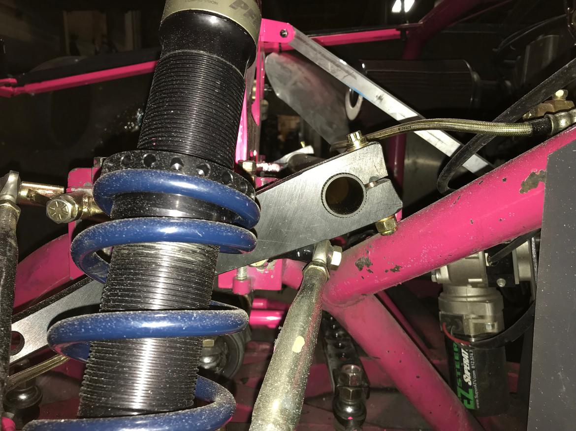

Ok, I messed up. You can see in one of the pics that I use wheel spacers on each side to get the track width I'm after. Since I had the lower control arms off for powdercoating, I decided to just turn the heim joints out 1/4" so I could eliminate the spacers. I had it all back together and everything re-aligned when I realized that maybe, just maybe that 1/4" could throw out all the careful measurements that Ron Sutton had given me. I punched the new numbers into the suspension program, moving UCA, LCA and balljoints out 1/4" and it significantly changed roll center, roll stiffness, camber gain and a few other things. Today I had to take it all back off to remove that 1/4".

What material did you use for your arms?
loosecannon
loosecannon Dork
3/18/18 4:21 p.m.
In reply to bentwrench :
1"x.95" wall DOM tubing. It is not chromoly.

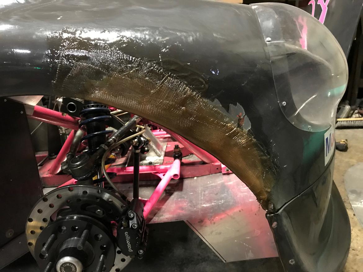

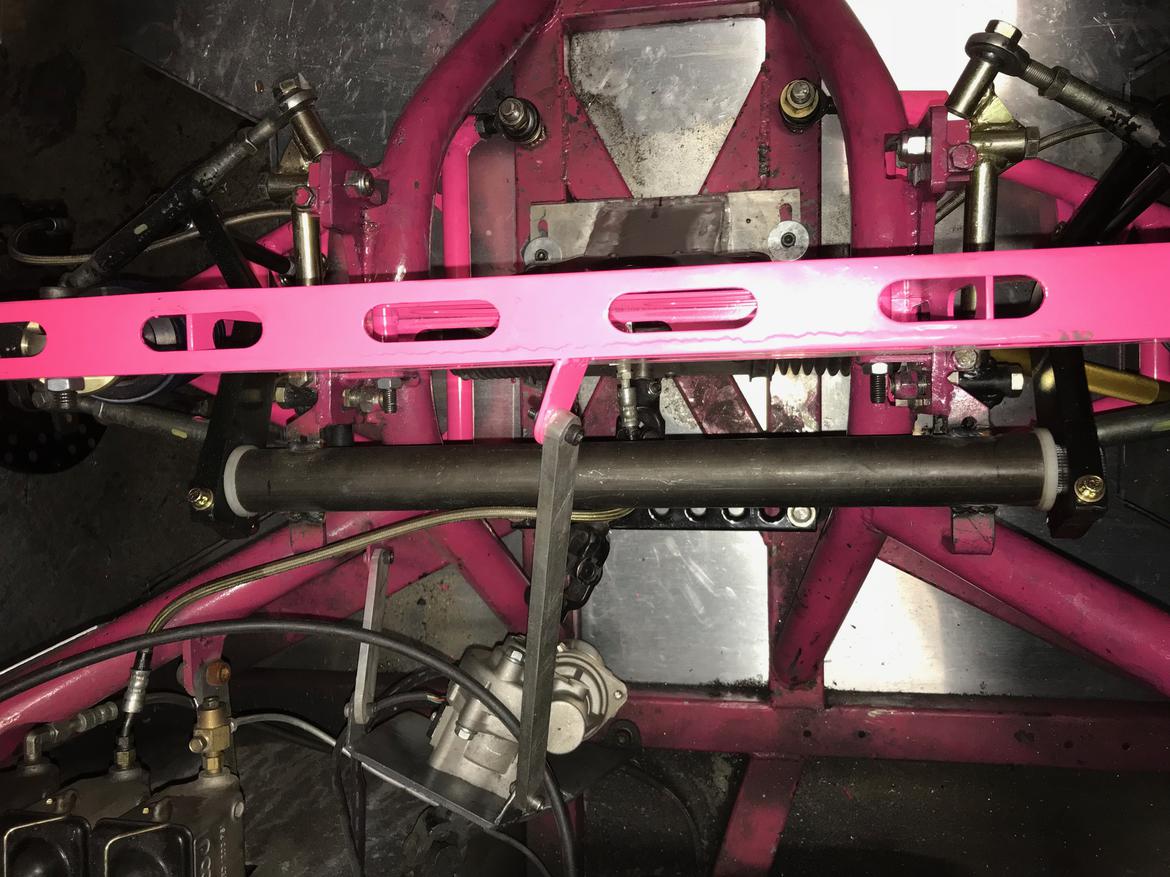

Did a bunch of work on the car today and even got to drive it-video coming. I started repairing the cracked front fenders (Mrs Loosecannon hit a frozen cone at a high velocity) and also installed the front sway bar. Wish the pics were better.
