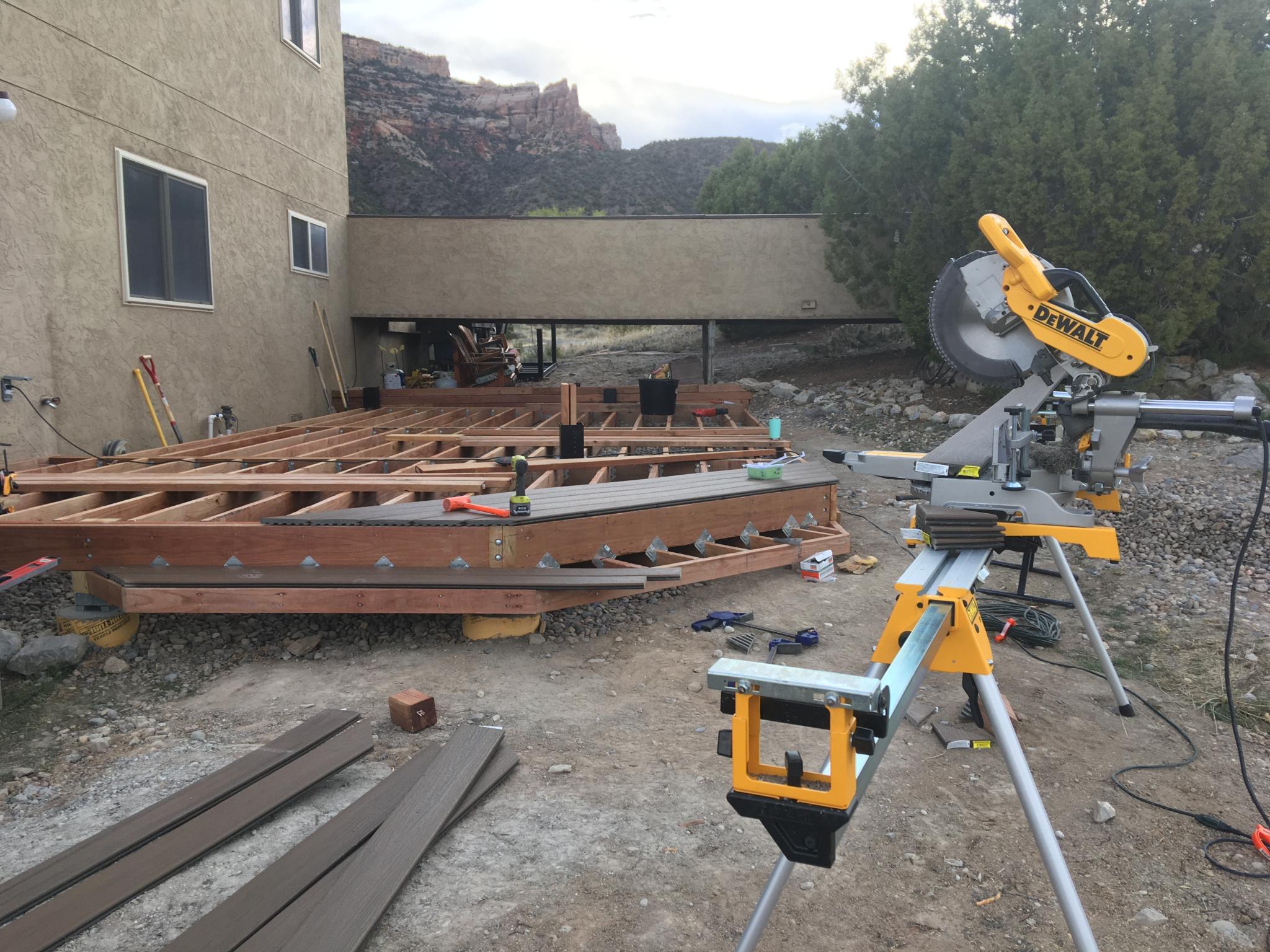

A little late to the party but our deck was officially finished last Friday. One guy built it in just over two weeks with breaks for weather.

Having done mine by myself, those beams look like a bear.
3/8/21 6:49 p.m.
That dude is one seriously hard worker.

In reply to Keith Tanner :
No kidding!  The builder we hired said a crew would be coming out. Nope, one guy. He worked in cold and snow too. If it was warm weather probably would have been a week and a half. Great craftsmanship as well.
