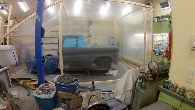

Body is sanded, needs a couple coats of epoxy, then Slick Sand.  I don't want to spray this outside, so.....

Did a thorough wipe down today. Primer tomorrow.
Furnace filters on the top left feed air in, to row of furnace filters bottom right, which go into a "channel" up to the big ass barn fan in the peak of the ceiling.  Nice negative pressure with the fan on the lowest setting.

Any chance that you make it to the 2023 Qualicum Beach Cruise and Show? Also do you need to adjust the paint for the heat?
SkinnyG (Forum Supporter)
SkinnyG (Forum Supporter) PowerDork
7/26/22 12:36 p.m.
The hope is to have it completed by the end of next summer.  Not sure -I- will be ready to embark on such a long trim in an unproven entity.
My shop never gets more than about 24°C at the hottest.  I haven't been adjusting for heat.  Maybe I should....

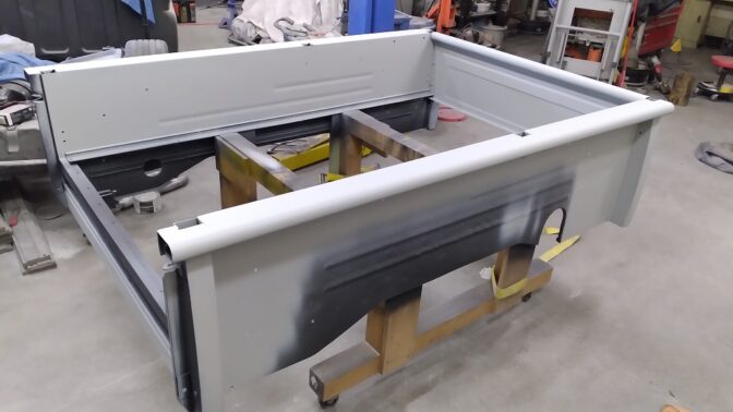

Optimus Priming:
Wow.  These were white two coats of primer ago.

In reply to SkinnyG (Forum Supporter) :
nice work, Optimus!
NOHOME
NOHOME MegaDork
7/26/22 6:25 p.m.
I want to quote a line from Archer.
That looks AWESOME and you can tell even from where I am sitting that the tin is flat and smooth.
