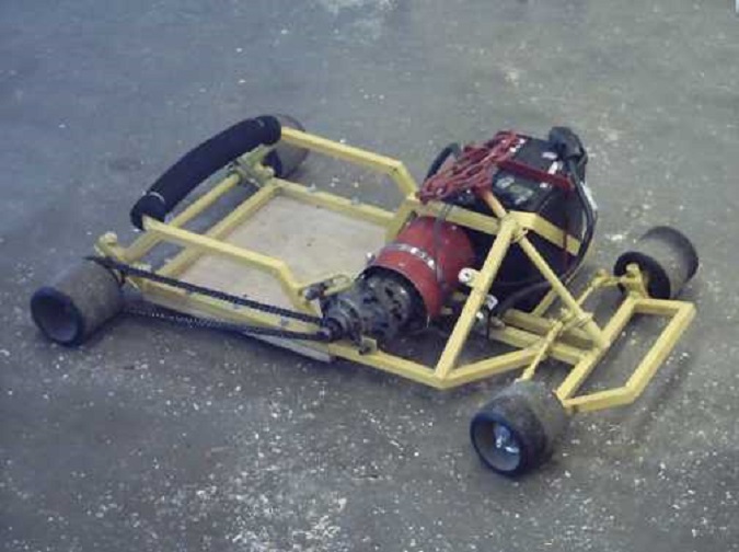

And Midget Karts, powered by modified Toyota starter motors:
