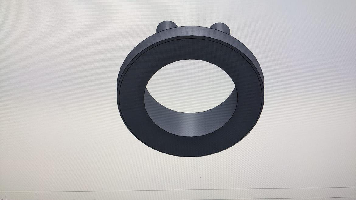

The lay out idea on the FOX
The our IT guy, who is Scottish by birth, gave me an idea after talking to him about perspex rings and vacuum molding adapter brackets. He has a 3D printer setup in his office, where he will print me an adapter ring that will be a press fit into the grill, with the brackets on the back for the spotlights to mount to
So tomorrow I will attack my car's grill with the vernier, and draw something for him with the measurements and then let's se what he can cook up

During 10h00 tea time, took the calipers out to the car, measured the grill two or three times, and wrote down my measurements.
Then during lunch, free handed the 2D design and gave it to the Scott
Front View
Rear view, with the mounting points drawn on as well as the screw hole sizes. He can use his discretion with that, since I handed him one light with the drawings.
Side viewe, with mounting points drawn as a suggestion

The Scott just send me some renderings
