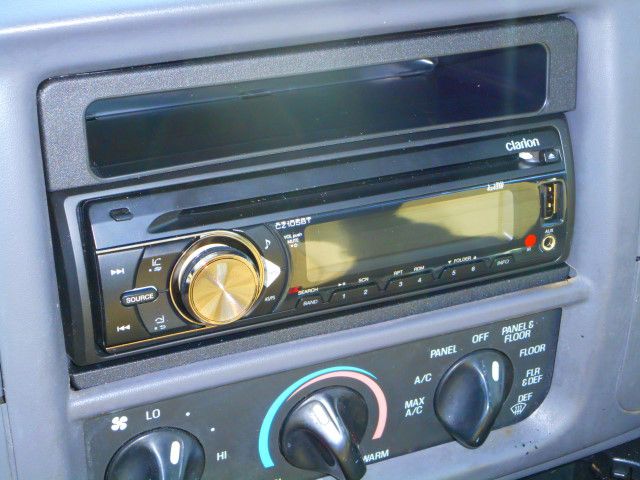

Before I discovered the engine unpleasantness, I ordered a new radio. I opted for a Clarion CZ105BT deck with aux/USB in and iPod control. Since the factory radio is double-DIN and this is single-DIN, the installation kit also provides a modest storage cubby. Lack of storage was on my list of things to address anyway.

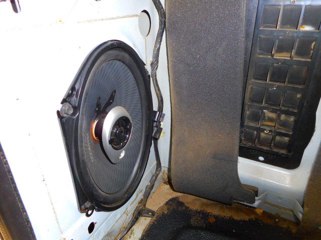

So I continue to work on other things, too. This truck came with door speakers only, but even the Work Series is wired for optional rear speakers. I added a pair of speakers to my junkyard list. I planned on just finding a pair of factory speakers, but as I was removing another part from an Expedition, a missing door speaker grille revealed a Kenwood logo. All speakers are the same price at the junkyard regardless of quality, so I grabbed not just two of them, but all four. At $5.58 each, why not?
Turns out they're Kenwood KFC-C6893PS speakers--an older, discontinued model, and nothing super fancy or expensive, but better than the factory speakers, I'm sure. Here's one next to the stock version:
They don't use the same connectors as the factory speakers, so I ordered some cheap adapters. Installing the fronts isn't really worth a picture. After removing the plastic trim from the rear of the cab, you'll see a big sticky piece of soft rubber covering the hole for the speaker:
Remove it and you'll see the connector plugged into a dummy plug to keep it from rattling around.
Hook up the adapter, plug it in, and four screws later, you're done.
