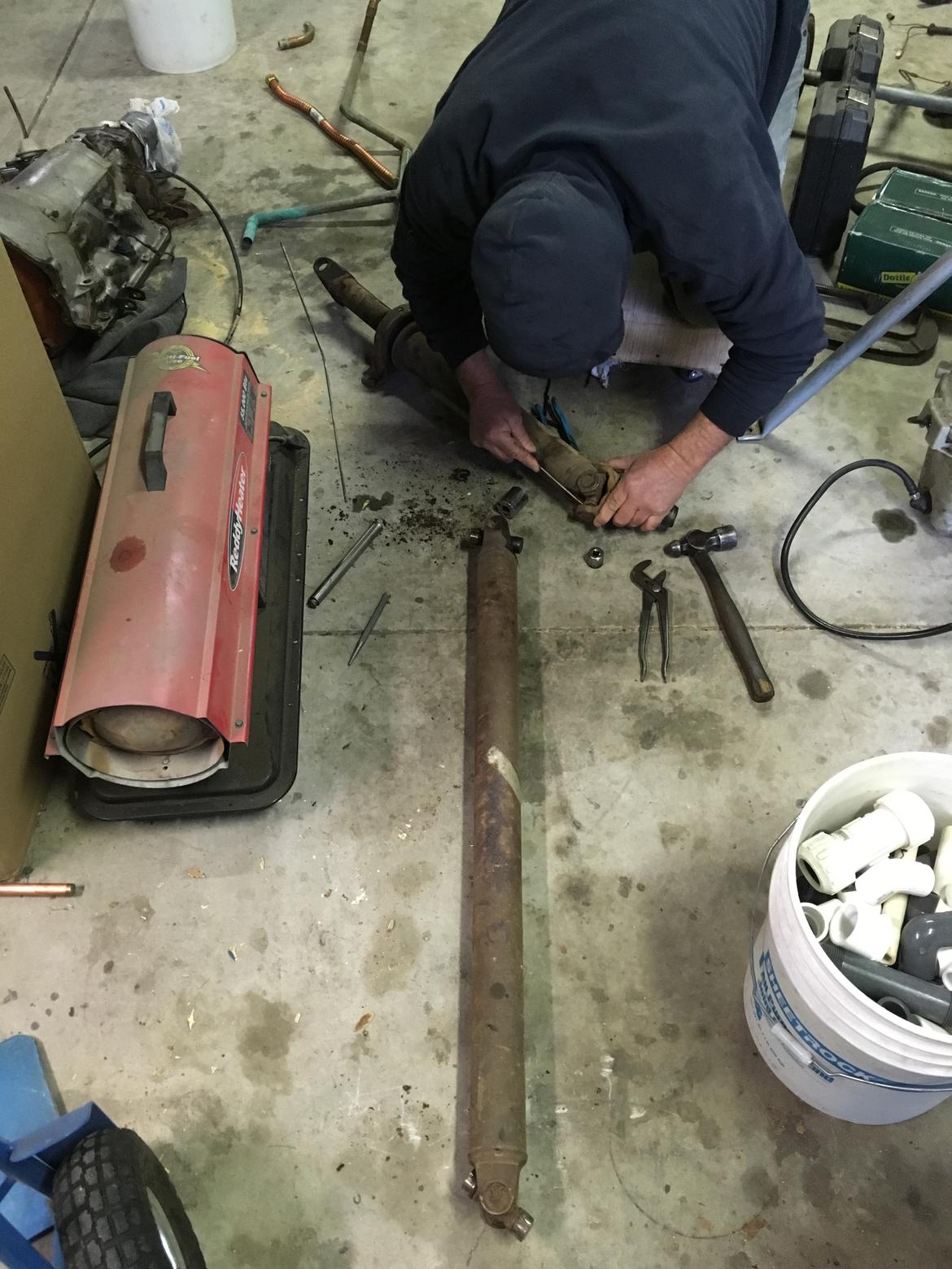

Budget tip: if you are swapping engines and you don’t want to put a new driveshaft into the budget you can take the two piece shaft from the donor van and make it a one piece with a little u-joint mix-and-match.
(We work on the floor because there is a cj2 body taking up the whole bench).
The real genius of the driveline hack (hehehe) is that you end up with a short shaft and are forced to install the engine and trans further back than the original unit, improving your weight distribution and (hopefully) handling characteristics. Anyone who says a 79 thunderbird can’t handle is probably right but we’re going to try anyway.
