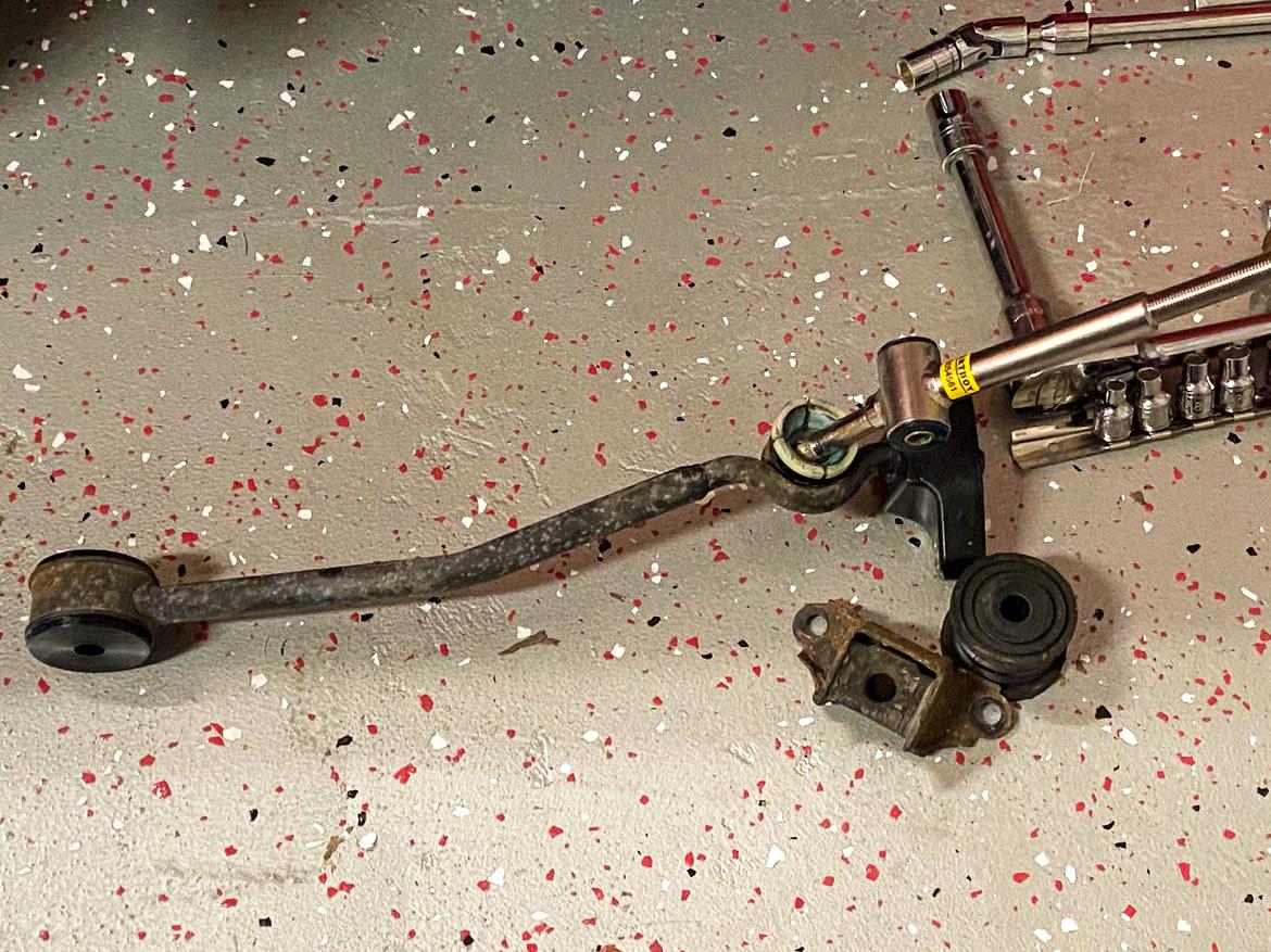

Well the Subaru shifter is all the way out.  The new bushings and shift handle are ready to go back in.  That will be tomorrow's project.  So I've gotten 1.5 to 2 hrs so far this week so we are on track!  I need to get an egg timer or something. I also need a new headlamp for working in the dark.  My old one has the AA battery pack on the back so under the car I keep knocking it off.

Well I tried getting the shifter back in Thursday only to be stymied by cold and the new rear bushing alignment.  The holes were off just a tiny bit or cold made the poly shrink just enough I couldn't get the bolts started.  I spent Friday and Saturday feeling terrible sick.  I'm probably 80% today, but with a pry bar and patience it's all back together.  With the new bushings, shorter shifter and way shorter knob it feels much sportier and each gear is easier to find.  The granny's Impreza shifting feel is way reduced.

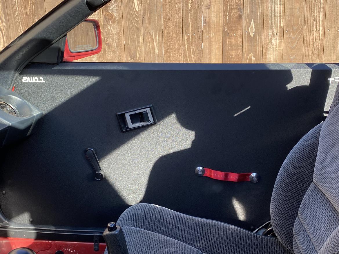

Got the 2nd MR2 door converted to manual windows and installed the T3 door panel.  The interior looks very racy now.  Next I need to dry ice the sound deadner, install the harness bar and then a racing harness.  Then I can detail the interior and the inside will be complete for the challenge.  Then I can fix the bad headlight motor and repair the battery tray.  Then it will be time to find an autoX and see how it does.  The MR2 starts and drives with no complaints every time.  That is a huge plus.  Nothing will change power wise except some giggle gas for the drag race.
Do I leave the passenger seat and belt in for autoX passengers, or remove it which I will for the drag racing anyway?

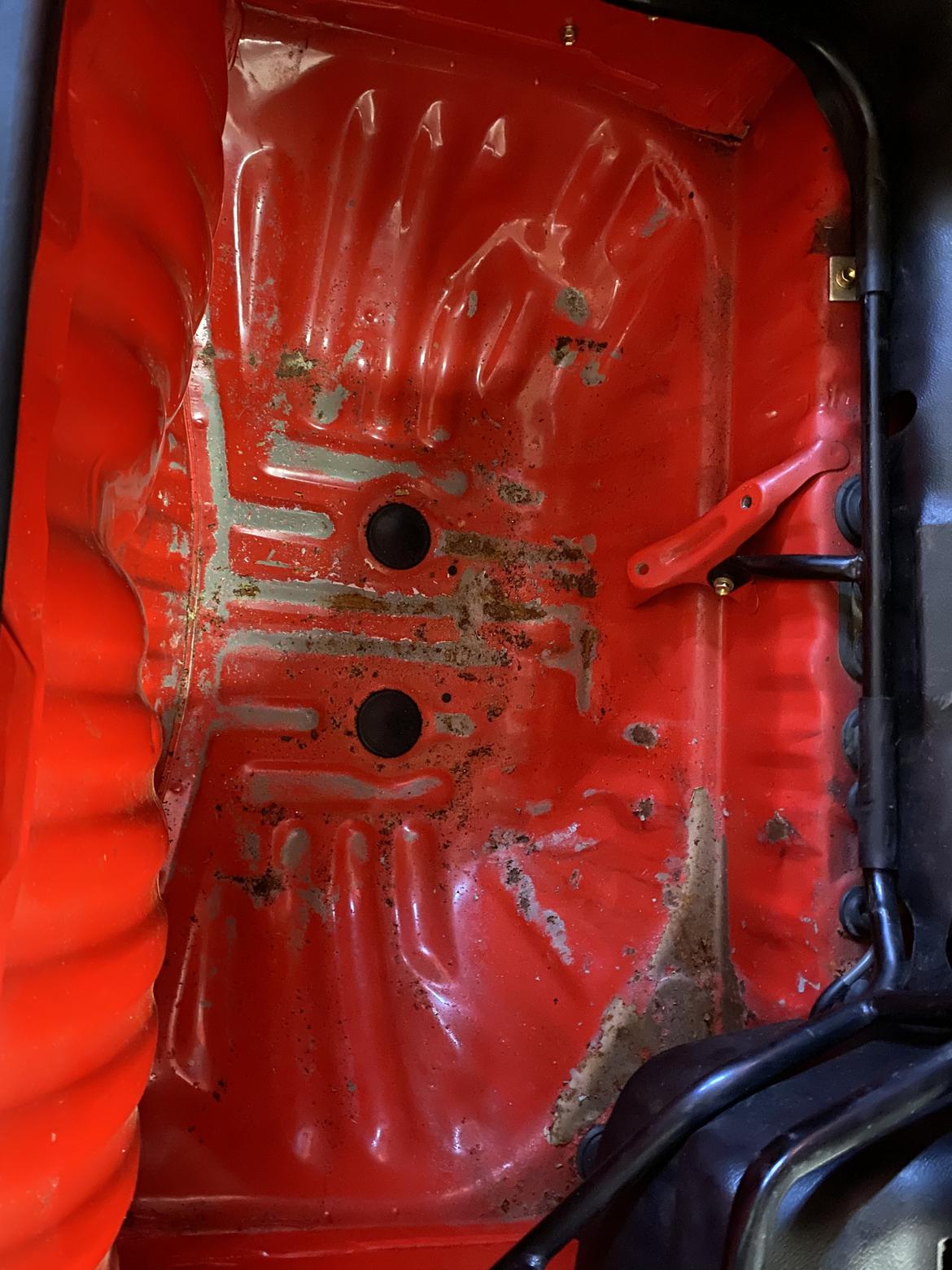

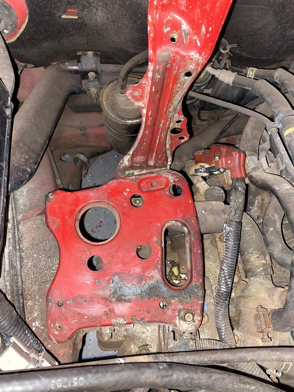

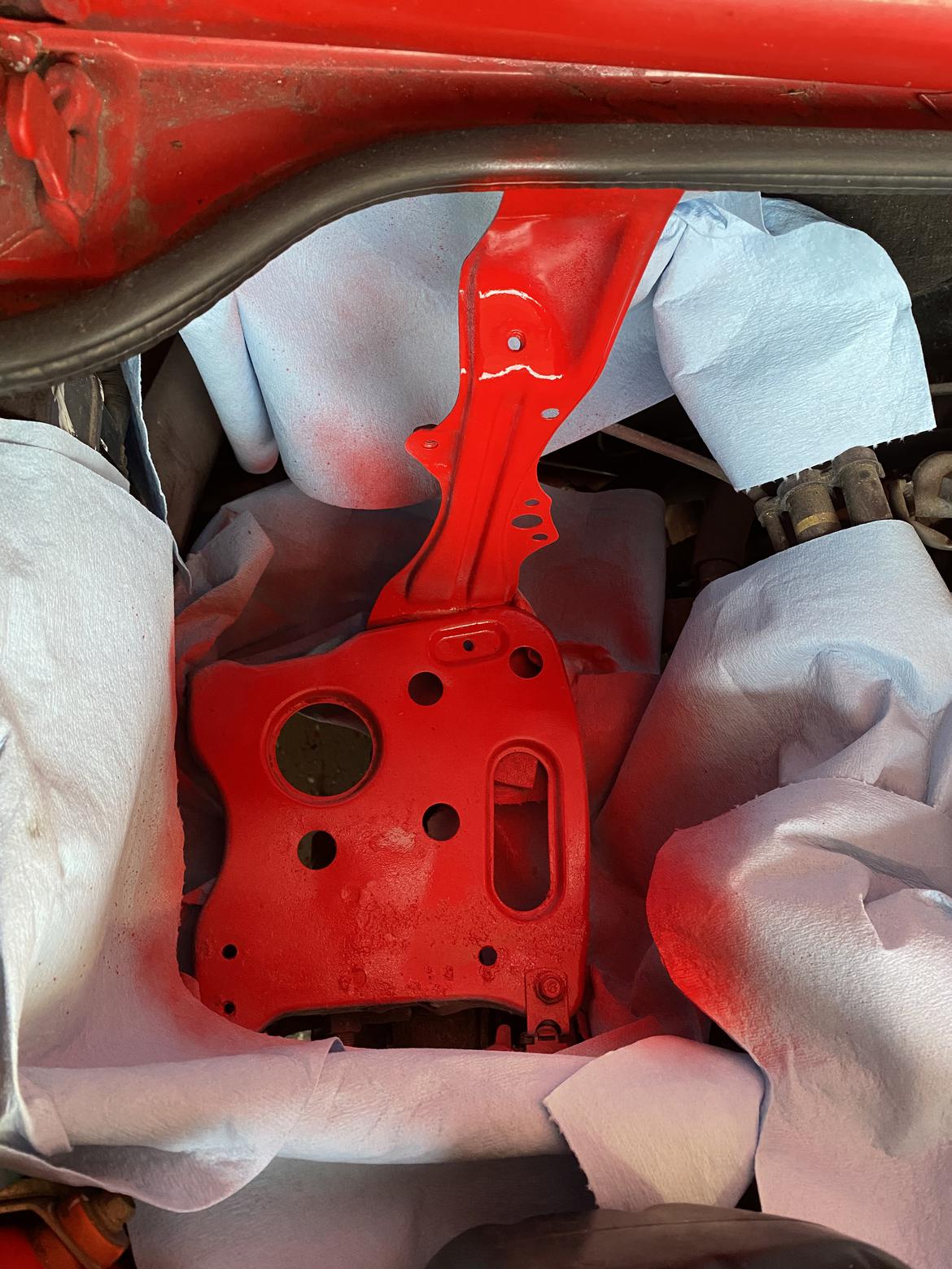

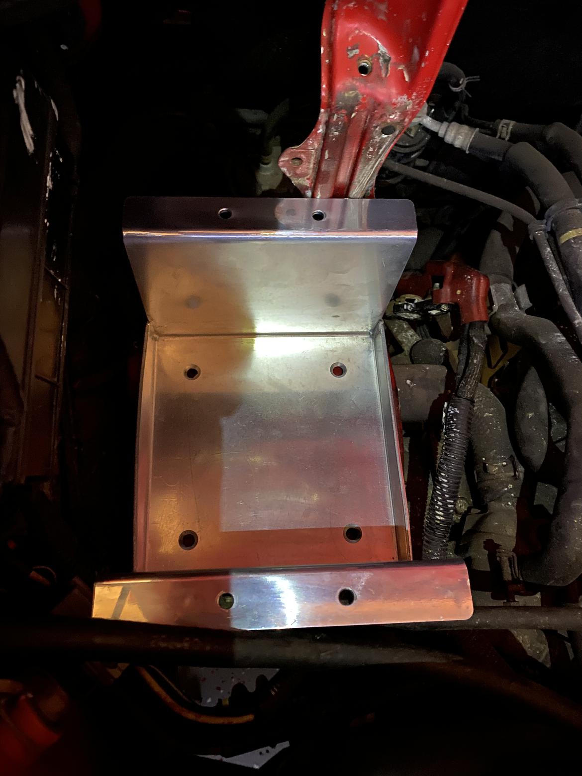

Still trying to make auto progress on work days too.  I'm trying to make the battery tray area of the MR2 less gross.  I will have to work on the frunk too.  When you know your challenge car will be MR2 slow in the drag race, you will need those concourse points.

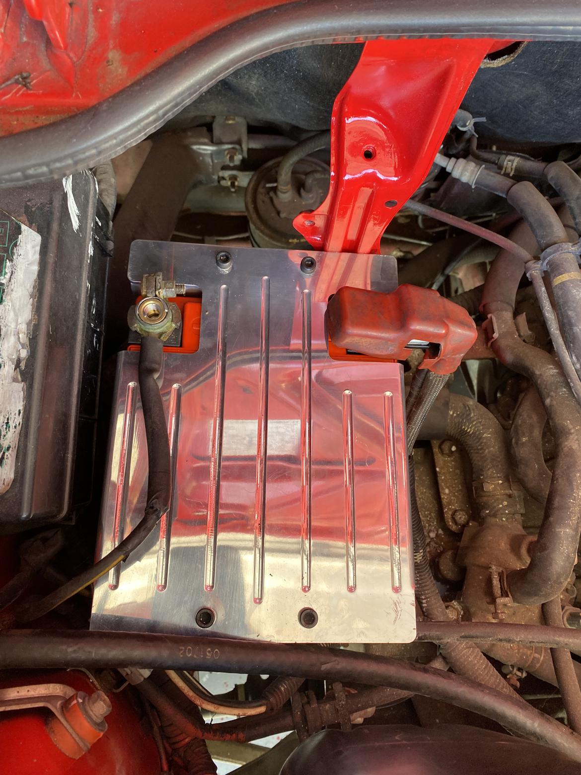

Lots of fussing but the battery box in the MR2 is rigidly mounted.  It has bolts through the bottom and I put one on the side going forward through the vertical Toyota mount.  I also had fun with the cable ends as they were about 0.1 mm bigger than the posts.  They just would not tighten.  I got some lead terminal expanders and they were too big.  I ended up taking snips to them and making small spacers.  The terminals are tight now.  I'm confident this will now pass tech, whereas before it would not.  I can now see how the car handles without worrying if the bungee will allow the battery to short out somewhere too.

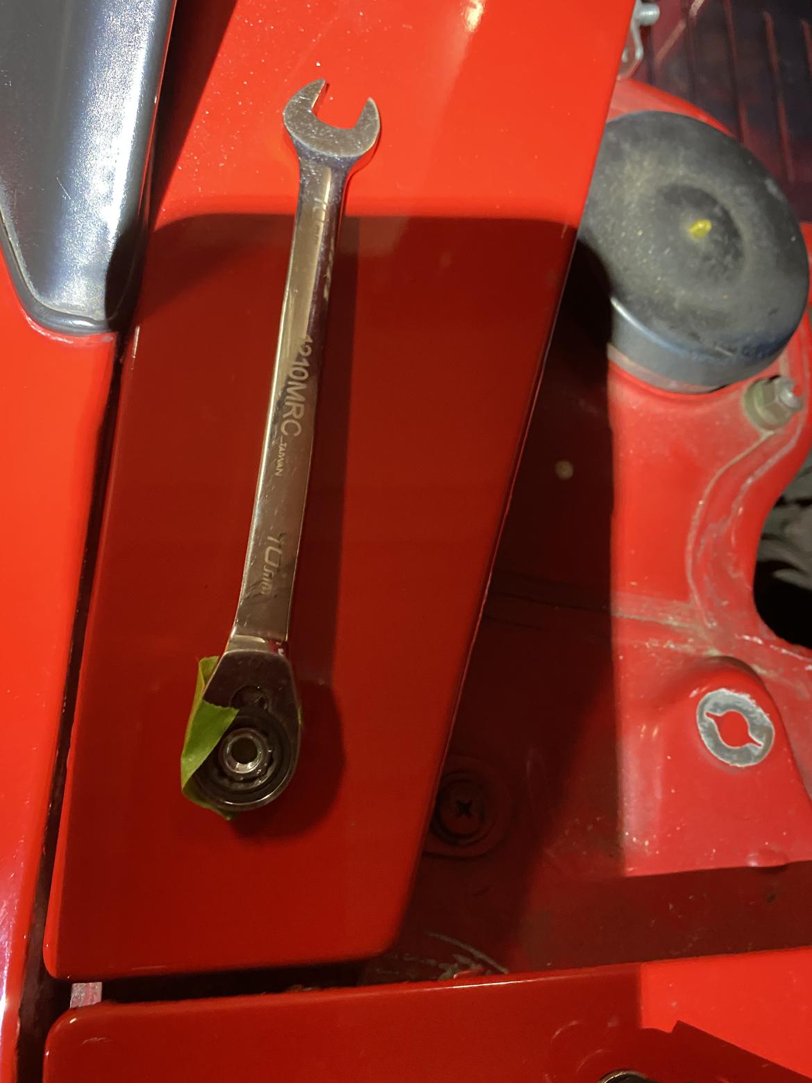

Also here is a trick I used for the lock nuts since the battery box is on top of the trans / engine mount.  These locknuts were a pain to get to.

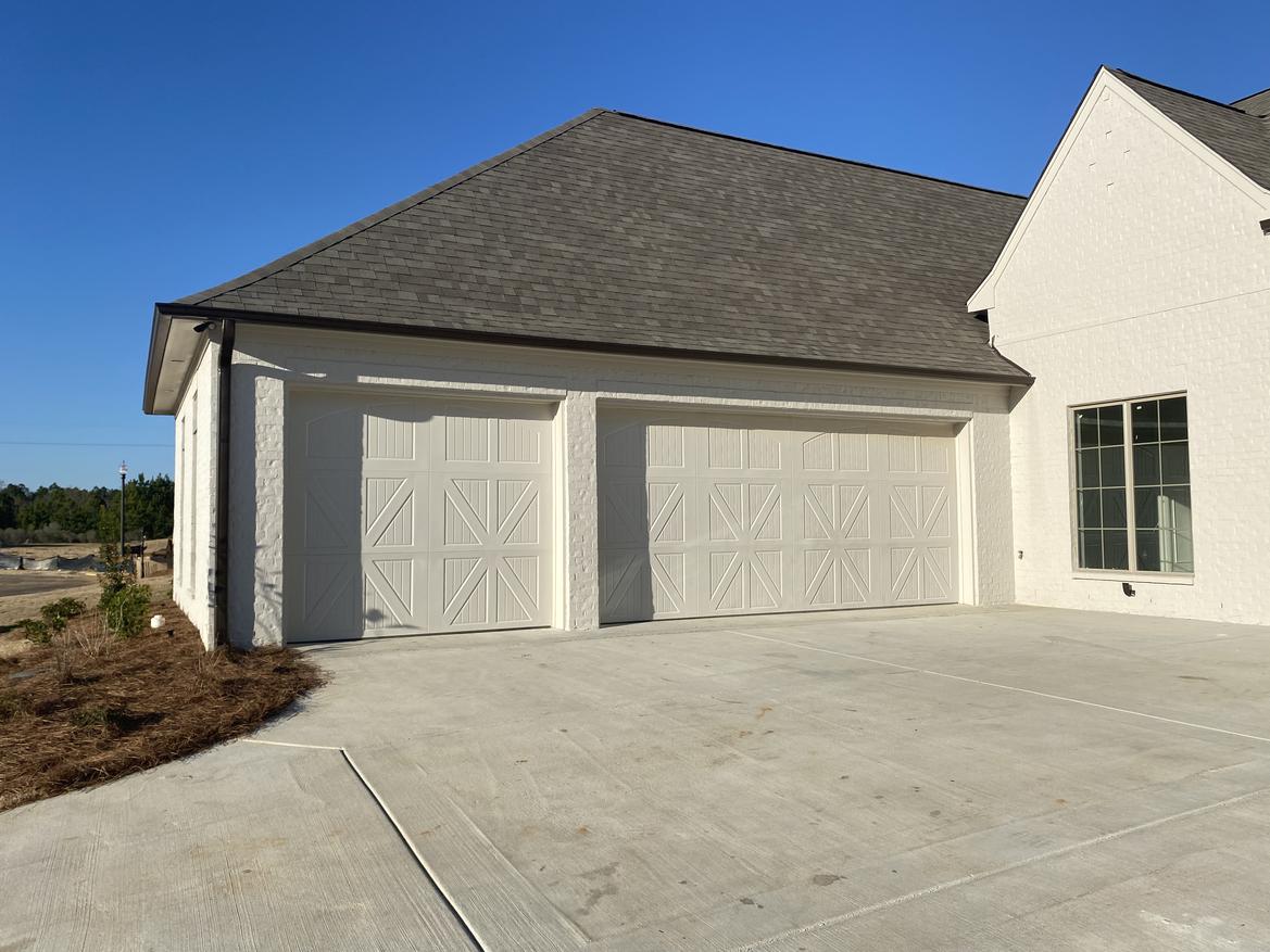

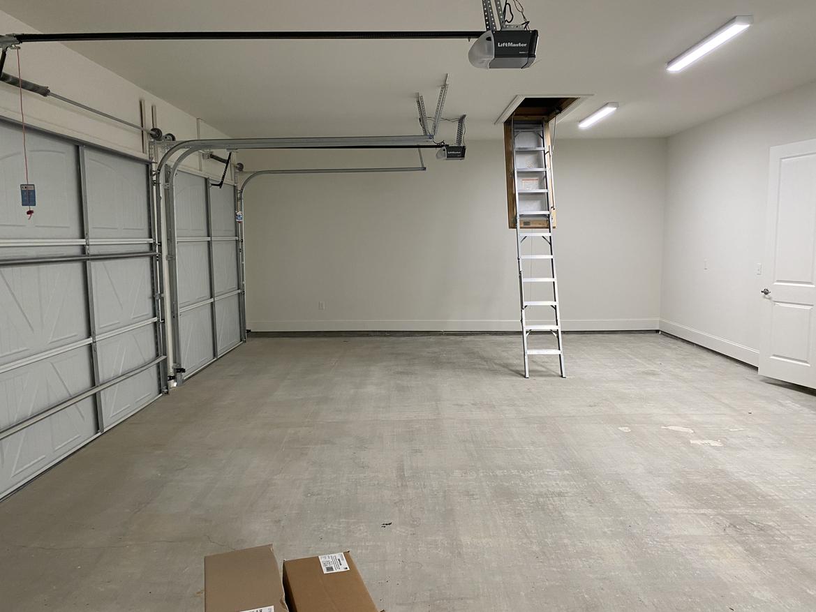

Okay went and checked out the new house thoroughly and took photos and measurements.  New garage is big.  Smart move will be to reorganize the entire car fleet though including the daily drivers.  This thread may end up having zero Porsches.  Anyone have a strong desire to own a speed yellow 986 S?  I spend most of my time working on the Subaru and Camaro anyway and that's honestly enough project cars, especially when considering the plans I have for both of them.  I'm having more fun rallycrossing than any other automotive thing I have ever done too.  Going full rally car is becoming a bigger priority.
