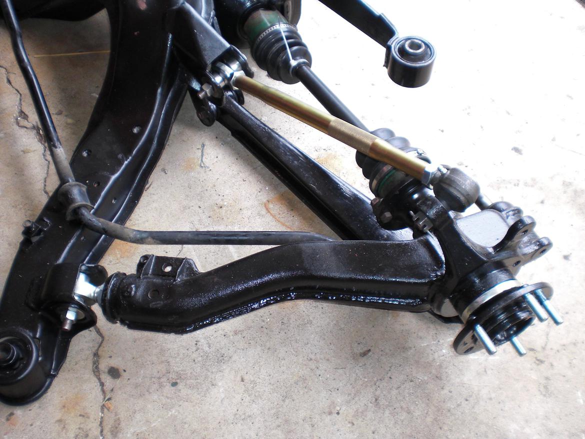

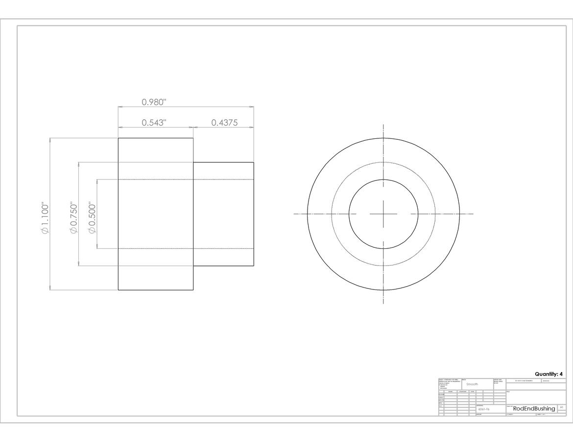

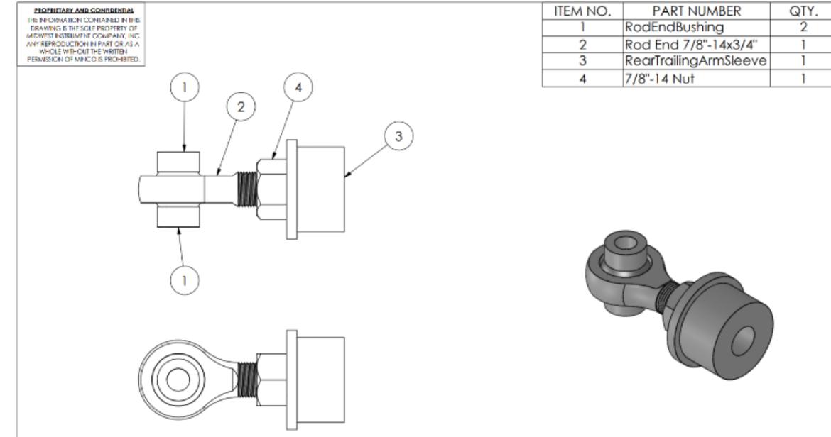

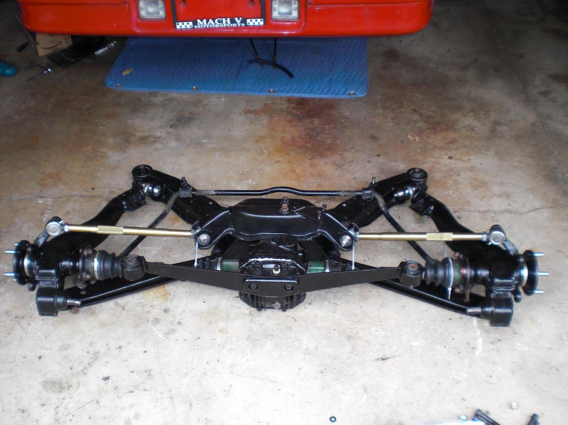

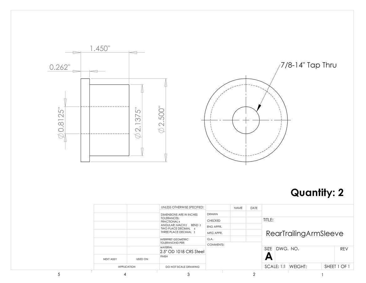

I made my own rear active toe kit, I have a CAD drawing somewhere I can send and I'll try to find out what heim joints I used.

Found em. Feel free to use the drawing. You'll need a big boy lathe to make this, and then press and weld into place. The old bushing needs to be burned and cut out.
Also worth noting, the stock rear trailing arm bolts are eccentric and allow adjusting toe a bit.  You could re-use the stock eccentric bolts with the heim joint, as its way easier to adjust via the eccentric bolts as opposed to disconnecting the heim joint.  I believe the heim joint I used allows the stock eccentric bolts to fit.
Here is an install guide:
https://www.dsmtuners.com/threads/1g-awd-active-rear-toe-eliminator-kit-install-heim-joint.405836/
I also made some upper control arms using swage tube and heim joints, there's directions on DSMTuners on how to make these.  I will likely put the stock piece back on as I'm a bit worried about durability with use in RallyCross.
