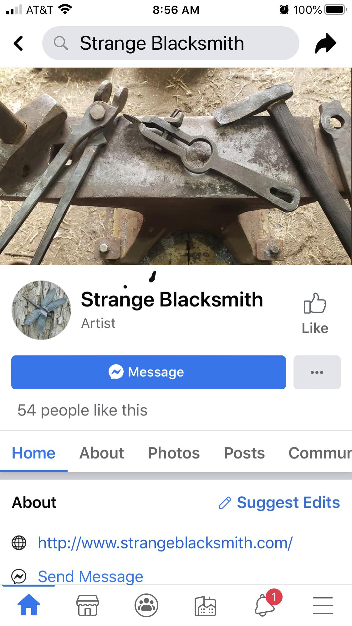

5/5/20 8:56 a.m.
In reply to Crackers :
Is this you?
Crackers
Crackers Dork
5/5/20 9:01 a.m.
Yup, that would be me.
