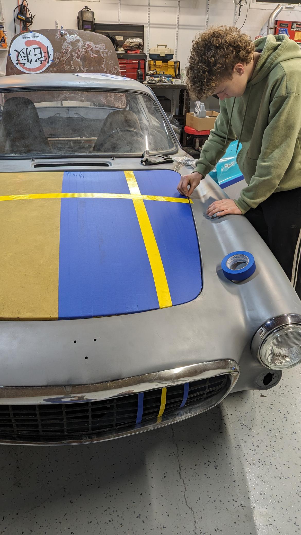

I also dorked out with tape this weekend! I laid down a bunch of blue painter's tape to represent the blue that I want to do for my livery. It will be darker and glossier when I do it in vinyl, obviously. I then laid down some yellow duct tape for the accent colors. Pro tip: cover the areas you want to do in duct tape with painters tape first so that it releases cleanly when you're done.
This is meh, but it was fun to mess around with it. I'll need a real design in the back. The random decals on the tape were just some I had lying around just to see if it would look different with stickers.
This one below is my favorite. The little dip of silver at the back is fun (and more true to the concept), plus the later iterations have too much yellow... or just... yellow in the wrong places.

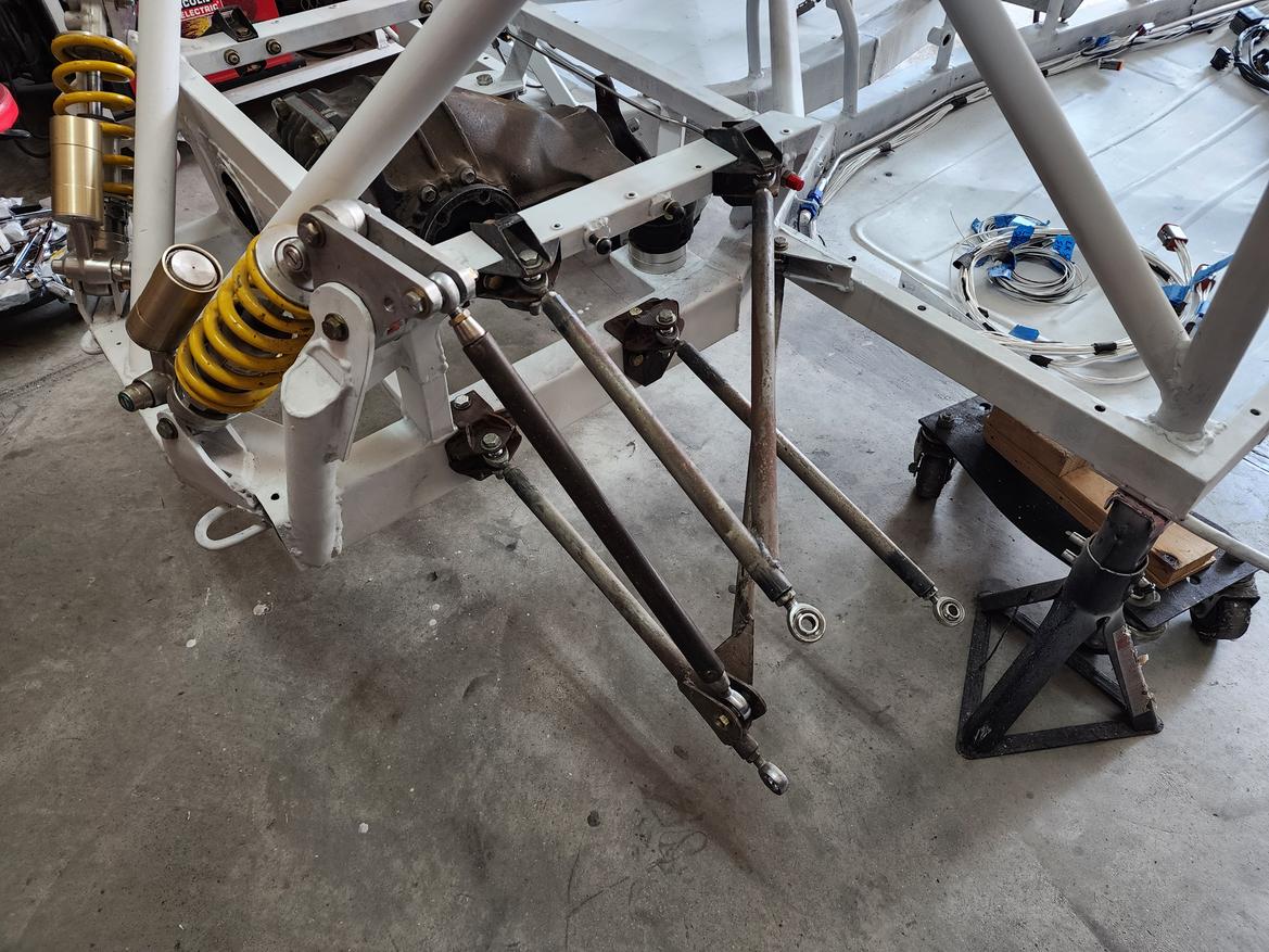

Roll bar tubing is overkill by 300%. Look at Steve Stafford's Spitfire Mk8 project for arm inspiration. 3/4"x .060 is plenty strong.

I whole heartedly approve of the painters tape applicationwink:
stafford1500
stafford1500 Dork
4/9/25 12:03 p.m.
Yes, my car at 2300 lbs is using 0.75diamx0.063wall tubing on the upper and lower a arms.
stafford1500
stafford1500 Dork
4/9/25 12:04 p.m.
1.00diamx0.090wall will be more than enough for your uppers if you gonthat route.

The biggest challenge will be the pins that the ball joints lock into the spindle with. Kind of clever of Audi... they have the two ball joints plugging into the top of the spindle with a groove machined around them. Once in the spindle, you run a bolt through the whole thing, and that holds them in place by interfacing with the groove. If I had a lathe, I could pretty easily machine one of these pins. As it stands, I think the easiest way around that would be to just buy a rebuild kit for the kit that Luke linked to. That would get me most of the other parts I need anyway. It's unfortunate that a couple of adjustable uppers are $500+ when an entire front control arm refresh kit (like... 8 arms with bushings and ball joints) is only $150.

Is that the car with the Swedish flag on the hood? It was your tape handy-work that inspired me to do my tape handy-work!
