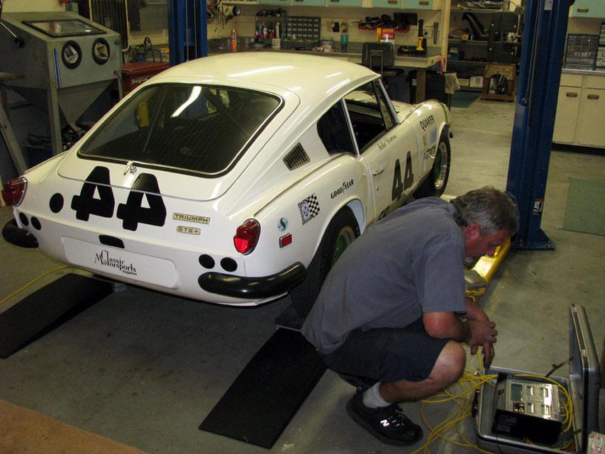

Now that the GT6+ would go around the block without issues, it was time to focus on the handling. The original race suspension on this particular Triumph is very trick and very adjustable. Group 44 Inc. got rid of the stock Triumph A-arm bushings and replaced them with concentric bronze pieces. We were able to get 4 to 5 degrees of negative camber just by rotating the bushings.
Obviously this was too much, so we settled on a baseline of about 1.5 degrees of negative camber up front and about 2.5 degrees of negative camber at the rear. Toe was set near zero at the rear and about 1/8-inch total at the front. We made further adjustments once we got to the track and took some tire temps. The total weight of the car was 1805 pounds while featuring all of its original glass.
